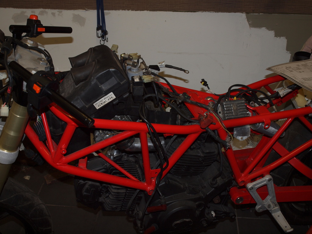

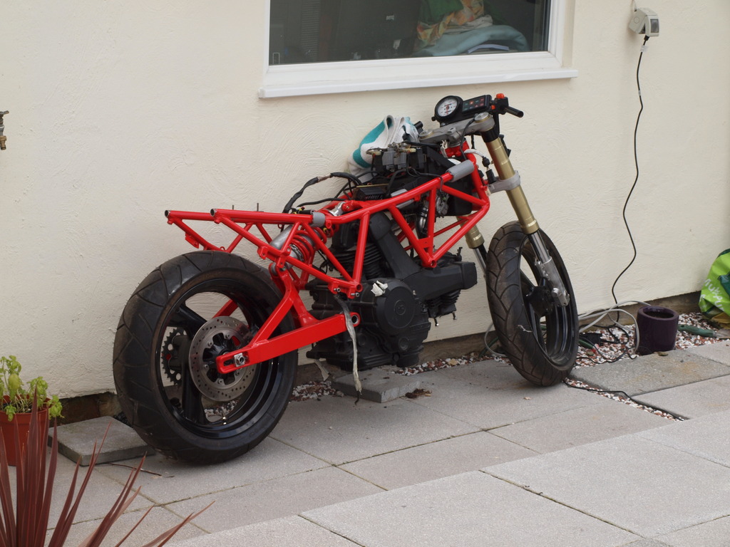

    Just spent a couple of days putting the bike together to get a look at what it will look like
    Started by getting the engine on the blocks and frame attached
    Attached to the scaffold bar that is fitted across the office/workshop
    Not sure if the upside down forks look strange.........hmmm
    Maybe it's the gold that looks wrong
    Will be looking for a single 7" headlight soon so a bracket is in order
    Will have to make a start on the wiring loom as well
    Using a monster loom, don't know what to do with it but I am sure I can work it out!!
    All the bolts and stuff have been cleaned up before deciding the colour to use
    Held up by one strap

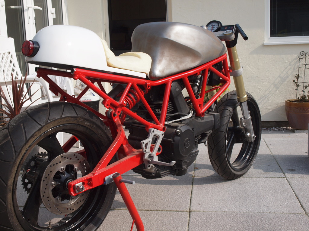

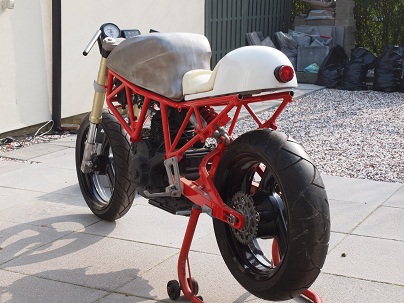

  13. Update August 2012
    After a bit of a lay off have started on the monster wiring loom
    Now know which bits connect where so the next bit will be to cannibalise the 750ss loom for the connectors
    Converting the front to twin disc set up, more for the looks than performance
    Got a pair of discs from an ST2 and a caliper from a Cagiva River plus a reservoir from a 900ss
    Headlamp is painted black and I have made a bracket from tubing to match the frame
    Have shaved down the original seat foam to form a new one to fit the tail unit
    A new tail unit has been build, slightly thinner to sit on top of the frame rather than hang over it
    I have found a light for it
    Monster clocks fitted to temporary bracket
    More pictures in next thread
