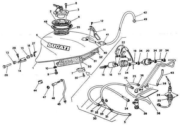

  11. I often spray into inlets to confirm fuel starve, done it without problems all my life, but i was trying to confirm where connected, because it could confirm that there is no thimble filter problem at last junction.
    I think it's item 32 on here (can't find table to go with it) and shows fitted at "Y" junction here.

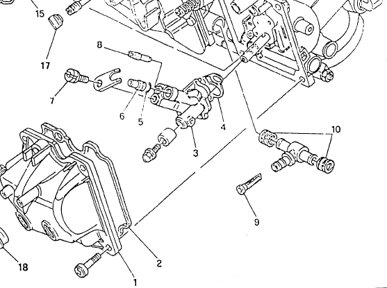

    Do mean the fuel filter at the carbs in the tee-piece? (item9 below).

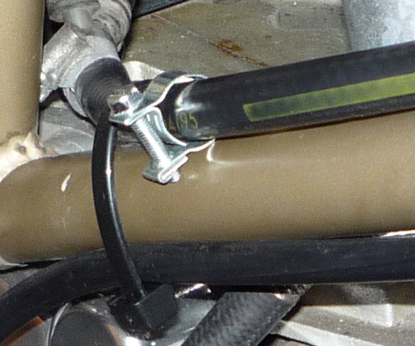

    the pump pitch sounds fine. I have tried to get to the fuel hose where it attaches to the carbs, via an articulating t fitting, no joy, I have lifted the air box up enough to see where the hose goes on to the t fitting, and i can articulate it, but the spring hose clamp that is holding the fuel hose in , is in such a way that I can't get to any tool to open it, which means I think I will have to take everything out, air box etc to try and get the hose off

    With regard to the hose clip, I recall finding a screwdrive 'jubilee' type clip at the Y junction connector, so I disconnected that joint and pulled the hose forward so I could lever the one at the tee-connector off with a long thin screwdriver.....it actually broke if I recall correctly.
    I then replaced both those clips with these.....what you can just about see here is the disconnected carb end of a new hose, with a new clip.
    The jubilee clip at the Y end can be seen as well, plus part of the Y connector....it is an awkward photo, but one I had with the new clip.

  17. well done Al - you found it - "item 9"

  19. I have just found Item 32..........They call it a 'jet' but it looks a though it just has a small-ish hole in it.........I suppose it could get blocked though.
    I don't even recall seeing one on my 750 :rolleyes:
