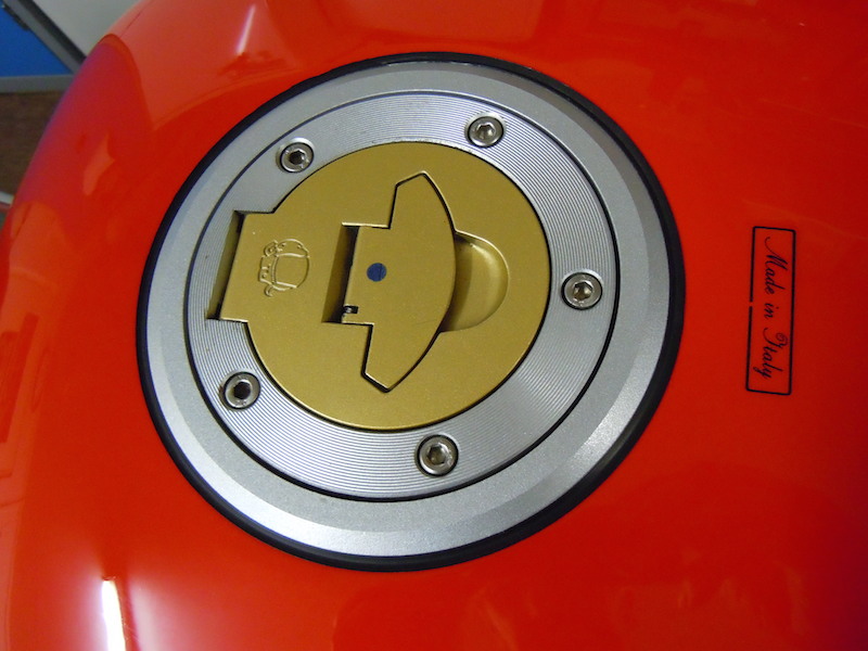

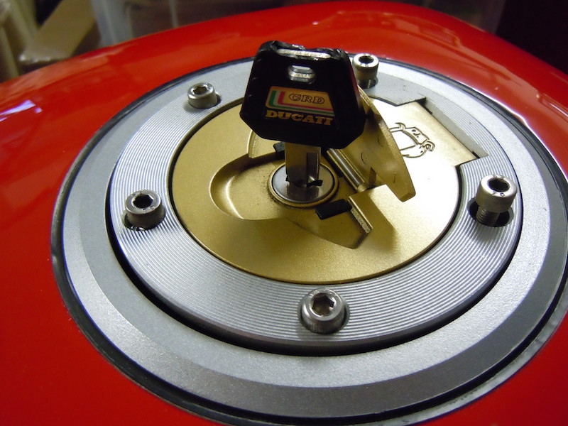

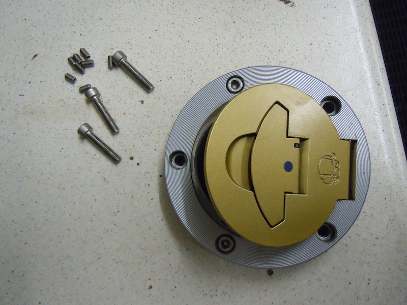

  9. Well, boredom got the better of me again today & I thought it about time I replaced the fuel filter in my 750SS tank. I've had the bike from new & I'm embarrased to say I've never replaced it before.

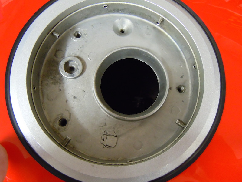

    Removed the cap head screws securing the filler cap in place, realised you didn't need to remove the two screws at the "10 to" & "10 past" positions, (they are only very short & it's only the other three that secure the filler cap in place). Sure I had read about these screws too, after I'd removed them.

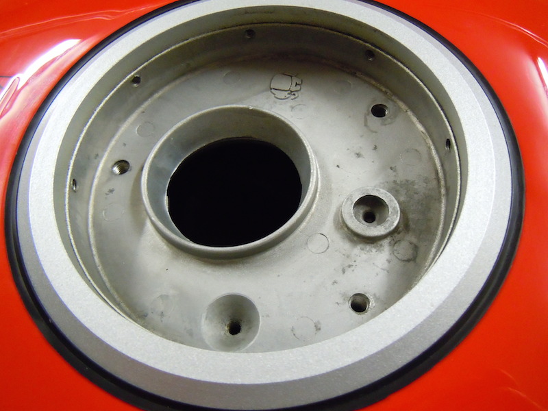

    This revealed the eight grub screws securing the filler neck in place.

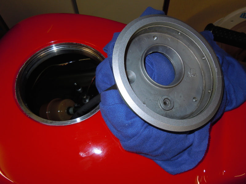

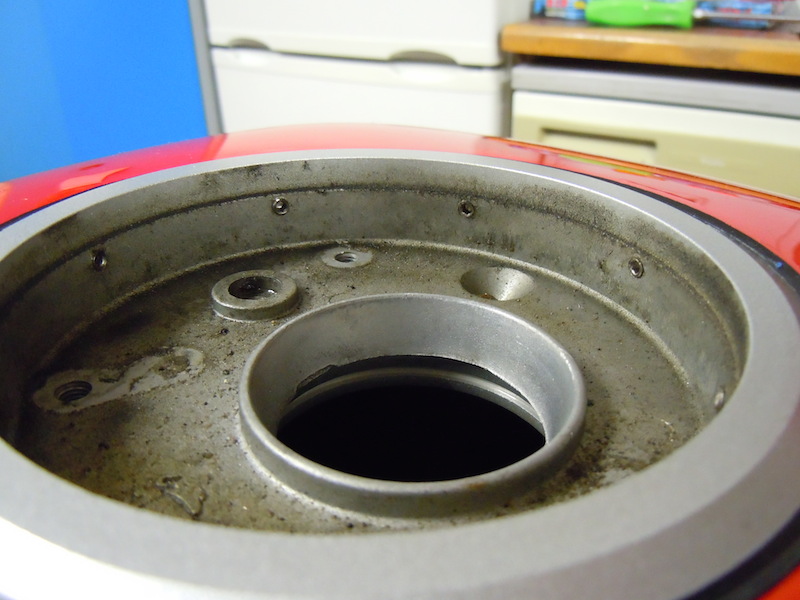

    Gave the area a clean out & then removed these eight grub screws & lifted out the filler neck.
    I'd read others posts about how hard it was to lift out the filler neck, but mine came out very easy really, just put my fingers in the filler hole & pulled it out with a bit of rocking ! I was a bit shocked to say the least !!

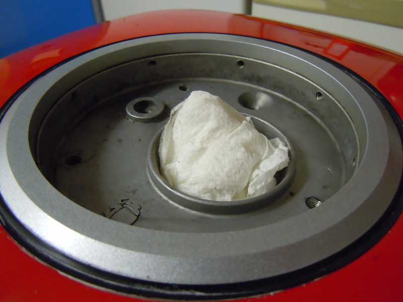

    Just put a bit of kitchen roll in the neck too to keep as much rubbish out of the tank as possible. Should have put this in place before I dropped my 5mm Allen key in the tank !

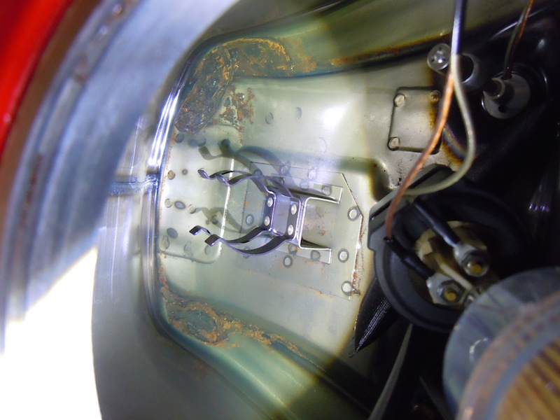

    Removed & put to one side to get at the filter & pump.

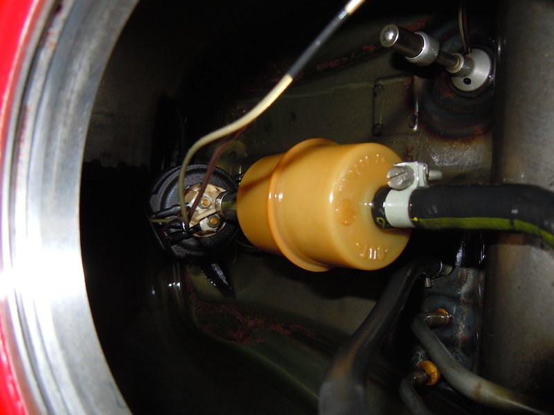

    Access to the filter & pump is now much easier.
    I found the hardest part of the job was getting my hand in & levering the fuel pump body out of the two spring clips that hold it in position.

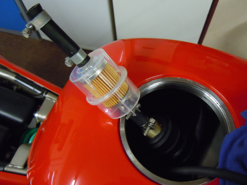

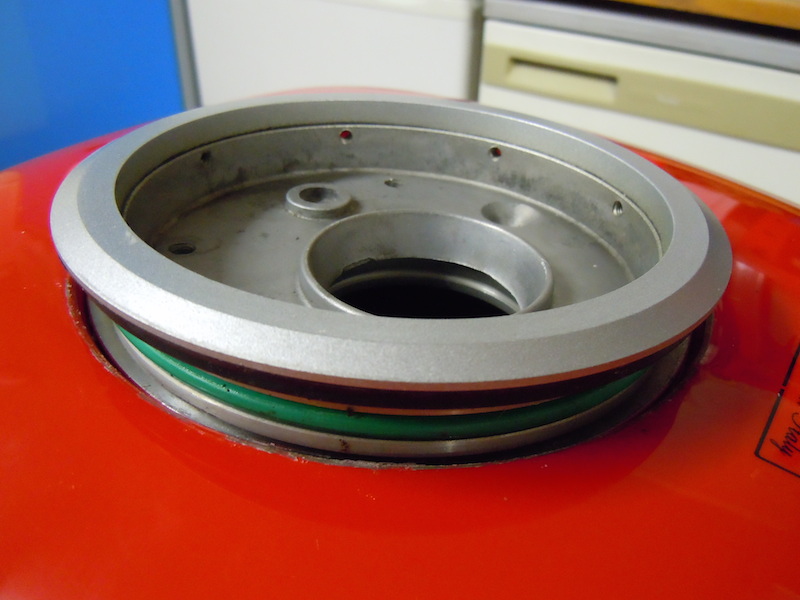

    New fuel filter connected, (the correct way round !) & a new O-ring fitted to the filler collar & it was then re-inserted into the opening in the fuel tank. I applied some silicone grease to the O-ring & some red rubber grease to the groove in the tank opening where the points of the grub screws locate. The reason for the red grease is it makes it easier to see if the collar is pushed down far enough so that the grub screws correctly. You can look down the threaded grub screw holes & see the ring of red grease, indicating the filler neck is in the correct position.
    When pushing the filler neck back in position you need to ensure it's correctly orientated so that the filler cap doesn't end up at some odd angle !! Ideally I should have marked the filler neck & tank before removing it, but I forgot !:bucktooth:
    With the filler neck almost in the correct position now is the best time to refit the weather seal. I had a plastic scraper that I use for removing sealant on aircraft, which was perfect for this job, so I didn't damage the paint around filler neck.

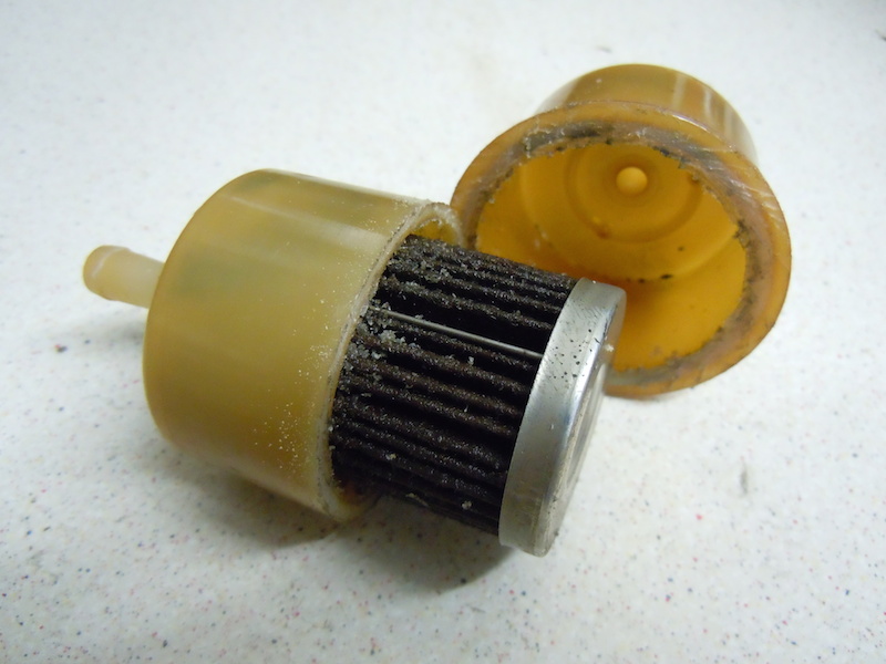

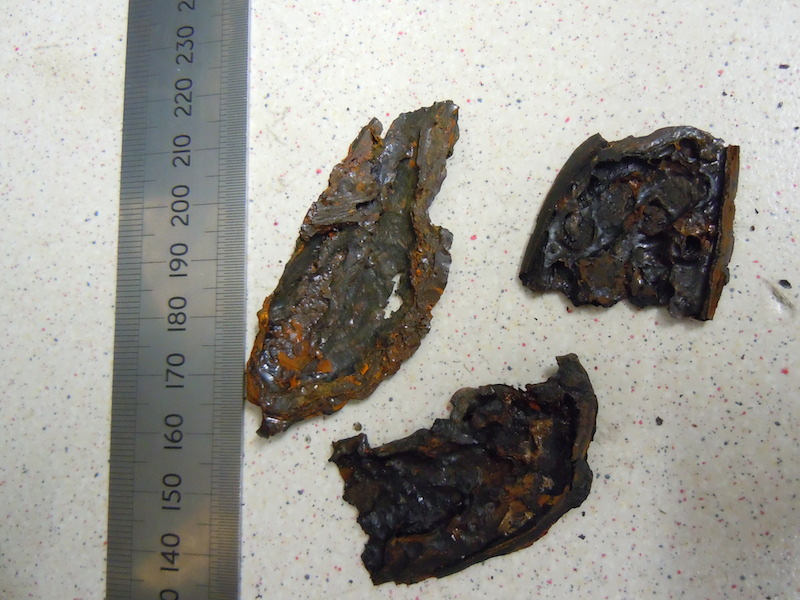

    Cut open the old fuel filter, (which I think may well be the original) to have a look how dirty it was.
    Also, lifted out these bits of crud that were in the bottom of the tank, right at the back, in the two corners. You can actually see these bits of crud in the tank in the photo above showing the fuel pump clips.
