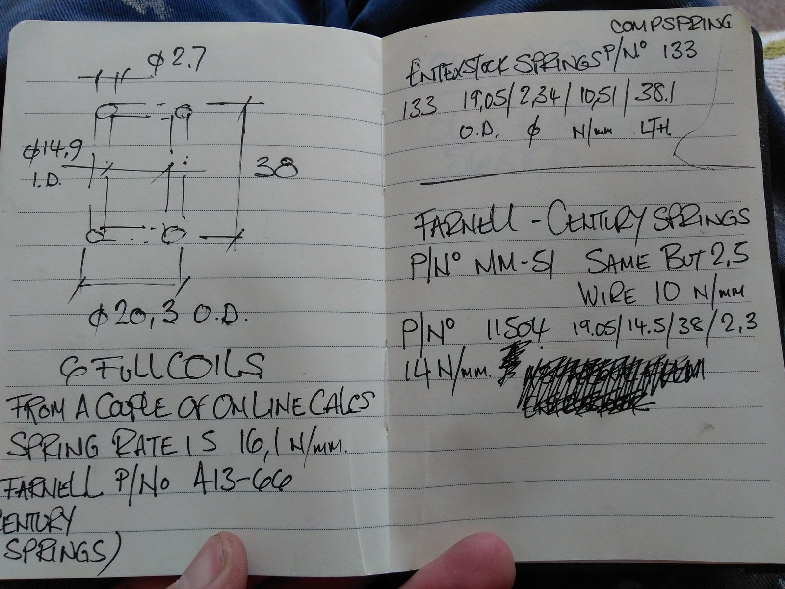

    I've been meaning to look at this for a bit. I had a quick measure of the spring and think the rate is about 16 N/mm. I though I would easily find the spring in the "Lee Springs" catalogue but could not, I thought it was another Ducati special. I found it on the Farnell web site and it looks like Century springs makes them.
    6 springs gives 96 N/mm. If you were going to take 2 out that would leave you with 64 N/mm, divide by 6 and that would be 10.66 N/mm. So I would say the part no. MM-51 would do or with a slightly tighter fit on the end caps (I think you would get them on) the 11504 @ 14 N/mm could be an option. Not sure why the P/n 133 from Entexstock and the 11504 - same dimensions have different rates, possible material.
    Hope this helps someone.
    Cheers Gaz
