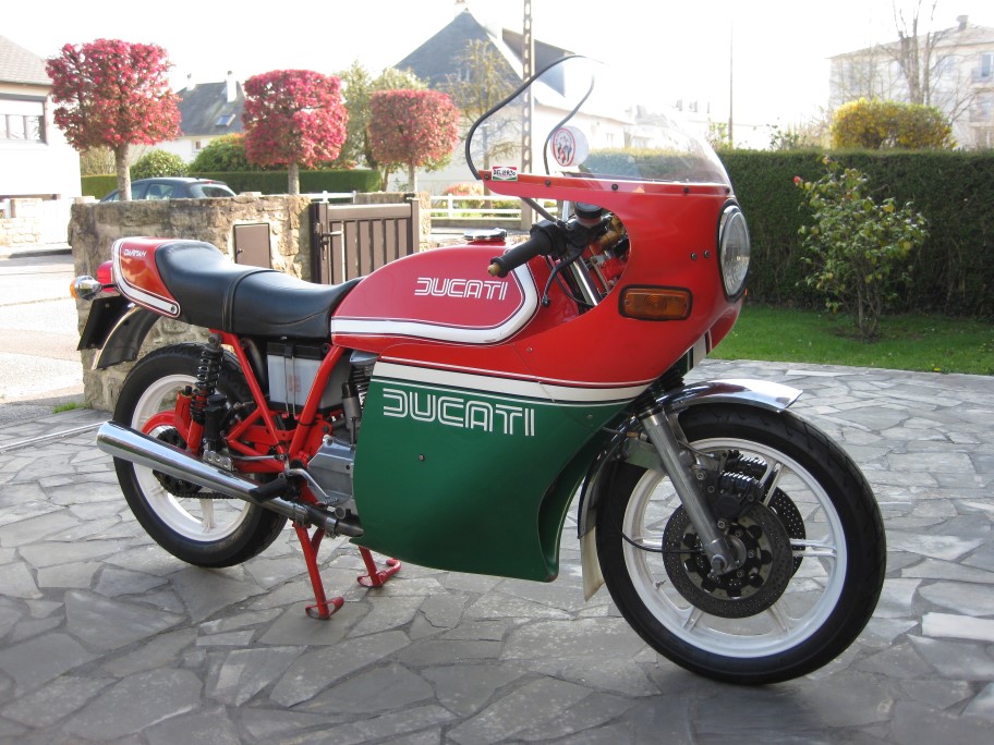

    That's my girl but Spring is here and the knee sliders remain new....drat.
