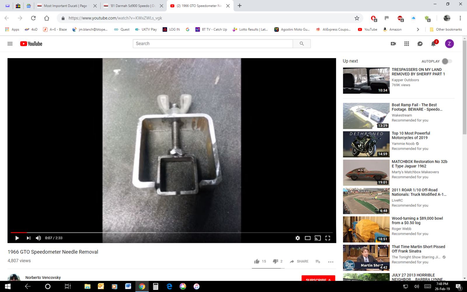

  4. Thanks Borgo, Your video was blocked here for copyright reasons so I searched YT myself and found this:
    which made it look really easy however before I try I'll wait for any other advice to come in.
    Watch this space :thinkingface:
  5. This is the homemade special tool he used in the video you couldn't see. The 'box', slides under the needle so its shaft locates into the slot. The needle's central boss is then lifted with the 'box' as the wingnut is tightened. The feet of the puller are positioned over the screws that fasten the dial to the clock for added strength. upload_2019-2-26_19-48-40.png

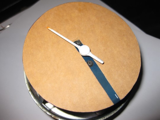

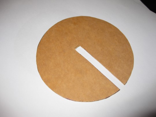

    Half a bottle of Cotes du Rhone with lunch, hairdryer to put some heat into the hand hub, two-spoons method as in the video I posted except desert and not tea spoons and pressed more on the spoon bit and not handles. First I cut a cardboard (cornflakes box) protection and loosely tethered the needle with some Scottish so it didn't go to the dark side of the moon when it came off, like things always seem to do...
    The spoon method works, together with the heat tip from "newtacho" who makes up new displays. Maybe the wine is optional...
