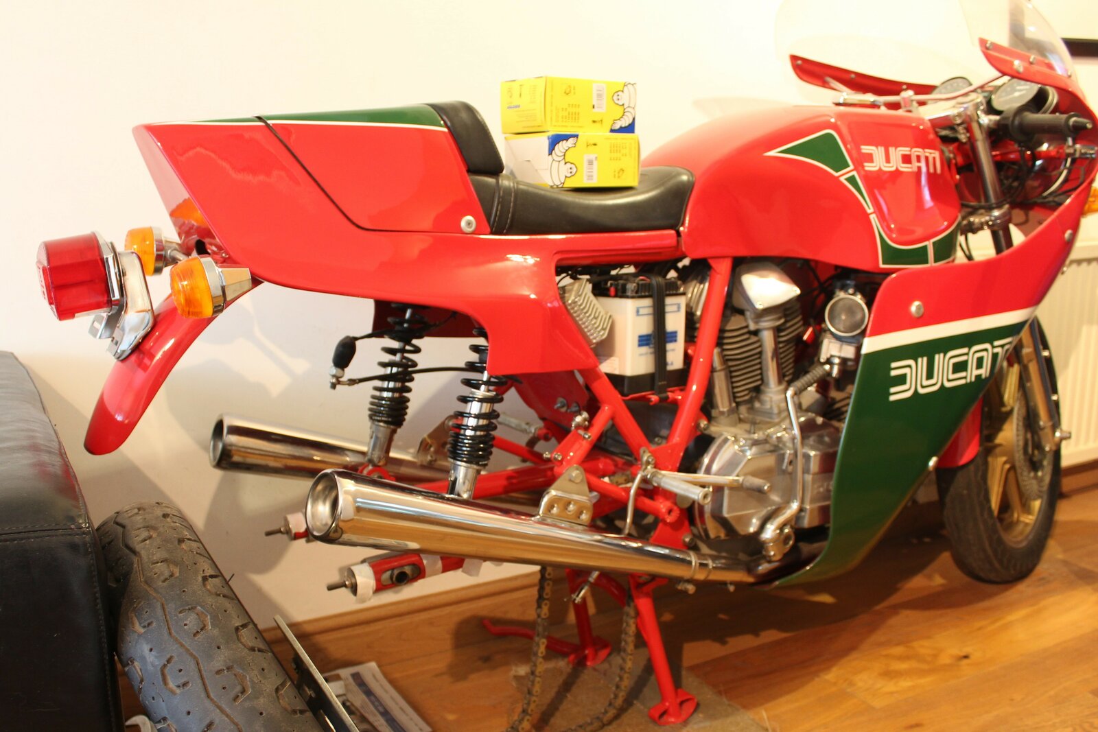

  1. I've decided that its finally time for my 1981 MHR to see the road again, after spending 25 years being a big ornament. I restored it back in the early 90's, since when its sat in my living room, only moving a few feet when the room was decorated.
    However, its been kept 'dry'.. no brake fluid in the brakes, no acid in the battery, no fuel in the tank, just fresh oil in the motor. Since the engine is kick start only, every few weeks over those years, I would kick it over as I walked past, just to keep things moving inside the engine. All of which should hopefully have helped preserve it. No doubt famous last words !
    Its still sitting in my living room, and it'll be awhile before it can be moved. But I've made a start by removing the master cylinders and callipers, they'll be rebuilt with new seals and pistons if needed. I've also bought a pair of new Avon AM26 tyres and inner tubes, to replace its Pirelli Phantoms, even though they've got plenty of tread left, but then they are about 30 years old, so I think they've seen their best.
    I don't have a lot of time to work on my bikes these days, and with other bikes to finish this year, I don't know how long this 'recommission' will take. But I hope to have it done this year.

  6. The local bike shop had trouble removing the old rear tyre, as it was so hard and dried out. They had to put a tyre warmer on it for awhile before they could safely lever it off. I'd told them to be extra careful, as the wheels are known to be easily damaged. Jut finished polishing all the alloy adjusters etc before refitting the rear wheel. Need to repeat the process with the front. Its been so long, that I cant remember if the bike is stable on its centre stand with the front wheel removed..
    I've also just ordered three rebuild kits for the P08 Brembo callipers and one each for the front and rear master cylinders. Cost £108 in total, I found the Guzzi specialist Gutsibits cheaper than any Ducati supplier.
