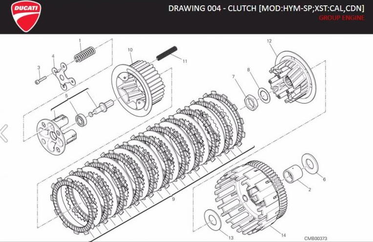

  3. Yeah, I've done that on 2 x 1098's now. My 1098R has 2 dished plates in as it was grabby and I have 3 or 4 spare dished plates in the garage somewhere. This wet clutch looks to be a different set up though Andy and these thinner plates sit inside the 1st friction ring. I've never seen it before and if you compare the parts diagram of the 821 and 939, they were added for the 939. Trouble is that Ducati want to sell you the full clutch pack.
    821
    939

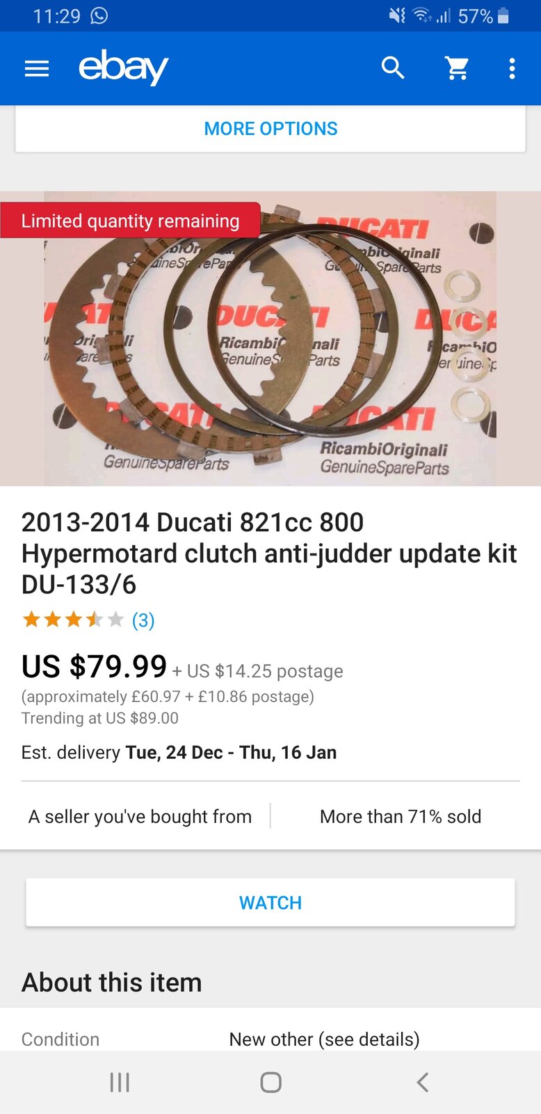

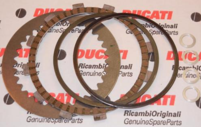

  9. Well, I've looked into this and it looks like this eBay seller is machining OEM friction plates to increase the inside diameter and allow it to accept the spring modification. :worried: He also claims that the steel in the kit is nitrided for longevity. :thinkingface: Then it's eBay and from the USA, what could go wrong? o_O

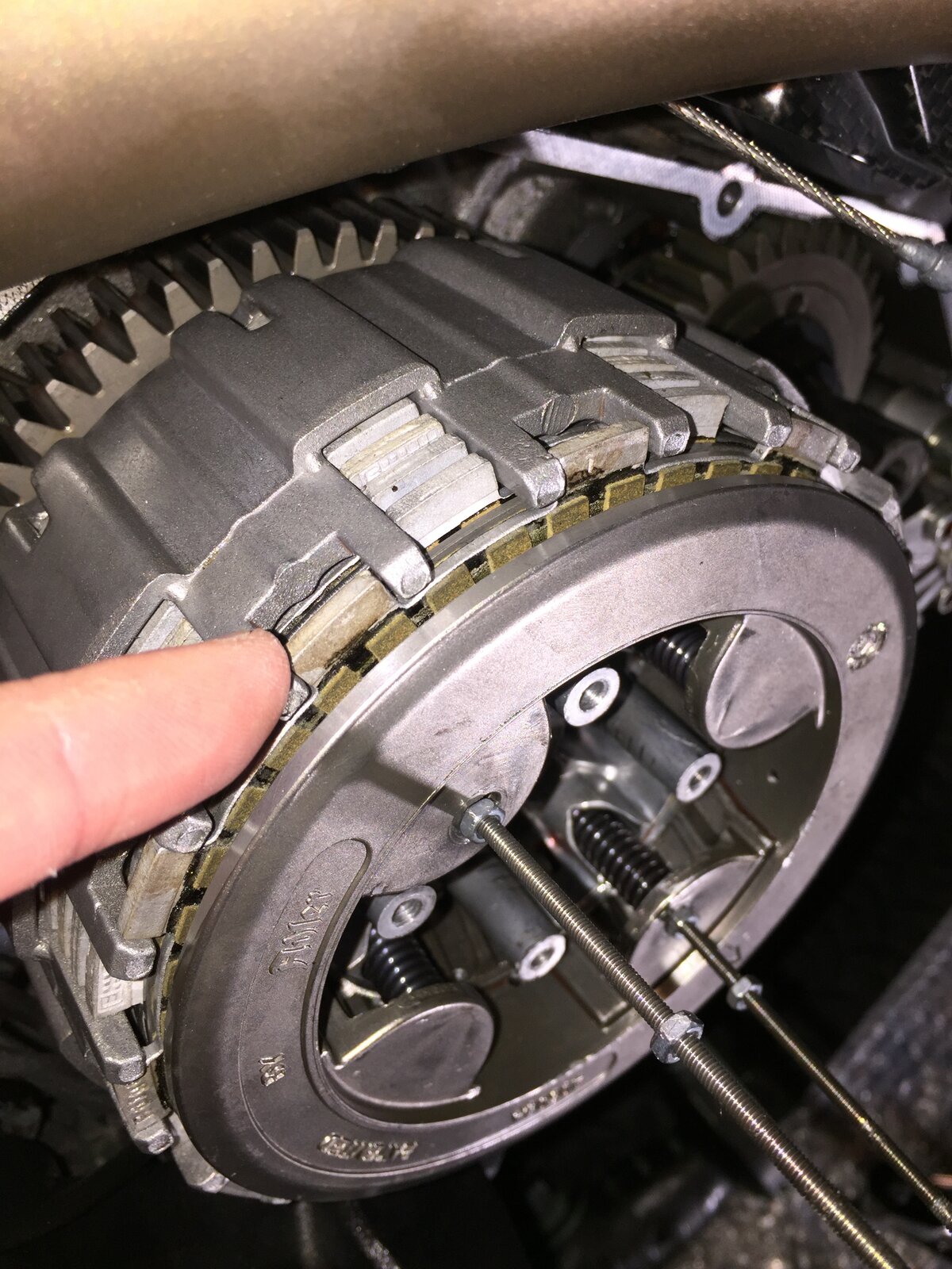

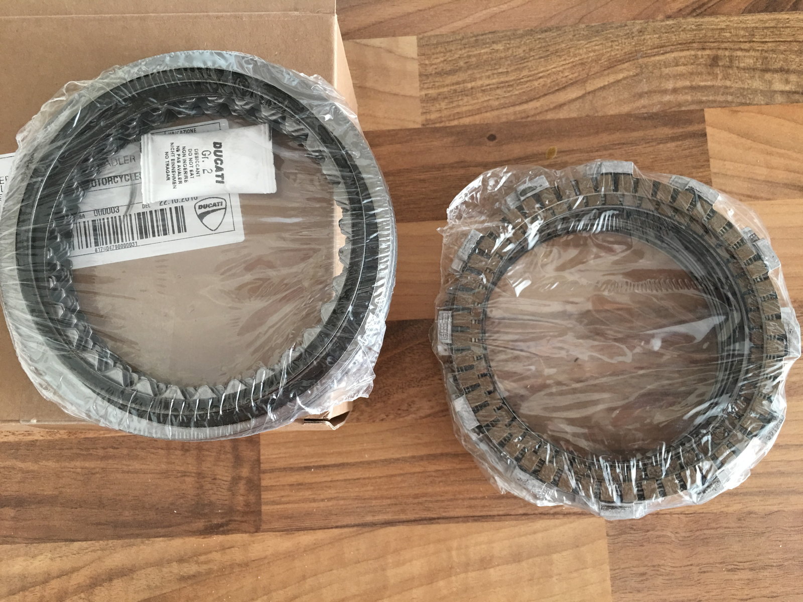

  13. Got the Hyper 939 clutch yesterday. Maybe a job for over the winter. You can see one of the friction plates has an larger internal diameter to fit the added rings into. Hopefully this will cure the switch like nature of the original clutch. :upyeah:
  14. Put the clutch in today. Snow on the ground, so not had a chance to give it a try yet. Fingers crossed. :)

  16. Hi guys. I purchased the anti judder kit for my 2014 strada. Went to the dealers to get oil and filter and ended up buying a 2018 939sp. I have the anti judder kit brand new for sale. I'm uk based so if anyone is interested let me know. As stated it's a standard friction plate machined, a spacer, a bevelled spring and a nitride steel treated plate. I paid £83 inc shipping and taxes. If anyone wants it. I'll do it £70 posted within the UK

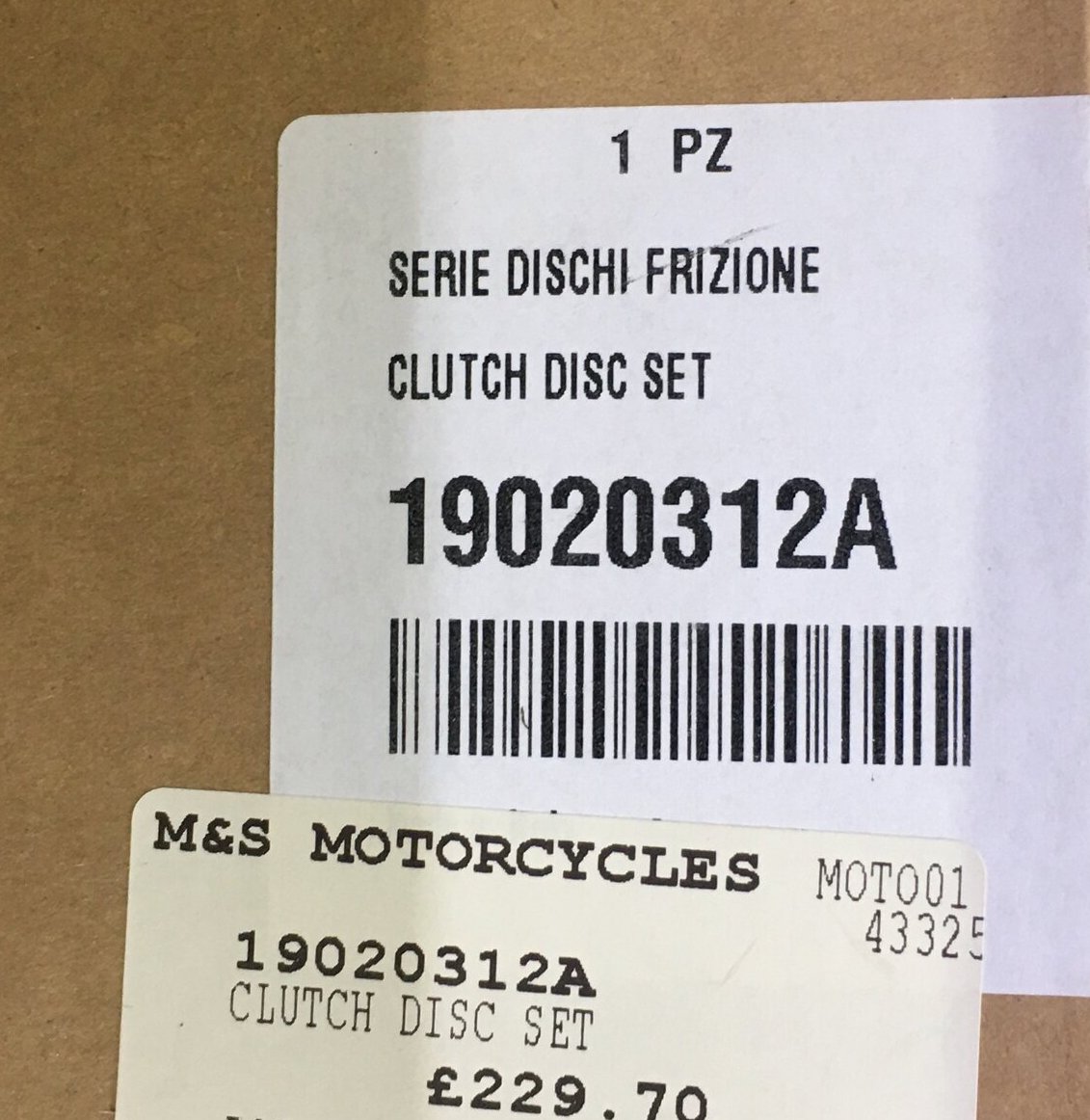

    2) I didn't buy the kit online, I bought the 939 clutch pack from my local dealer. List is about £230 but I got a hefty discount and got it for approx £150. You also need the three bond sealant which is about £20 a tube.
    3) Part 19020312A
    4) See no.2. You also need a clutch holding tool

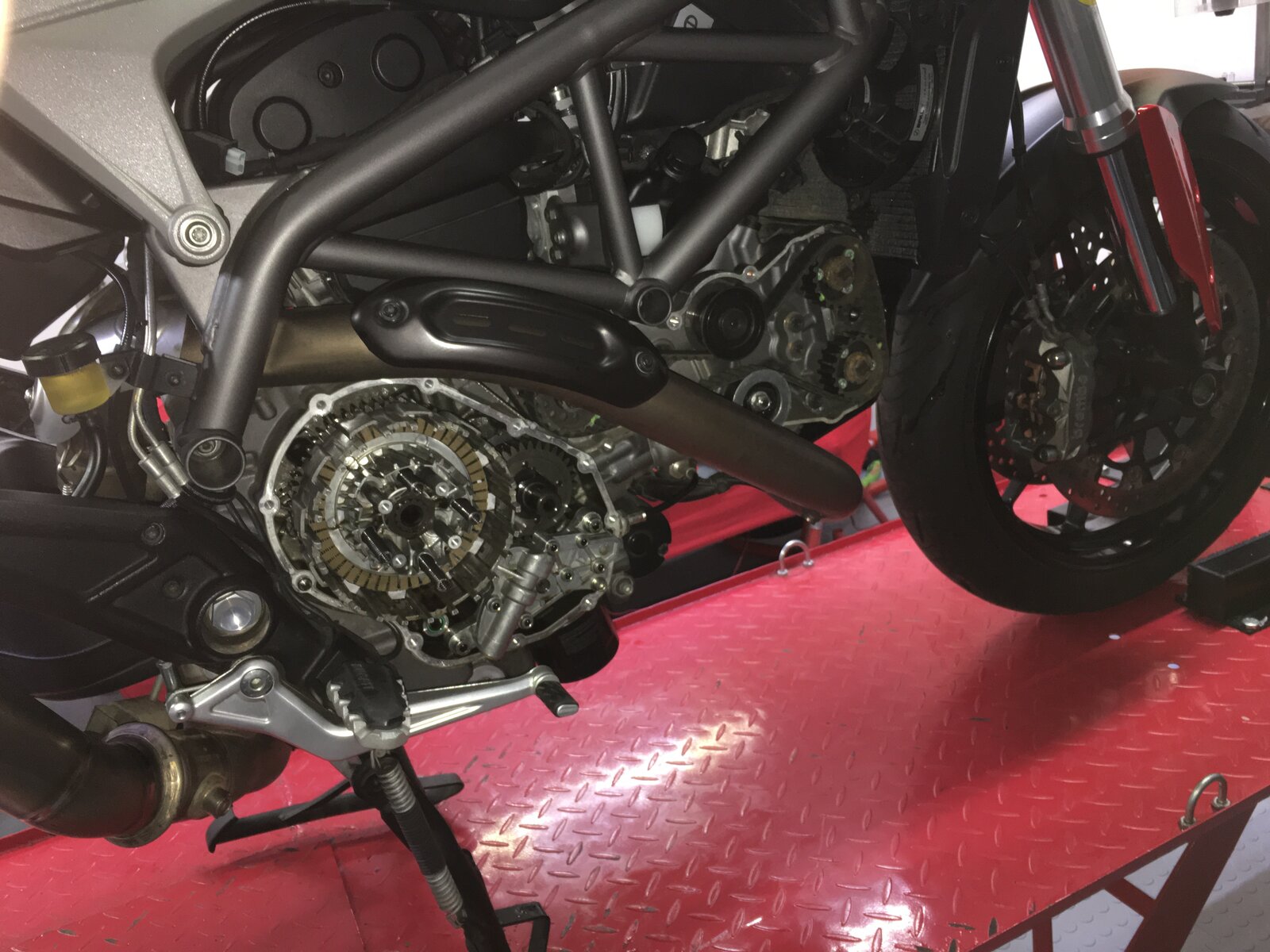

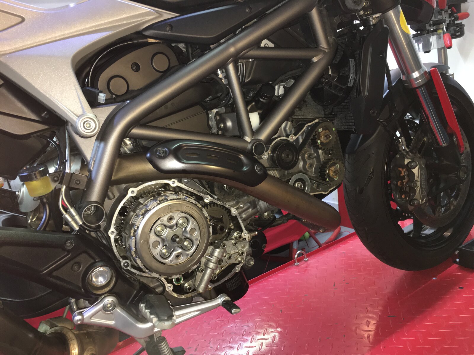

  19. Taken it apart, just waiting for the clutch kit now. No way of getting that belt cover off though without removing the front pipe - must be more room on the Hyperstrada? I've just removed the bolts so I can move it over slightly.
    The 32mm came off with the impact gun easily, hoping can somehow get it back on up to torque without buying the locking tool which would be another 60 quid down the pan :weary_face:
    When re-assembling, does the arrow on the basket cover have to point in the same direction that it was facing before it was all removed? Can't see why the arrow is relevant :confused:

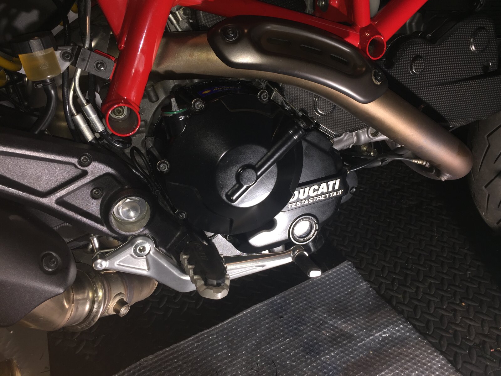

  20. So, all back together now. Just waiting for the seal bond to go off before I fill back up with oil. Will leave it over night to be sure.
    Few points worth noting for anyone else looking to do this;

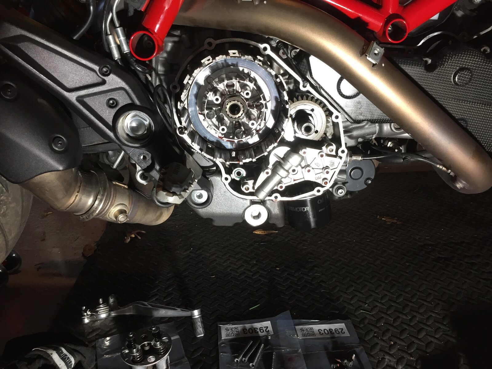

    I had to remove my rear brake lever and the cam belt cover to remove the gearbox cover. When I say remove the cam belt cover, I couldn't take it out fully as the header pipe / radiator was in the way but removed all Allen bolts to slide it a few mm's to the right out the way.

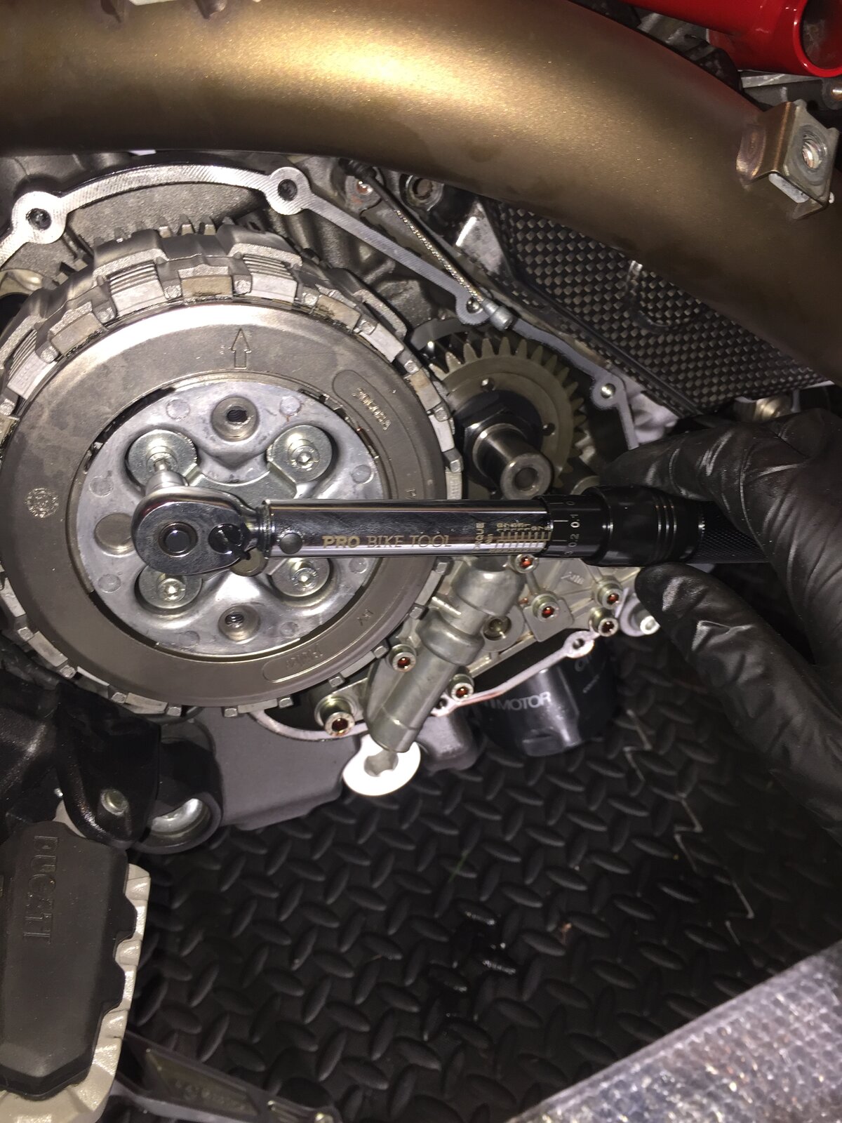

    You will only be able to fit the plates into the pack off the bike so you have to remove the 32mm nut. I was hoping to get around this but it was actually easy enough to remove. I have a lithium battery powered 200nm impact gun and it worked fine cracking it off. Putting it back on again is fine and torquing up to 190nm worked fine - you don't need the clutch locking tool, just take off the paddock stand and onto side stand, into 6th gear and step on rear brake whilst pushing down on the torque wrench. This sounds complicated but it is easy with just one person.

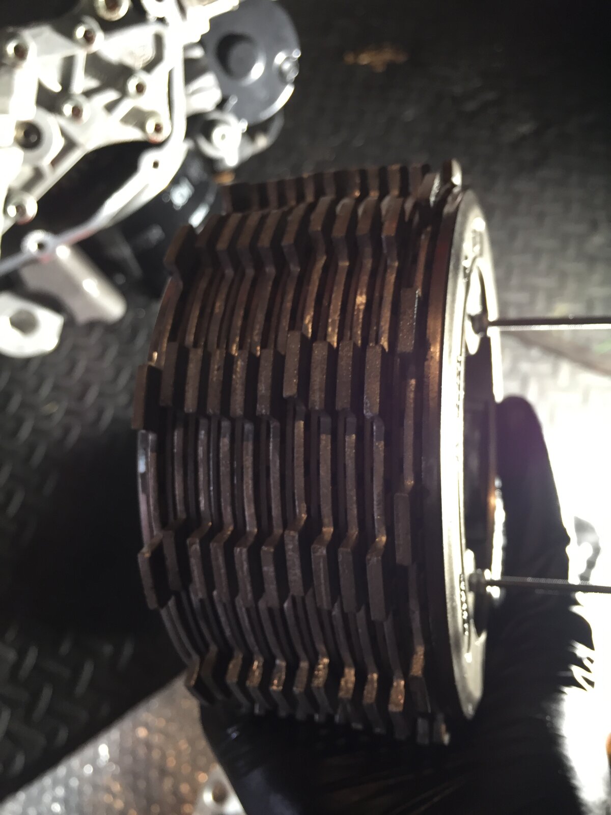

    When the pack is off the bike (picture below), make sure you compress it down and tighten up your little nuts to seep the springs compressed.
    When slotting the pack into the clutch basket, you obviously need to get the friction plate grooves all lined up to slide into the basket but make sure the last machined out friction plate is off set to the other basket slot (see below).
    Once this is in it's plain sailing, you can now refit the 32mm nut and re-torque (described above).
    Then refit larger springs and carrier with the 4x Allen nuts and tighten in sequence up to 5nm.
    Clean up the edges of the gearbox casing and apply the three bond.
    Fit and torque up the 10 Allen bolts to 14nm.
    Let bond go off overnight and re-fill with oil.
    As said, I haven't yet re-filled with oil as waiting for the bond to go off.
    Hoping it all works ok when I fire her up :D
