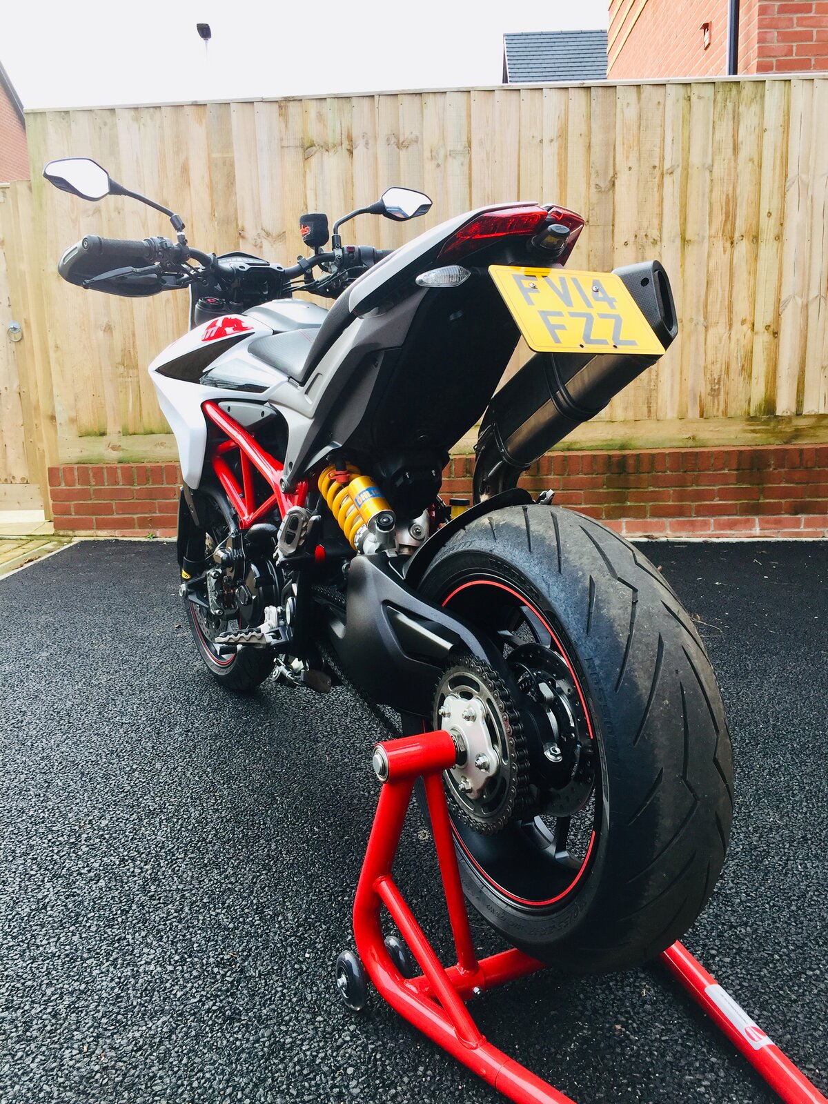

  1. Ok, so I want to have a play with the sprocket setup to make the gears longer. The red line comes up very quickly on these things which is great for darting around the city but on longer stretches, I'd like to draw out 1st, 2nd and 3rd a bit more.
    From what I understand, stock is 15T front and 45T Rear.
    Was thinking of upgrading the rear sprocket to say 42T. Anyone done this or similar before? If so what setup and which manufacturer etc

  2. Reducing the size of the rear sprocket will indeed make the gears “longer”.
    Somebody was selling a Renthal QR sprocket carrier the other day - this would make it easy to play with the gearing - you could get a couple of different sprockets and have a go.
    Not sure if you would need to shorten the chain - you might get away with it.
    Have fun.
