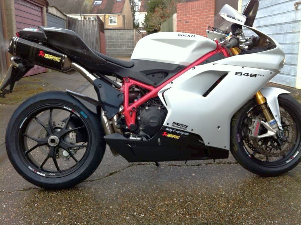

    KTECH or ohlins rear, front springs & valving and get the centre of gravity up. IMG_0953.jpg IMG_0955.jpg

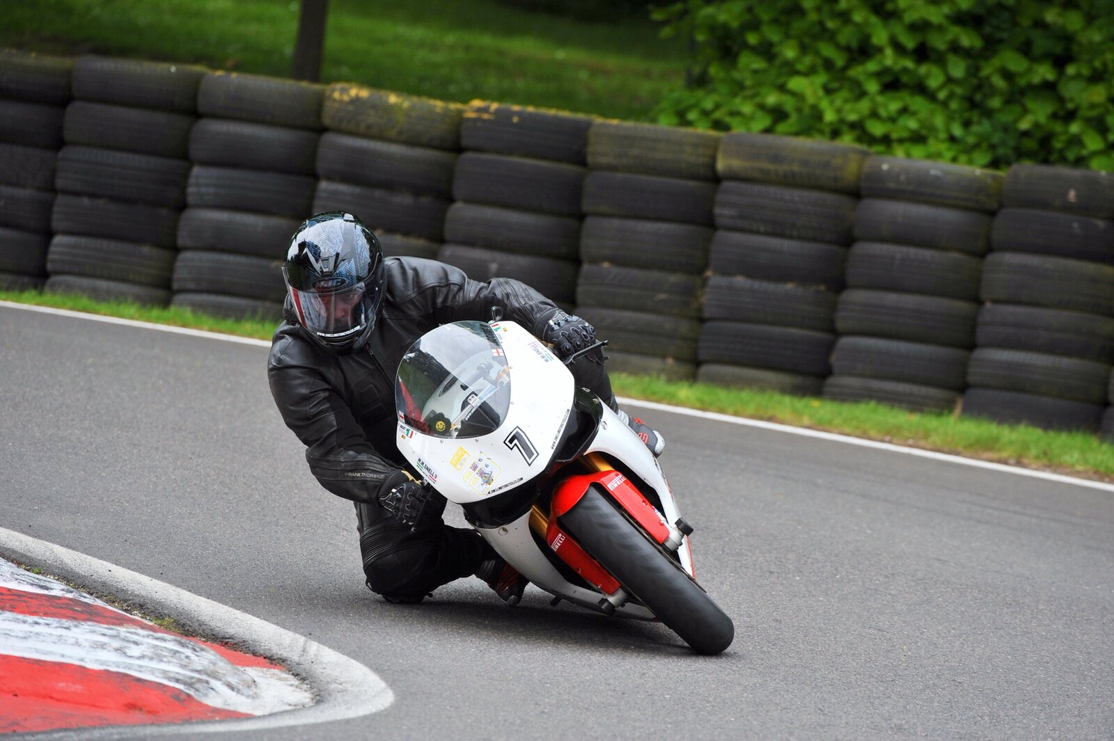

  8. Kin ell bladders that bike a moped under you, just saying like. o_O Running number 7 too. o_O

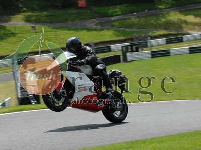

  11. Just to show the wheel still can get up ;)
