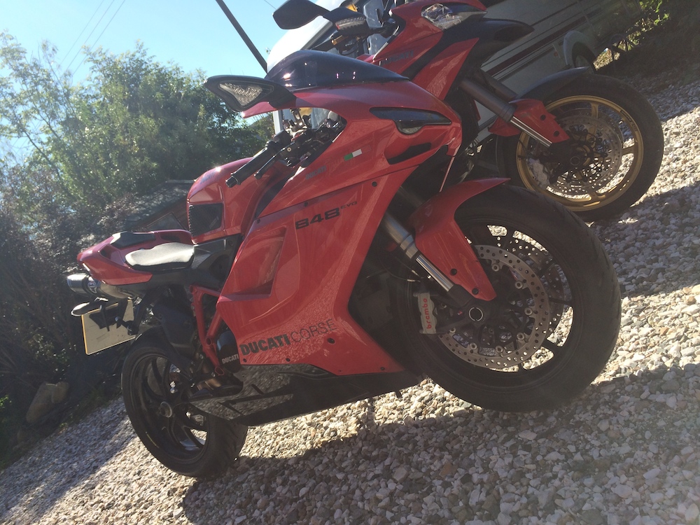

  1. Just moved from a lovely 749s to a mint 2011 848 EVO, better engine,better handling,better finish, looks debatable, the 749 is such a beauty. However, barrelling round a corner last night and a merc was turning right into my path, sphincter and brakes both applied with little decent result, sure, they slow the bike down but not nearly as quickly as you might like.
    I did bleed them through and got rid of some bubbles before this incident, as it did pop up before, but they are not what i hoped for. My Multi is way better at stopping for instance. So is there a simple-ish fix for this ? sintered pads? new hoses? what do you reckon. IMG_4289.jpg
