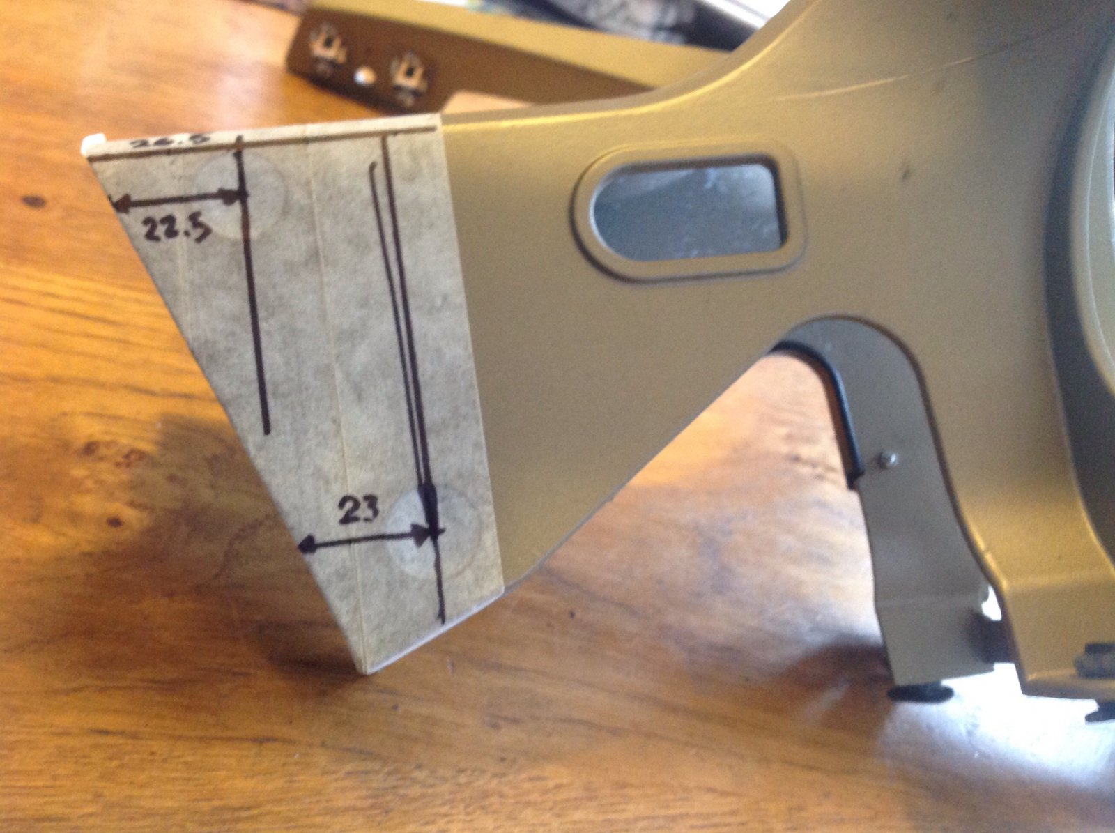

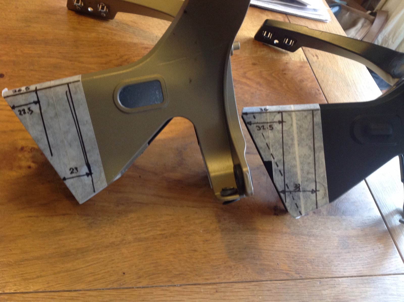

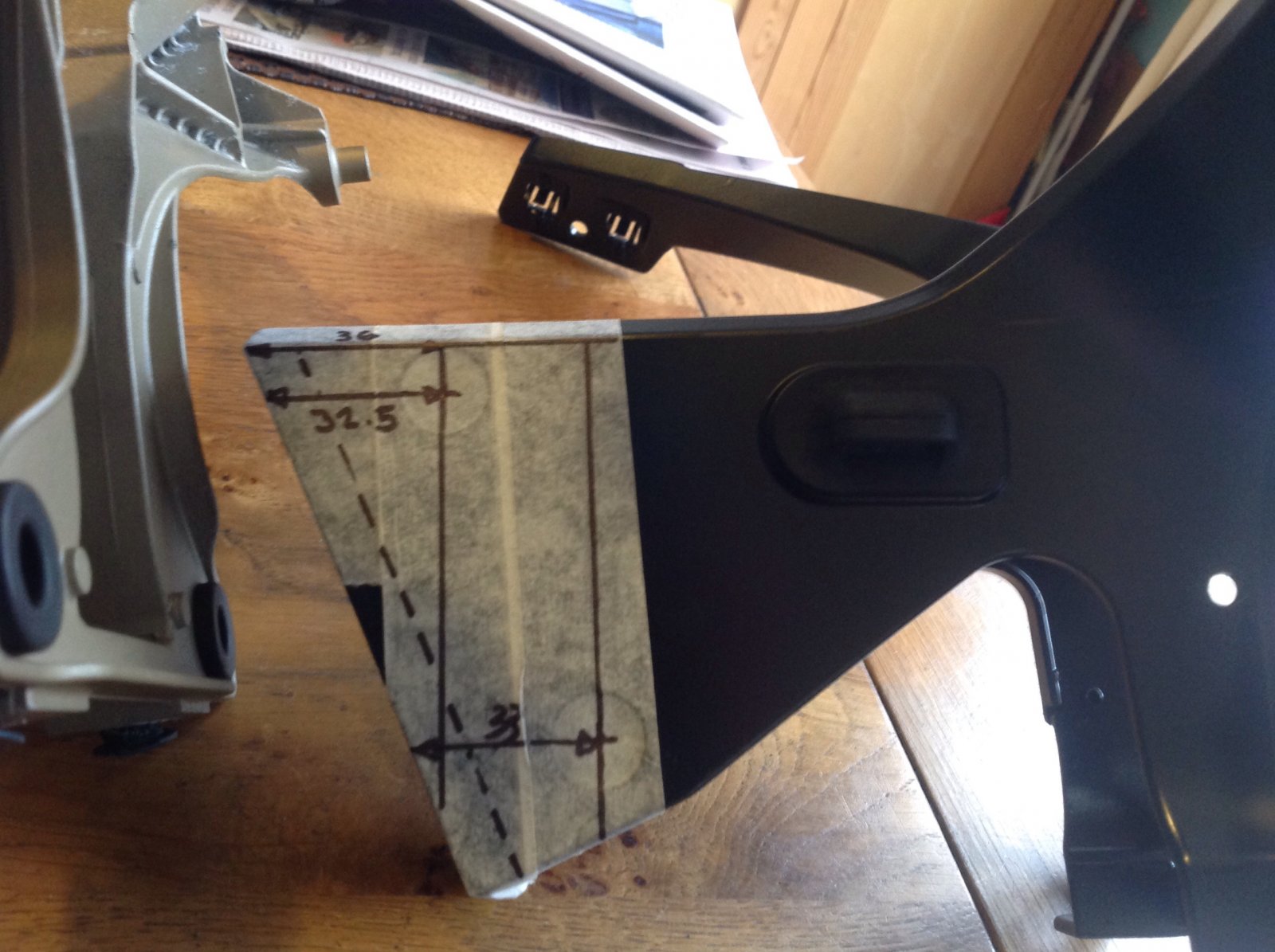

  1. In order to preserve my original fairing brace on my R, I bought a cheap repaired fairing brace off eBay, cleaned it up and painted it black.
    Went to fit it the other day and.....it doesn't fit!
    The mounting holes on the 848 bracket do not engage with the 1098R lugs on the frame.
    I checked the casting part numbers and they are both the same number.
    Physical comparison twixt both brackets reveals that the R bracket is a shorter distance between mount holes and aft edge of casting.
    After a bit of head scratching, I reckon the reason for this is because the R has a larger diameter headstock to accommodate the eccentric for changing the head angle.
    Ducati therefore machine off the back part of the casting for the R to maintain the geometry for mounting the fairings.
    See below comparative pics - 848 is the black one, R is the gold one.
    I am planning to cut off the extra 10mm on the black one and then all should line up.
