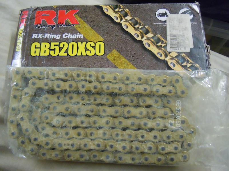

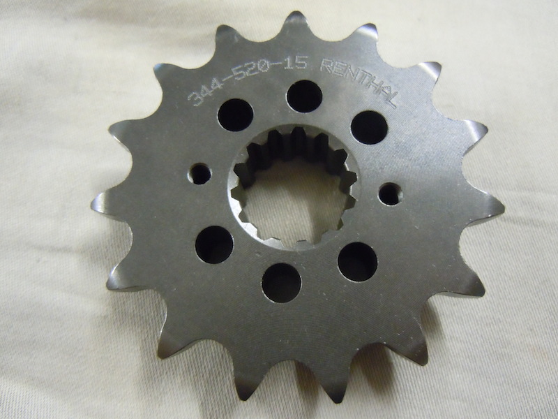

  3. Here's a spare Renthal engine sprocket I have ready for my 750SS,
    Spare RK chain I have for the same bike,

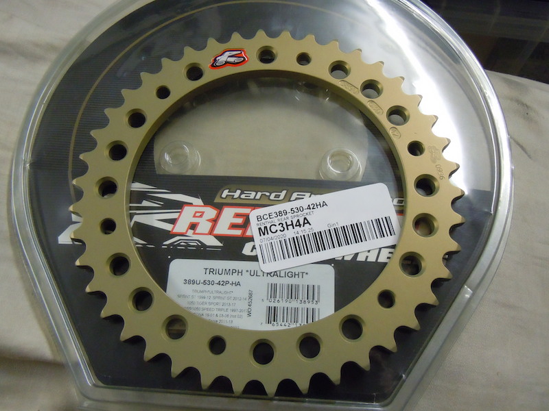

    Spare Renthal rear sprocket for my Triumph,

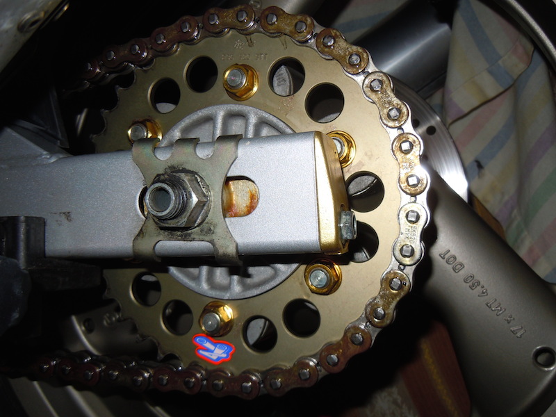

    And, the rear sprocket & anodised nut on my 750SS, which will soon be replaced for the same, (some O-rings on the chain have failed) with anodised nuts.
    Pictures are just for a guide, your 848 parts would look very similar if you use Renthal sprockets. The DID version of that chain would be a deeper gold in colour.

  4. They can't be 'anodised' nuts as that would mean they're Aluminium! Plated steel or Titanium more likely....

  6. You've never seen aluminium nuts?
  7. Yes I have, but not used with steel studs without them having 3x more thread insertion!
  8. They ARE aluminium nuts, anodised gold !
    He has now !!:joy:
  9. You're never too old to learn & see things you've never seen before !:joy:
  10. Don't worry Keith_P, it bothers me that they wouldn't be strong enough too.
    But there appears to be lots of them about.
    Nasher
  11. In fairness using alloy nuts to hold my sprocket on did concern me somewhat at first, but they have been fitted for a good few years & over 8000 miles with no issues.
    The only thing I didn't do was use the normal Ducati tightening torque for these alloy nuts, I used a lower figure & a little low strength Loctite.

  14. The ally nuts are roll tapped and you don't need a thread insert, they torque to the correct spec too, i had them on my previous bike. So yes you do get ally nuts.
