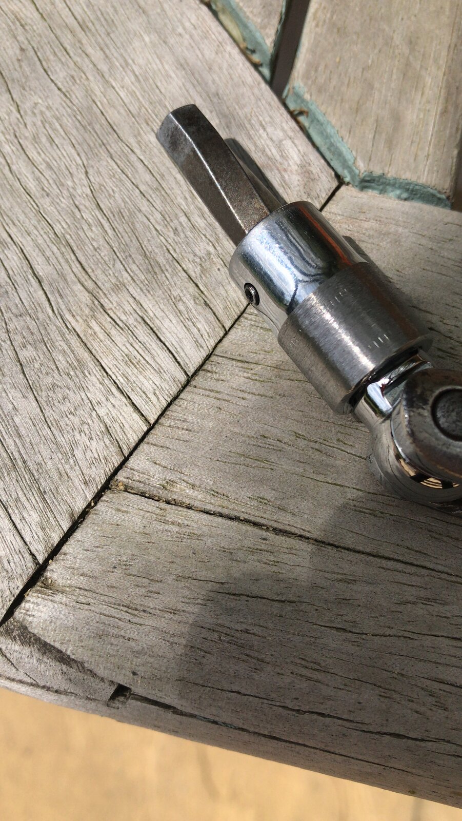

  1. Hi, looking for a bit of help here again, I need to remove the rear shock for a service and new spring, the bottom bolt is recessed quite deep in the swing arm and so to avoid any risk of killing it I bought a long reach Snap On 8mm Allen socket, It broke!! sheared off.. I got the broken bit out and the socket head looks ok, bolt has most likely been is there all its life, I can't see a way of getting any heat on it, I have been spraying WD40 in the approx direction but don't really know if its doing any good. Picking up my replacement socket tomorrow, any ideas that might help shift this.. Thanks..
  2. An ordinary allen socket (short length) should go through the access hole with less chance of it snapping. If you do damage the bolt head you will need to remove the arm and have it drilled out....;)
    If its anything like an 1198 wait till you actually try and get the shock out :joy::joy::joy:
  3. Thanks guys,, ill try a shorter Snap On bit, just been looking again and if I grind literally .5mm off ill get it through the hole in the arm, iv soaked it up again with WD40, see what happens tomorrow.
  4. Hi, so still attempting to get this bolt out, bike is lying on its side so hopefully the penetrating oil is soaking the thread end that I cannot actually see, it may just be going inside the swing arm somewhere, who knows. Im going out to it every few hours and beating the whatnots out of the bolt head to hopefully do something. Twisted another Snap On hex, Iv ordered the super short stumpy one now so there is nothing to twist, when that arrives it will be last ditch attempt as the head of the bolt won't take much more.. FF5540B4-A311-48A7-8DDB-C04C8B738897.jpg

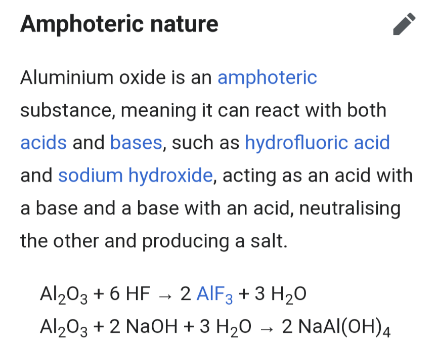

  17. Good idea, but Aluminium oxide (have to assume that's what's happened 'grown') is amphoteric so the results could be a little unpredictable... Wiki info:
  18. Thank you keith ....
