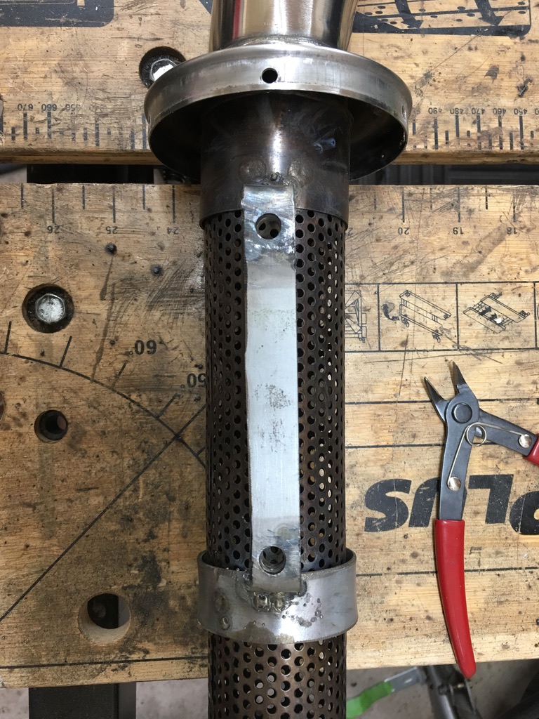

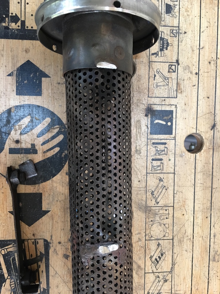

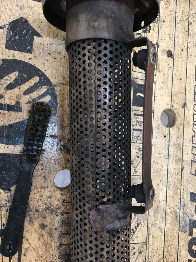

  9. When I repacked my 888 Termignoni slipons the brackets inside the cans had rotted away. The inside of the standard cans are not the same as yours, but I am sure you get the idea of what could be happening inside. See if the movement looks to be from within the can itself.

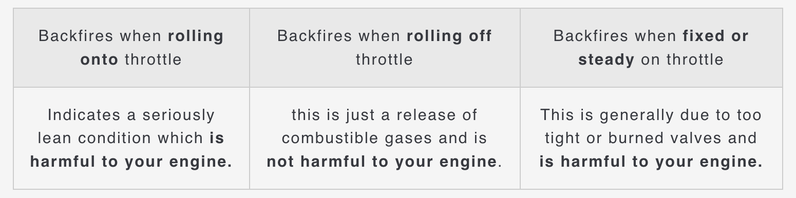

  12. Thanks Bridgland, my symptoms are when rolling off throttle, so good news!!
