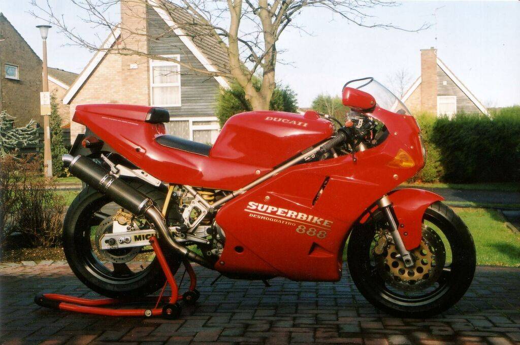

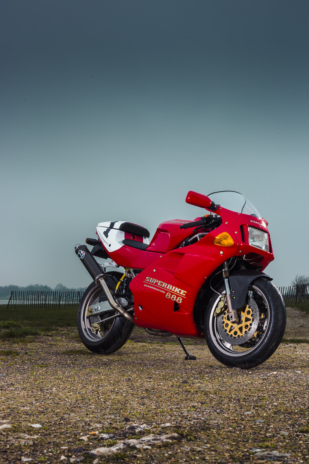

  3. The 888 has been my dream bike too, so I know where you are coming from.
    Steer clear of tracked and highly revved bikes (regularly over 10k RPM), as the early cases couldn't take the stress and cracked.
    Main thing is to find an honest bike. Mine was owned by the same guy for over 18 years, with 4 owners before him, and had done just over 23,000 miles (most in the first 2 to 3 years).
    The paint on the engines lifts and, depending on how dry it is stored, the flaking of paint can be minimised.
    The service history was patchy in the last few years before he sold the bike, but every time he did get it back on the road he took it to a garage to get serviced and got oil and belt changes done. The belt changes here at a dealer will be around £230 done.
    I was after a project bike and the one I found was very tired cosmetically. I did a full nut and bolt restoration on the bike over 2.5 years and the engine was completely rebuilt (engine alone cost around £2,200 to strip down, re-coat and replace all bearings and bushes).
    It had period correct upgrades worth a few £s now (Carbon front hugger, Termignoni high level exhausts, open airbox modification, correct ECU chip and a number plate with "888" in it, which costs a bit here to buy)
    You can look at what I did on my website www.ducati888.co.uk
    For a concours 888 Strada, they are making around £10,000 to £11,000 here in the UK, but typically more like £6,000 to £7,000 if a little untidy and in need of a service, or £7,500 to £8,000 ready to go with period upgrades and showing limited signs of age.
    Before Restoration
    After Restoration

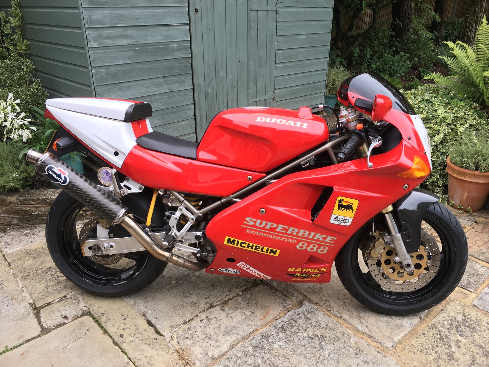

  10. That’s good news for me I’ve got a strada which has been sorn for about 13 years in a dry garage. Just about to give it a major service - it’s got 10k miles on the clock - genuine I’m the third owner had it for 19 years. Might be looking to selling once I’ve got it running again.
    It’s got full carbon exhaust and I have the original duke ones as well.
    what do you think it could be worth. C0ACA46B-965B-41CE-9E1D-DB7D1373E078.jpeg
  11. £2000 il pick it up tomorrow mate :p
  12. I think it will be worth 8-10k when serviced
    With less than 11k miles that is low
  13. It is all down to condition and service history. If it has been laid up for a long time you will no doubt need to consider the effect on all of the oily bits, wet bits and rubber parts. If you are planning on recommissioning it, these might be significant costs.
