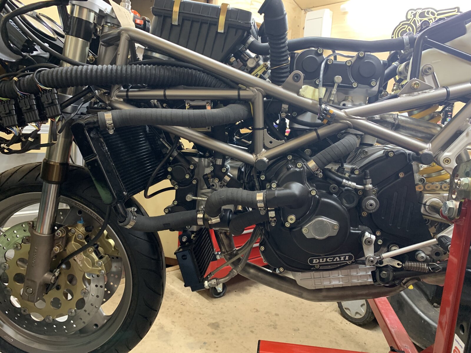

  4. I had the Samco ones made in Classic Black. Mine is a later 888 Strada, but here is the look on the bike after I restored her.
  5. I ordered the classic black ones (@moorespeedracing.co.uk), and I am glad I did, they look great on your bike! Thanks for sharing.
