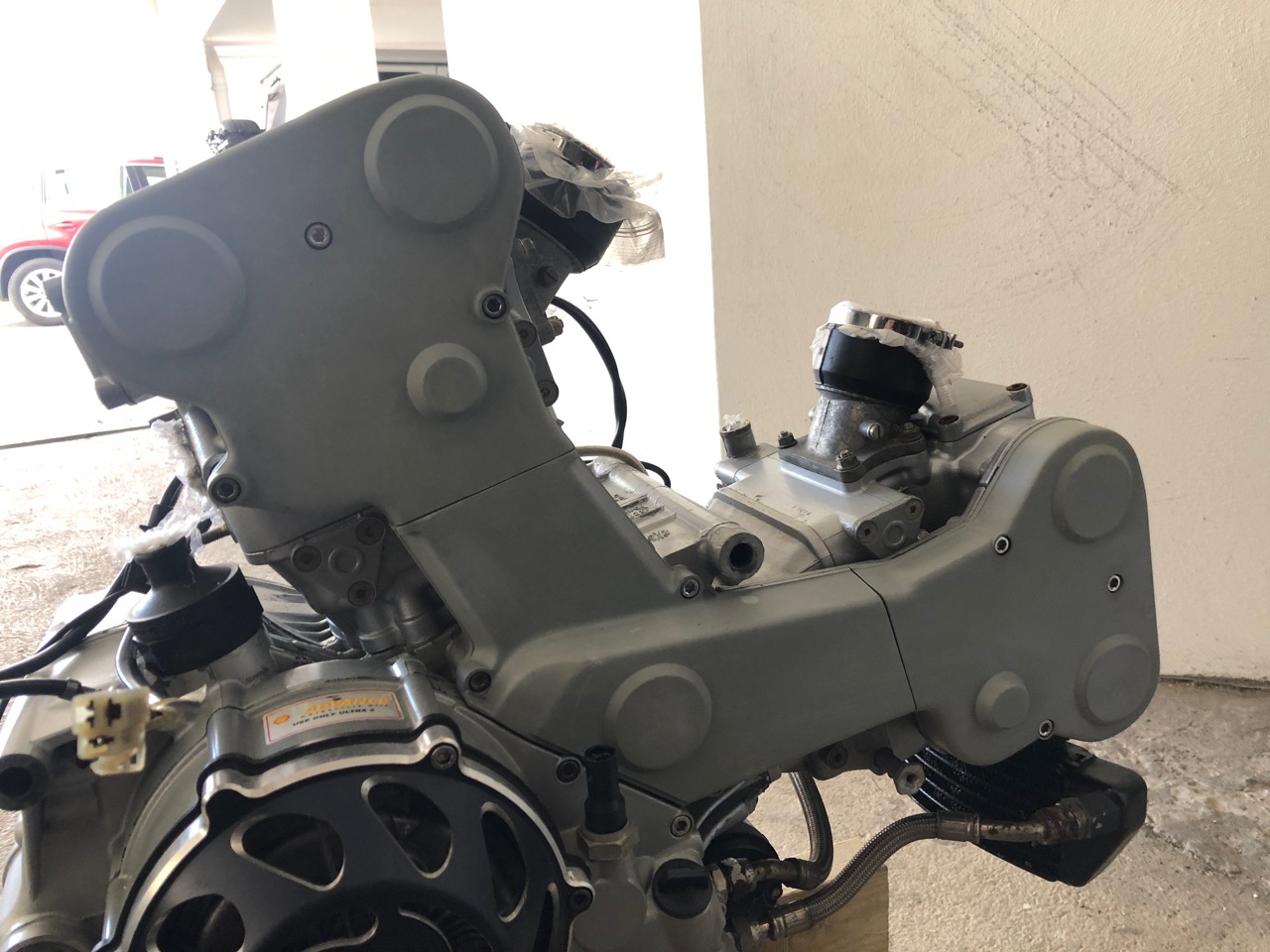

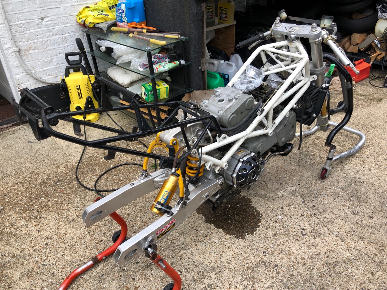

  5. Still waiting for some parts before I can give any meaningful update (loom, ECU etc etc)
    So for now just see pictures :

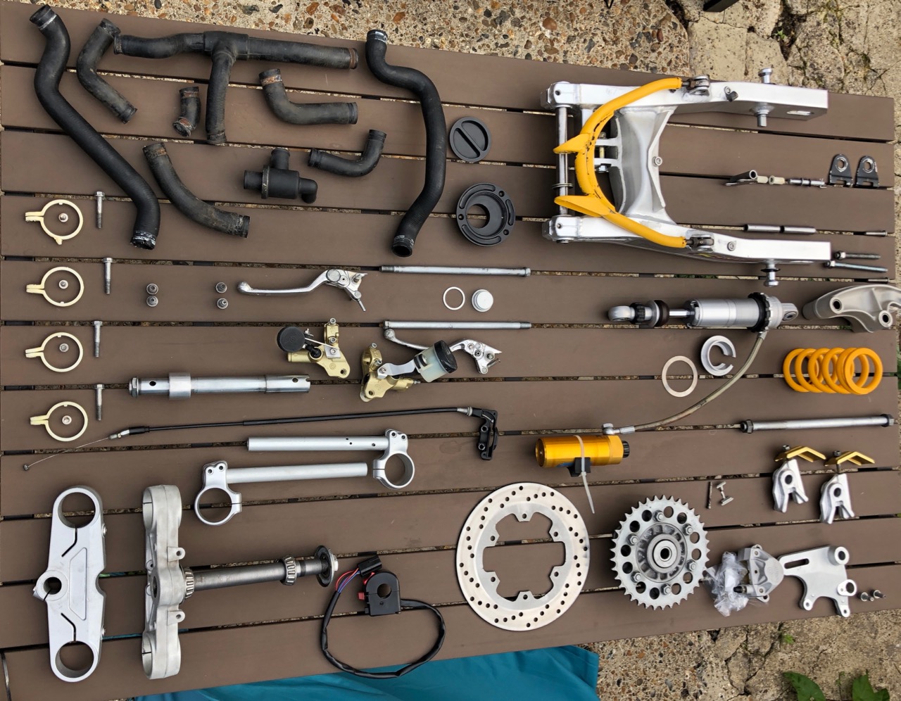

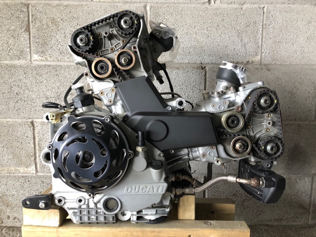

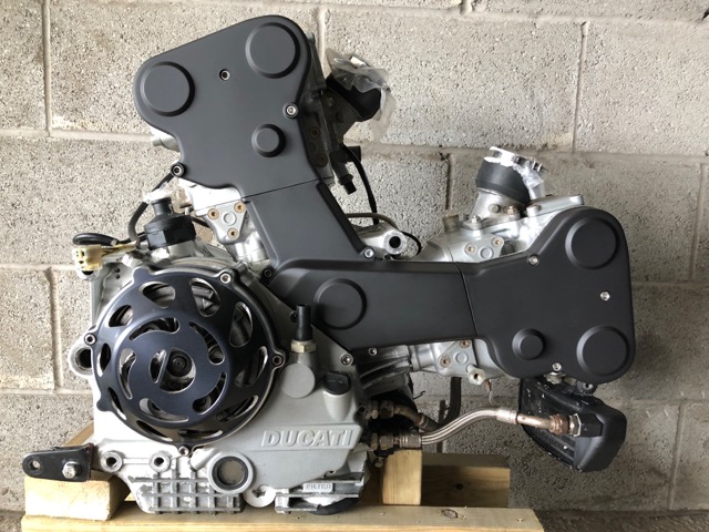

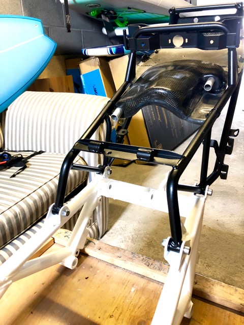

  6. Engine now removed for some TLC and the frame is off for blasting and painting..

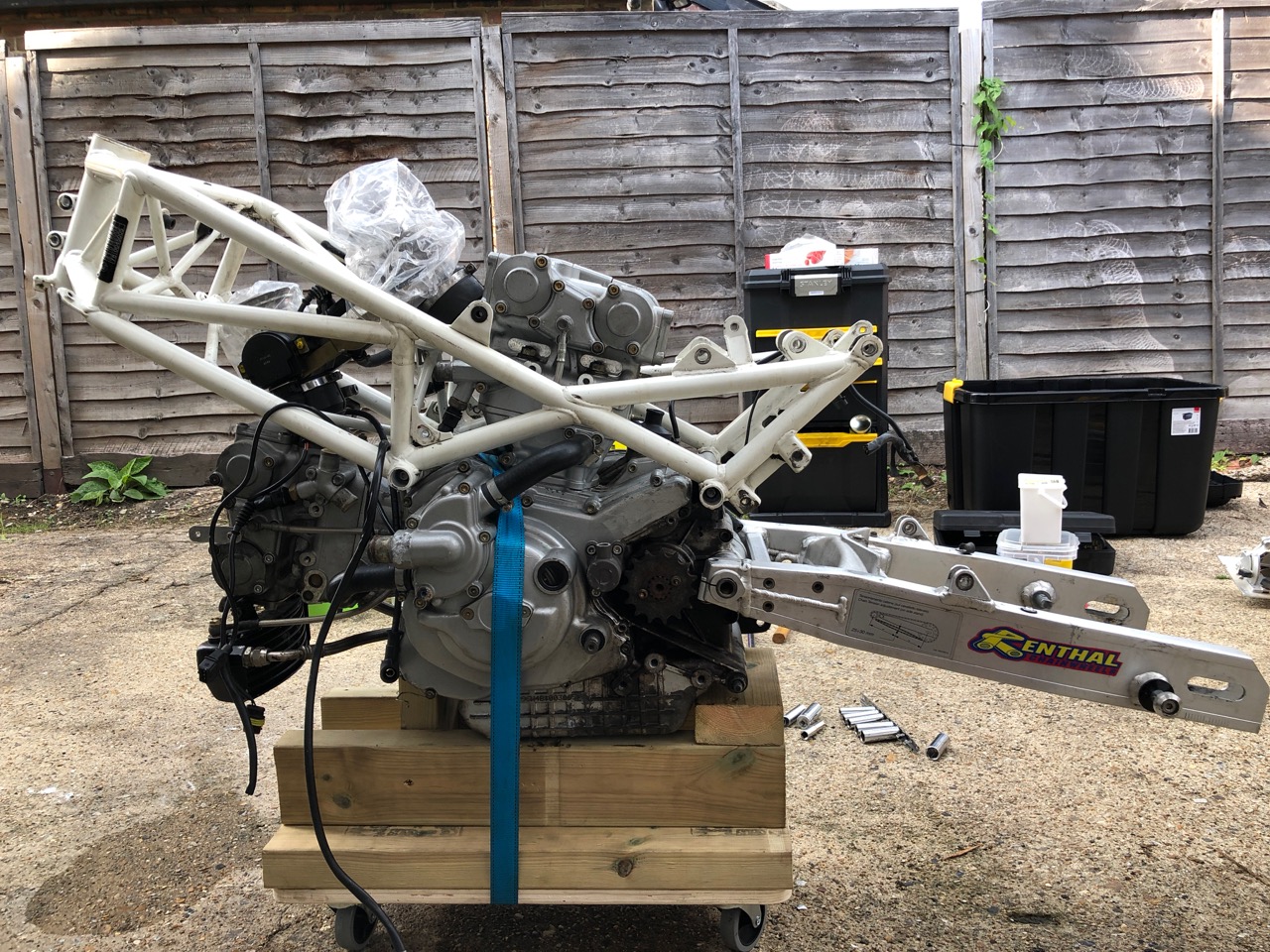

  7. Love the engine stand simple but effective..... Topman:upyeah:
  8. Thanks !
    All bought from B&Q surprisingly. They sell some pretty decent plywood dollys rated to 200Kg and then I just added some timber cut to shape

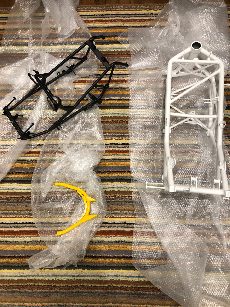

  9. Parts are back from being blasted and powder coated, I can highly recommend these guys if you need the same work doing : https://www.icmhome.org.uk This is the second time I have used them, they ride, restore and love bikes so you know your bits are in safe hands !

    To recap, the primary gear setup in the bike had been modified and we needed to buy a new set as the modified one was binding, not sure what the intention was of whoever did the modifications, it looks like the were trying to lighten the gears but maybe used some from another model - who knows.

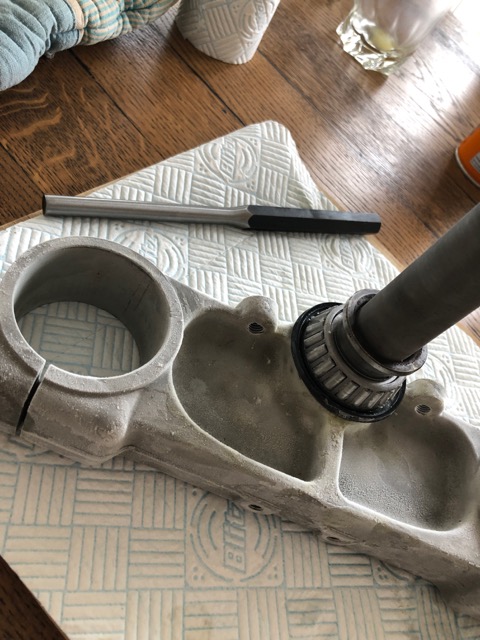

    With the above fixed, I have started on assembly. Just waiting on removing the old head bearings as the lower race is not playing ball...

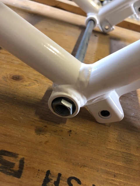

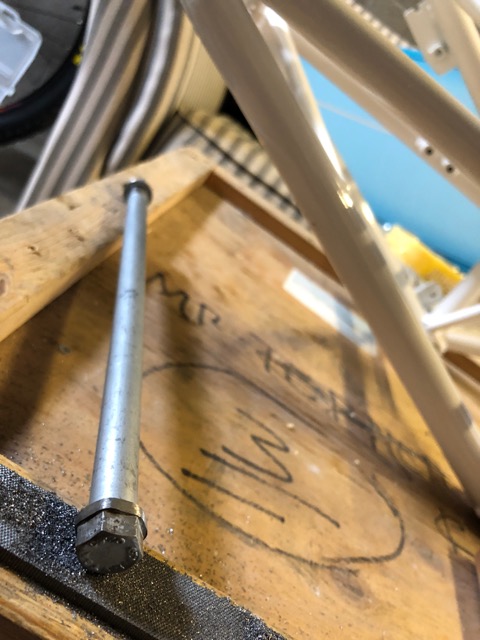

  11. With no access to a lathe I had to use some ingenuity today to 'modify' the ST4S 12mm Frame to Engine bolts (the frame has already been drilled out to 12mm)
    Neither the heads of the bolts or the flanges on the nuts would pass through the frame openings so I had to 'turn' them down on the "MacGyver" lathe...

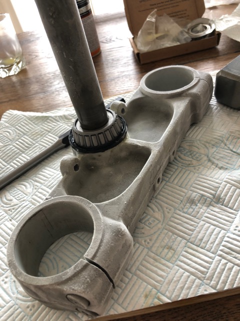

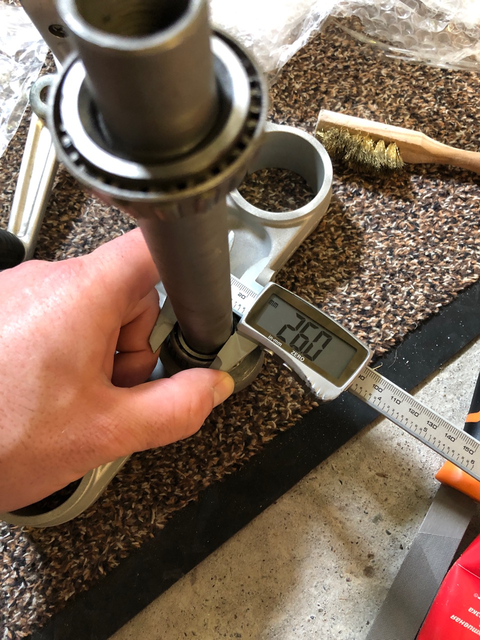

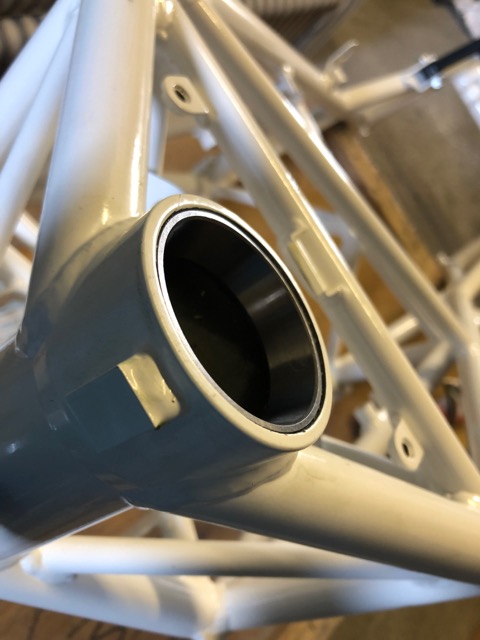

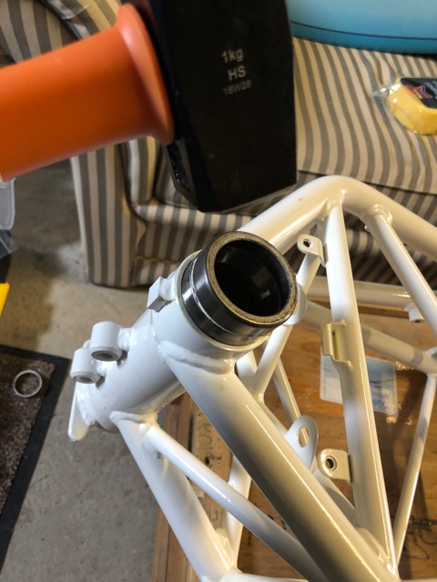

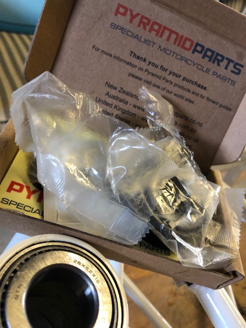

  12. Also on the 'to do list' was fitting new head bearings, whilst the lower stem bearing refuses to leave the steering tube at least the new bearing cups have gone into the frame.
    I sourced new bearings from Pyramid parts, good price and good quality plus a speedy delivery!
  13. An overnight stay in the freezer for the steering stem / bottom yoke and 5 mins in boiling water for the bearing and... we now have the new lower head bearing fitted. I used the inner part of the old head bearing to tap the new one into place

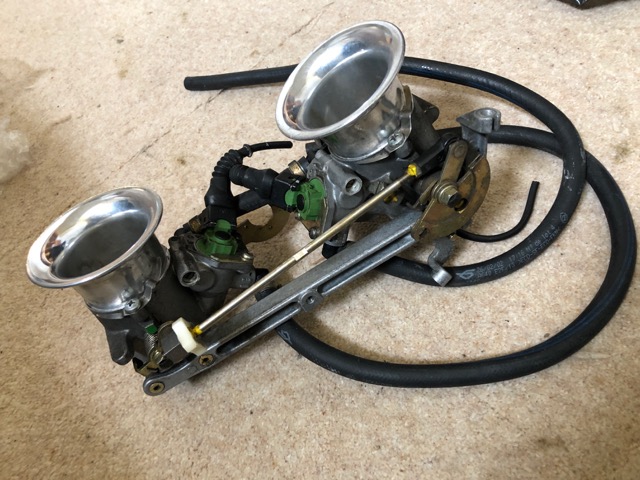

  14. Next snag to overcome... No fuel pressure regulator on the ST4S throttle bodies!
    So the options are to find an 851 part or use the FPR holder from the SSIE (Monster and Supersport) models as that part is still available then just add a new internal regulator into the holder
    Or an external FPR from Delorto / Malpassi etc

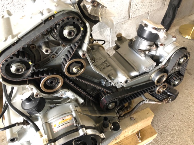

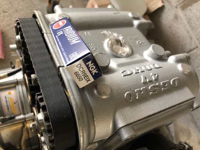

  15. Excellent job as per usual by Steve Jordan Motorcycles - New Belts, Belt pulley bearings and spark plugs fitted, Valve clearances also adjusted and bores inspected.
  16. Decided to paint the belt covers black for now, carbon covers can be done later..
  17. Test fitting Corse carbon breather box just to offset the frustration of other bits taking longer than hoped..
