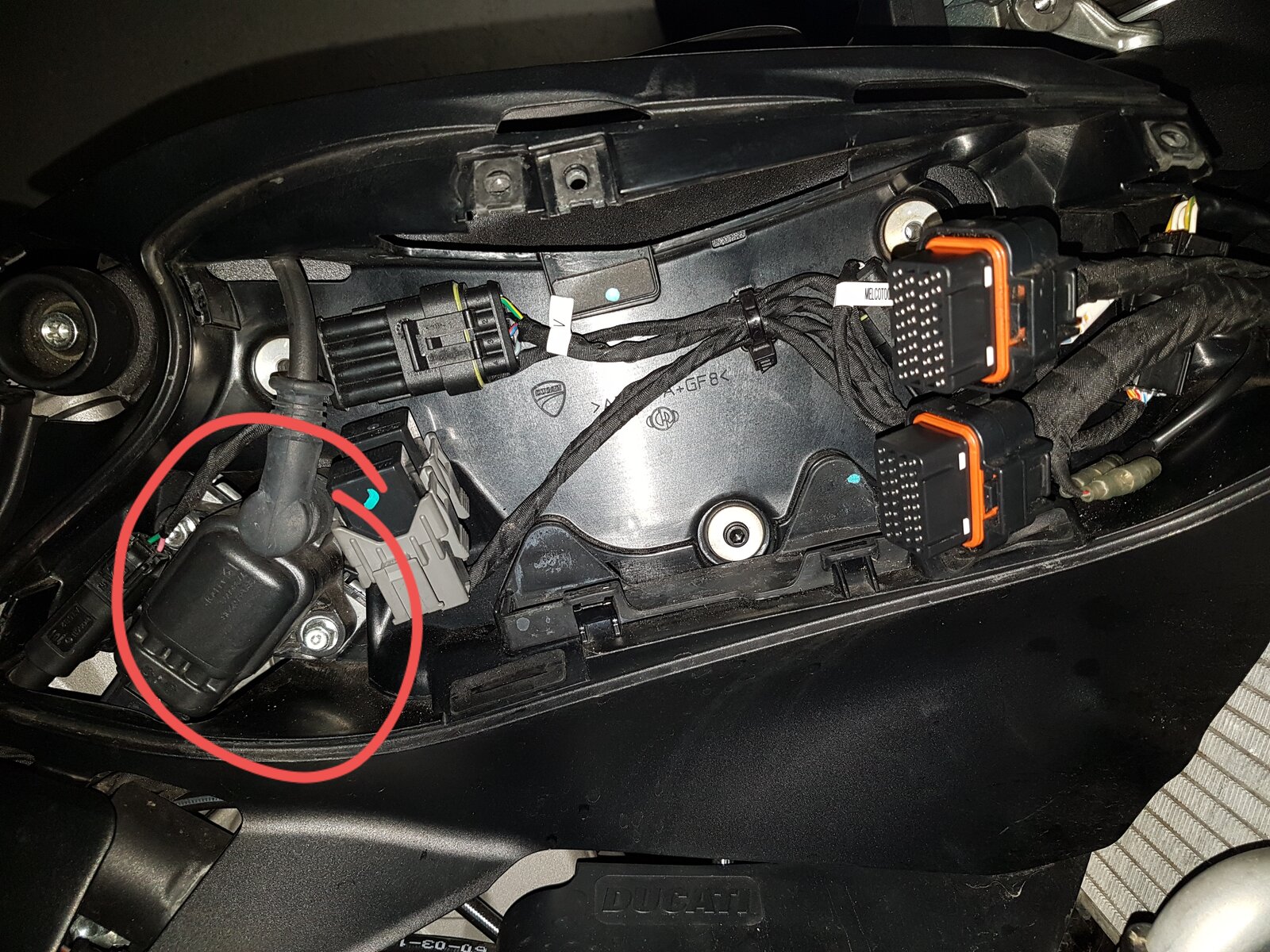

  3. There is a large electrical connector on the underside of air box, right hand side. It’s a MIL type, twist to lock type. They are notoriously tight to do up correctly, and if not clicked in place, can come undone. This can give rise to throttle related errors. Usually rear TPS and throttle motor. Well worth a check
  4. You mean this 19 pin twist connector ?!
    I loosened it and cleaned the pins with contact spray. I still have the same error.
    But I must admit at the same time I replaced the throttle bodies and also replaced this injection wiring harness.
    I then had difficulties remounting it.
    I will try once again. Thank you for this valuable help.

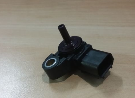

  5. Have you tried the Map sensor?
  6. What do you mean with map sensor ?
  7. The sensor on the side or the cylinder head
    it measures pressure it has a black rubber hose attached to it. They are common for failing and throwing such faults codes
  8. Can you tell me the part number or show me a picture ?
  9. I don’t have it to hand. Look at your bike. On the near side.
    Look at the two heads and you’ll see what I mean.

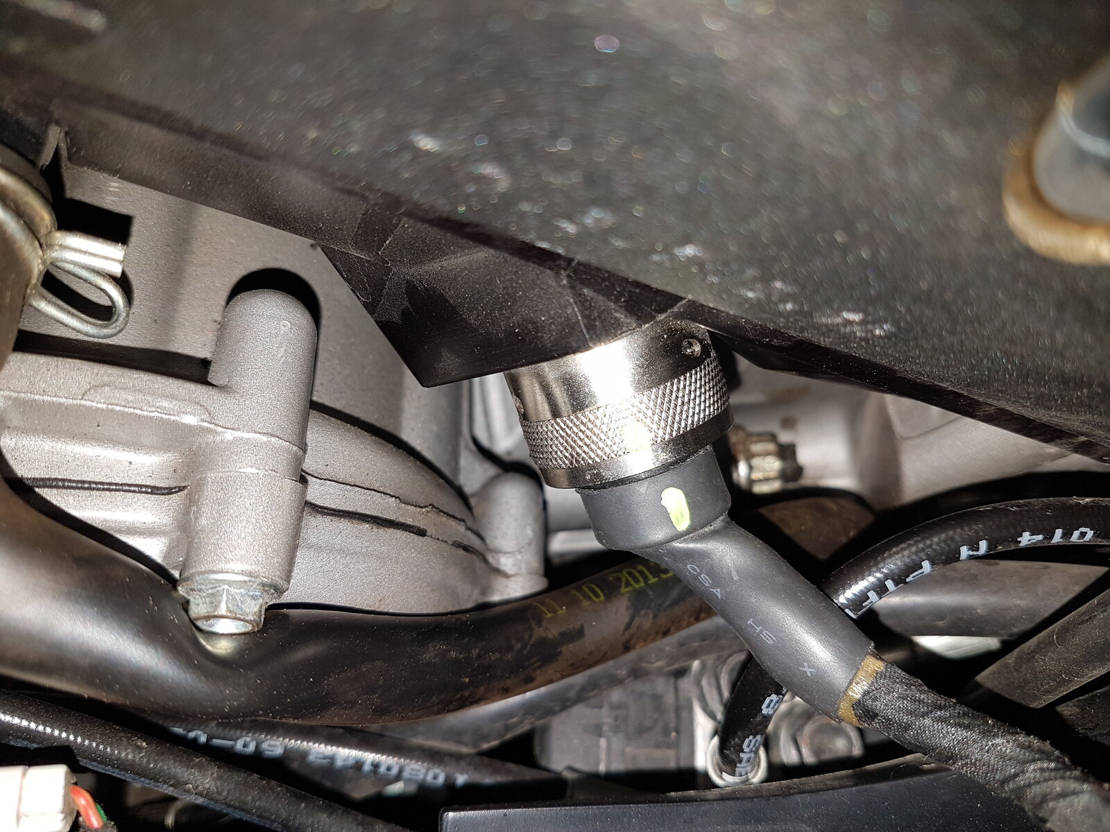

  10. You probably mean this part, right ?
    You mean just replacing this pressure sensor could be a good try ?
  11. No that’s the coil. And on the wrong side of the bike.
    The other side.

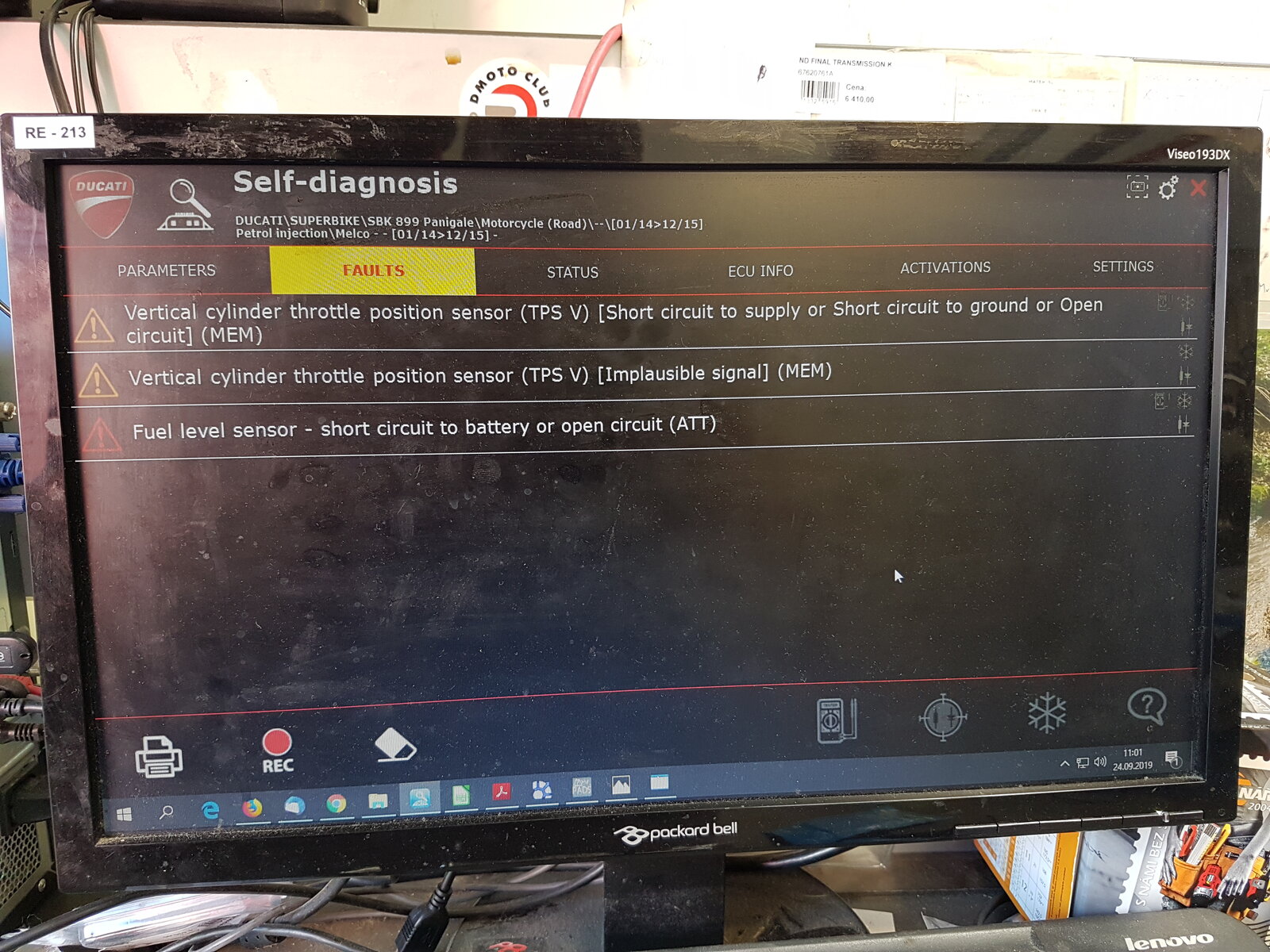

  12. Btw my error code ...
  13. If you’ve already changed those parts. Check that
