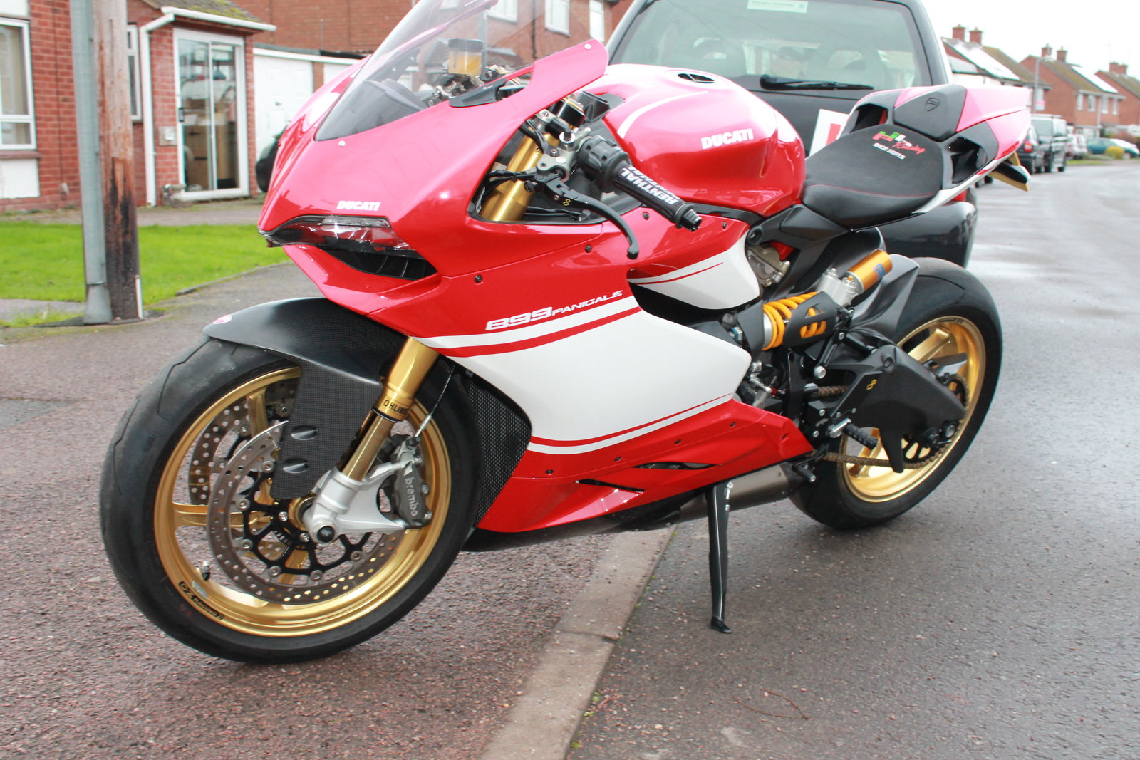

  1. Hi guys, just put a deposit down on a 899 ex trioptions bike for the track and was wondering if any of you run a 899 track bike and how it compares to the 1299?
    I've been running a 2008 R1 on track for 3 years and I've never really 100% gelled with it. I bought the 1299S last year and after a while getting used to it, I love it. Was just wondering how the 899 compares with the 1299 and what you lot generally think of the 899 as a track bike.

  10. I know someone selling a very nice example if anyone is looking :)

  15. a Tri options bike that has not been raped of all its goodies will make a mighty fine track bike,the only things lacking due to the rules are lightweight wheels,899/959 wheels are stupid heavy,auto blip if that floats your boat.pic whore of the best bike i have owned and i am quicker on track on the 899 than i am with my current 1299.
  16. How does this spec sound? Would you recommend anything else apart from blipper and lighter wheels?
    180 miles on a new engine
    Termignoni exhausts
    Ohlins suspension front and back
    HEL Braided brake hoses
    Lightech rear sets
    Corrilo con rods
    Engine and clutch covers
    Brembo brakes
    Brembo brake discs
    Quick shifter
    Sigma slipper clutch
    Adjustable clutch lever
    Renthal Clip ons
    Steering damper
    Brake lever protector
    Race Screen
    Quick action throttle
    Rain light
  17. add the wheels and you're all the way there :upyeah:
  18. You may have trouble with the termi on track...
  19. Sounds good but as mentioned panigales struggle with noise limits.
  20. Custom baffles may be needed.
