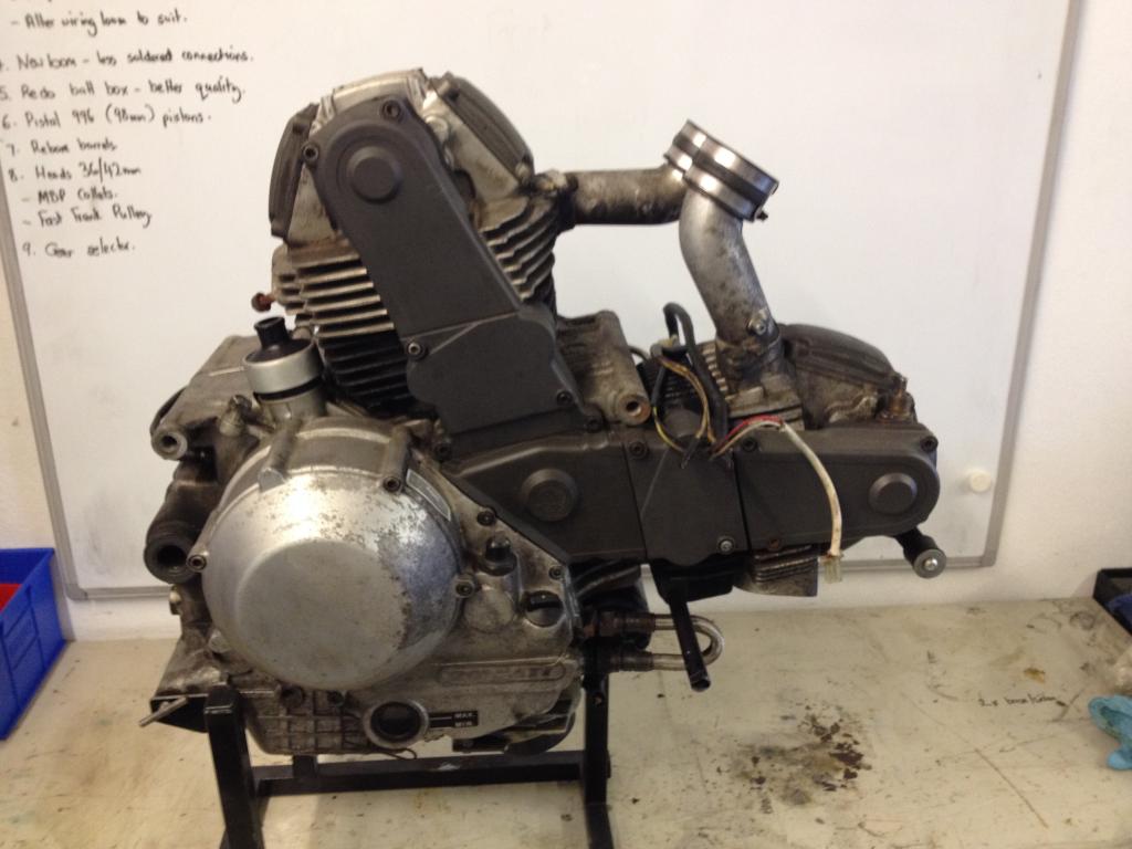

    Always wanted a cafe style racer, used to love the look of the old Triton's and having seen the Norton cafe racer (Nicest bike at the NEC IMHO :upyeah:) I've decided to cobble together all the bits I have been collecting.
    900SS engine (Cheers Imola) currently stripping down then painting. 900 I.E frame (Cheers Gillan), monster 696 swingarm, carby tank (Would love a Norton style tank....maybe later???) Radical seat, stubby end cans with either monster headlight or V-rod.
    Cheers Pablo

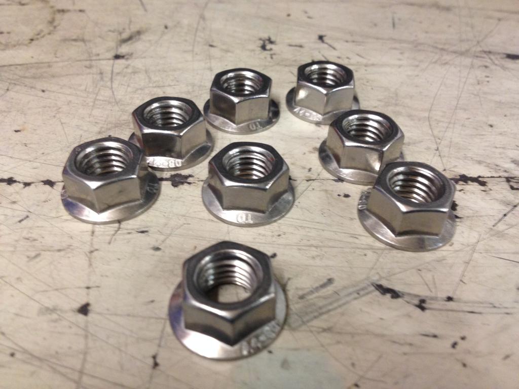

  6. Howdo!!

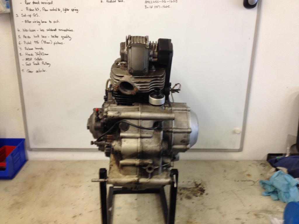

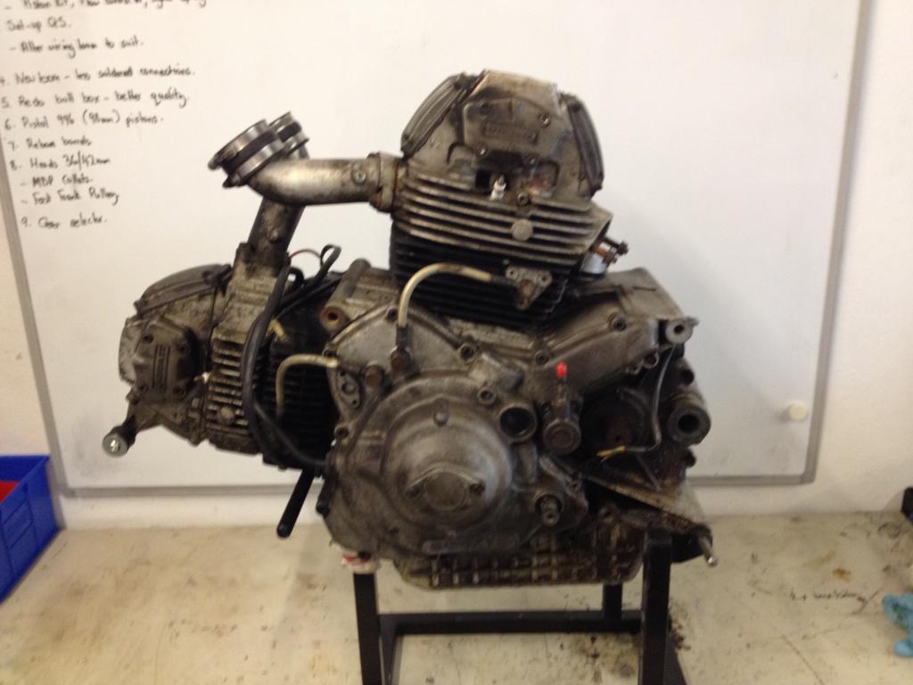

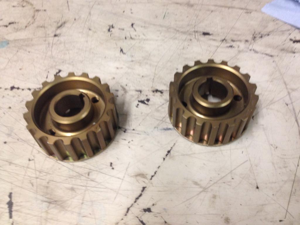

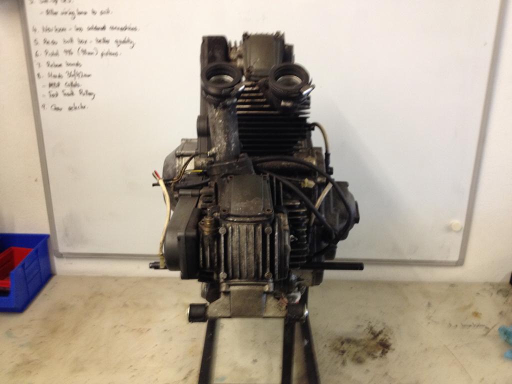

    Well drilled out the crankcases to accept the 12mm ST3 engine bolts. Rear cylinder off and just cleaning up ready for paint and shimming (Good job as one of the half rings had broken - so all gaskets and stuff ordered - Cheers to Nelly@Cornerspeed).
    Dragging all the boxes out to see what I have and haven't got :rolleyes:
    Bidding on a 600 flywheel & may fit a set of JE pistons while it's in bits :upyeah:

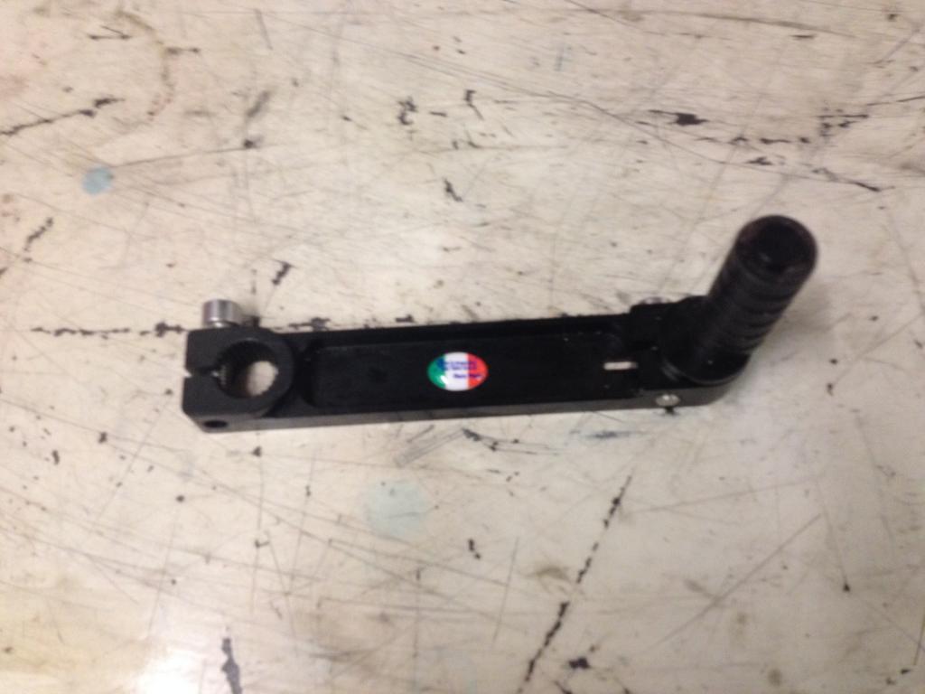

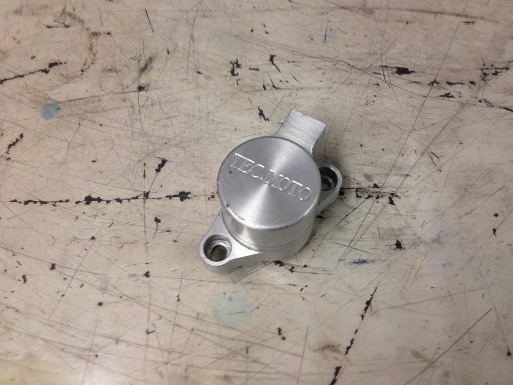

    Few bits...............

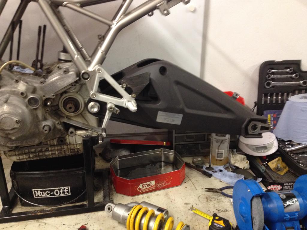

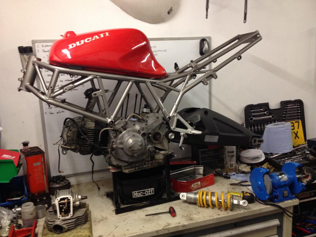

    Well got the Monster 696 swingarm and it slots straight on to the back of the 900SS engine, will need to machine the actual bolt as it's to long (Normally has the footpegs connected).
    Initially when I Mk1 eyeballed the fitment I thought the only mod I would have to do is alter the swingarm fixing point on the frame, However it's to far offset.......bugger.
    Rear section of frame was due to be altered for the Radical seat but looks like a bit more work maybe required :rolleyes:
    Not sure if the cast swingarm can be welded???? Therefore moving the swingarm point across?? Will be touching base with Steve Bailey :upyeah:
    I need to measure up a 696 shock and take a few pics of the top section of frame.
    Will also need to swap out the rear wheel bearing for 25mm....if possible.
    Just stuck the SS tank on to have a look.
