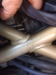

  2. Good Luck with restoration, i'm sure much help will be along soon. There's much to be consider so I won't even start but I see you are getting frame painted so take time to carefully study the cruciform area on both sides of frame for hairline fractures (as below) as now would be the time to repair. It's rare and more likely to occur if the two long engine fixings have been left loose for some time.

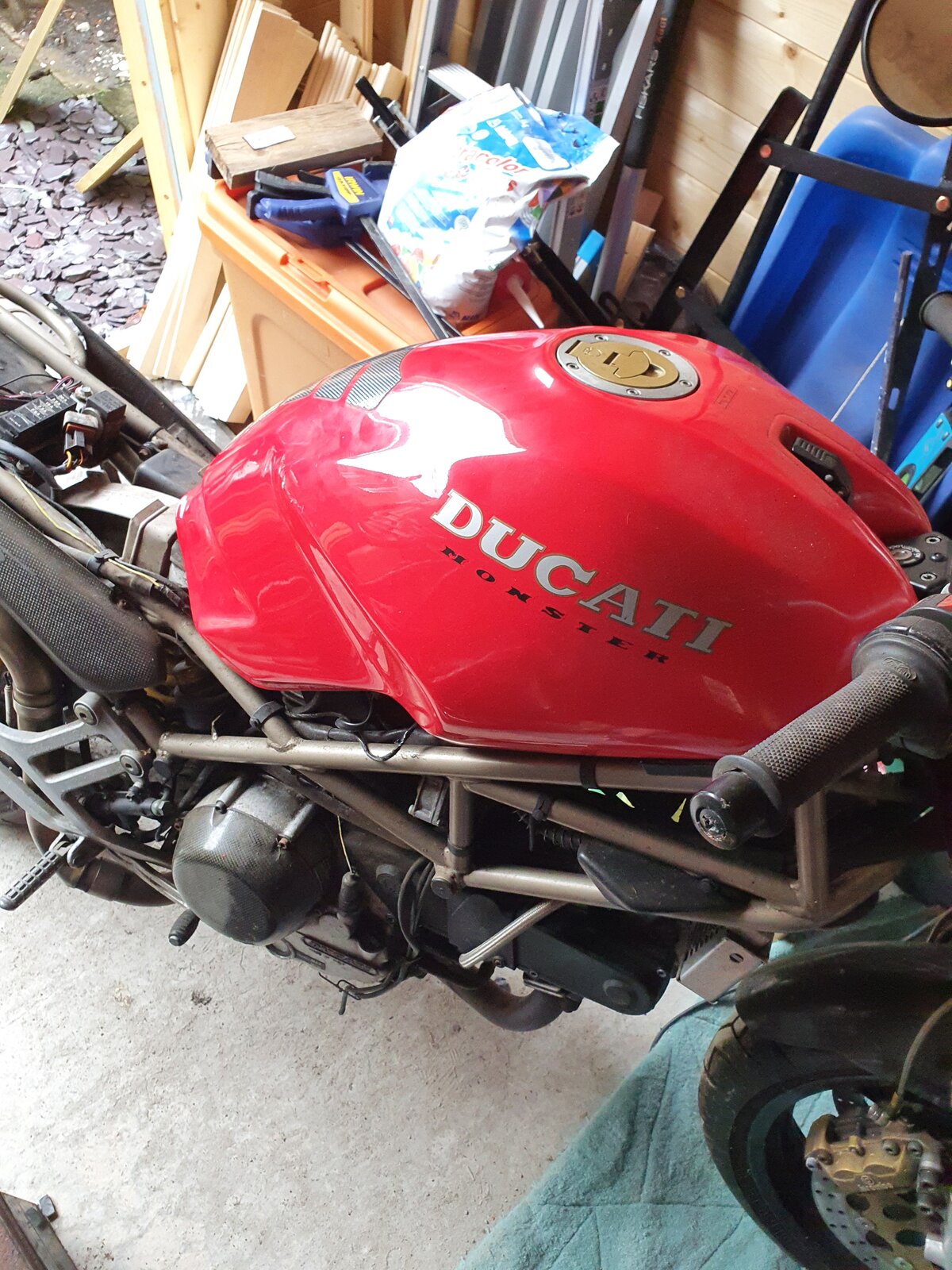

  3. Ahh. Will do. Nice one thank you.

  6. Thanks guys. My mate isn't too bothered for standard just wants it to look nicer and to sort the broken studs on the engine. I've had a look at the frame and no signs of cracks but I'll take the paint back and have a good look. Welds are a bit toss so no wonder they cracked around there.

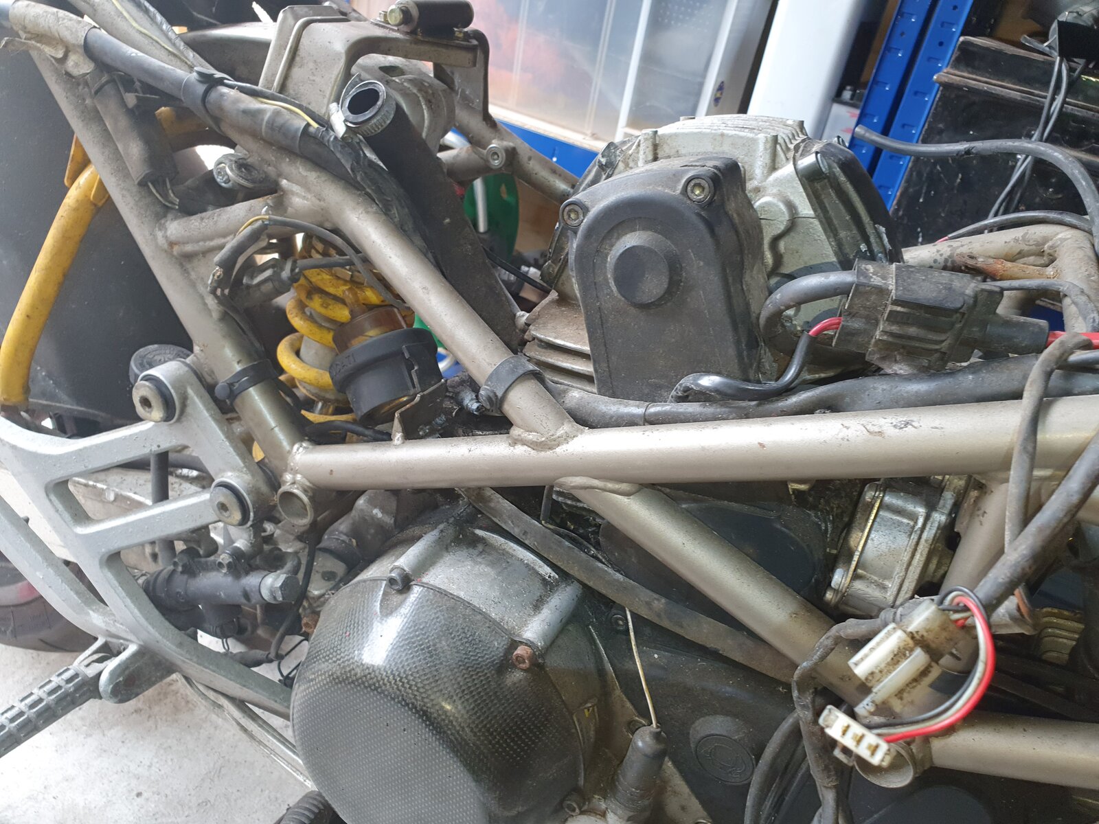

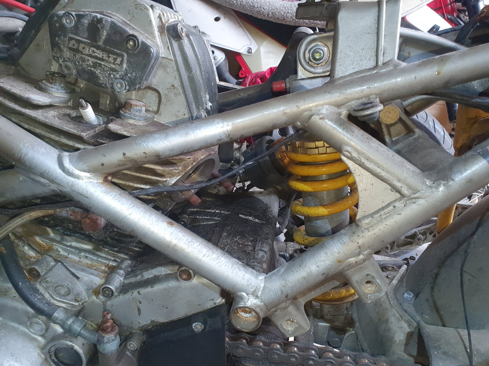

  7. 20200825_092011.jpg 20200827_130615.jpg 20200827_130720.jpg A few photos for you.
  8. There are some original early bits there, but I see what you mean about the paint needing smartening up!
