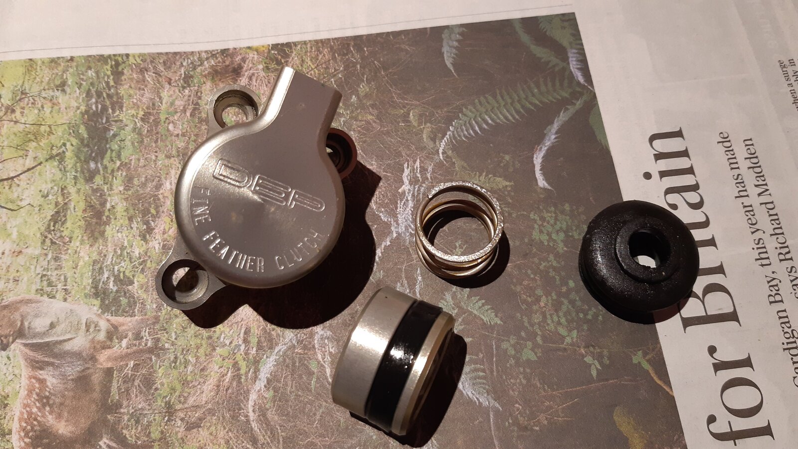

    My 1993 came with this aftermarket slave cylinder fitted - DEP. Outwardly very similar to an Oberon one. Very good quality CNC'd.
    Shortly after fitting a new clutch hose it has developed a leak and deposited all the fluid outside my garage door!
    I can't find any info on this brand / manufacturer on the web? Piston is dia 30mm. Anybody recognise this and know if / where I can buy a new seal?
    Otherwise it will have to be a completely new one!
    thanks
  2. Not seen one like that before but interestingly i searched DEP fine feather clutch it comes up Oberon, that and a very lovely feather clutch bag:laughing:.
    #2 WAYNE, Aug 27, 2020
  3. the fact that is says fine feather clutch on it would suggest something from the far east I think.
    You may well find that someone like simply bearings will have an seal which will fit it once you send them some photos of said seal and some dimensions.
