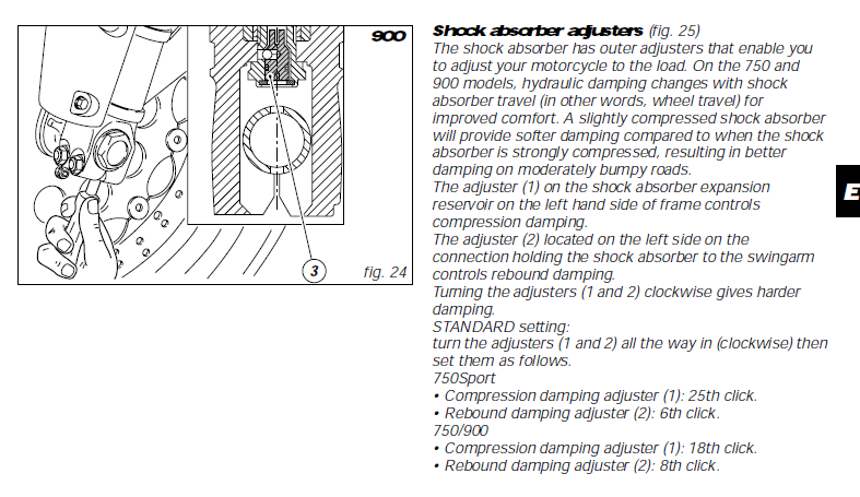

    Handling is (as expected) on rails, but suspension seems a bit on the hard side. I weigh 200 lbs with gear. Easy to adjust? Where should I start? But at the end of the day, I love the stability. Would it be worth sticking a Nitron on it,?

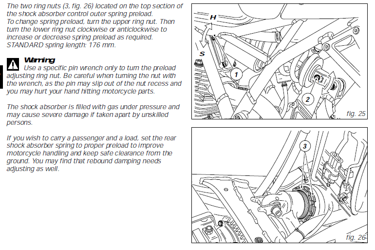

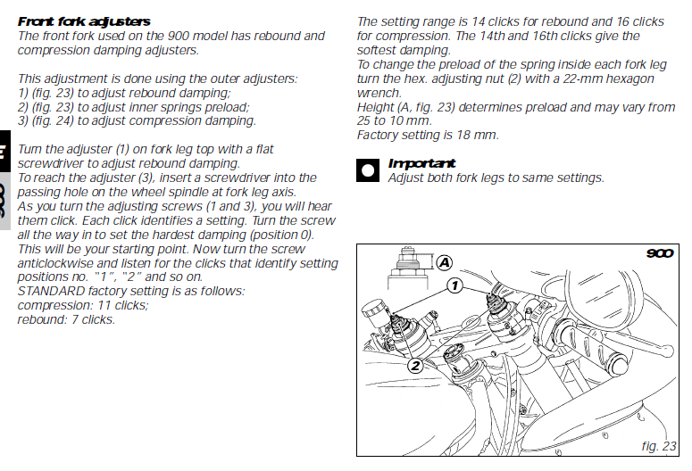

  6. I seem to remember setting my front suspension to the softest damping setting for compression as it tended to ride in to undulations on the road, rather than ride over them - Helped quite a bit. Also jacked up the rear suspension as it tended to squat under hard acceleration causing front end wobble.
  7. I agree about the "on rails" feel to the handling, but the hard ride does mean that there's a risk of running off the rails if a substantial bump is encountered, which in England is a strong likelihood.
    I've never got around to changing my fork oil but have always assumed it could make sense to go for a light grade like 5W (I've a feeling that 7.5 is standard). There's plenty of info on fork oil changing if you hunt around, but it is frustrating if you don't have any manuals; I'm not sure where these days they can be obtained, or at least obtained for free. The Ducati website used to offer a good selection of owner's handbooks, but these days they only seem to go back a few years (I am pretty sure I acquired my PDF copy from the official website, quite a few years ago, FoC).
    Re suspension settings, here are some basic details from the handbook:
    There are various opinions about the way the Showa forks work, and the quality of the internals (not the same AFAIK as similar looking forks on 916 etc.). For instance:
    https://www.ducati.ms/threads/showa-fork-rebound-damping.333977/
    I think I concluded that there may be some truth in the idea that softening the rebound damping also softens the compression. Also, I reduced my rear spring preload at one stage and I did that with the shock removed from the frame, which is something that has to be done if you want to check the rear cylinder exhaust valve clearance.
