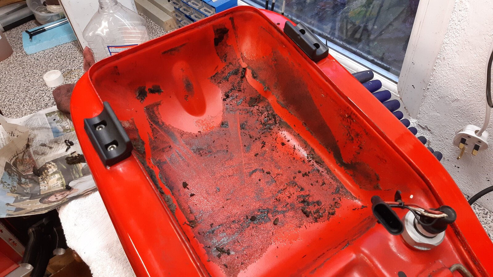

  1. The foam stuck underneath my tank has crumbled and started to disintegrate (found lots of bits inside the air box!). It has taken me ages to remove the horrible sticky glue residue left behind - pic below is before I removed it. White spirit was the only solvent to actually work. Job from hell :-(
    Has anybody replaced theirs with just heat reflecting foil instead of foam? I assume it was fitted to deaden the intake sound?

    Nasher..

  9. would say it was there for maybe 2 reasons to kill intake noise from the airbox and maybe antivibration noise on that section of the tank as its a large flat area it could maybe resonate with vibration
    not that ducati's vibrate do they hmm
    you can get different types of sound deadening sheets on eBay mainly designed for cars but does the same did see some 12mm foam sound proofing on there if you really want to replace it but honestly i wouldnt bother the induction roar is lovely why mute it
