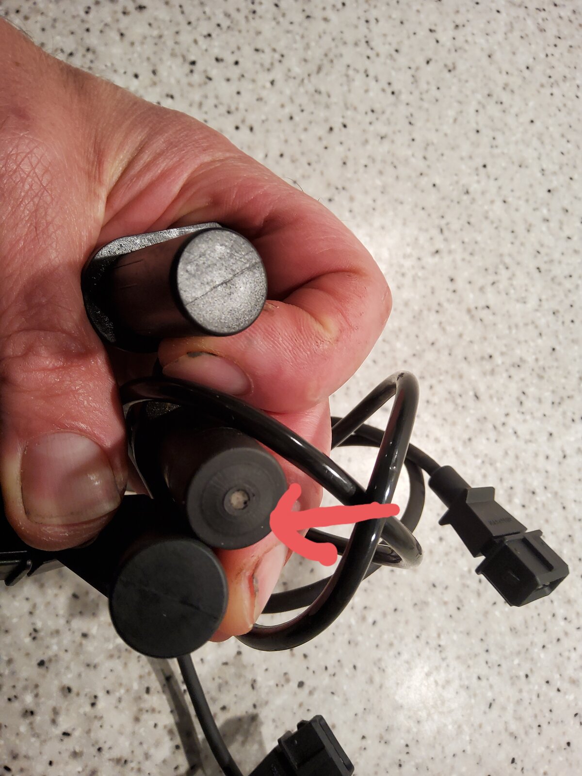

    Appears I managed to purchase a faulty crank sensor
    Retrieved the old one from the bin, put it on bike runs great till the sensor gets too hot.
    Put the new one in the bike runs great till about 6500rpm
    (new sensor wasn't even from eurocartwats!!)
  17. It would appear that not all crank sensor will work.
    The orginal crank sensor is a Bosch 0261 210 124
    But a cargo sensor wont work correctly, neither does Intermotor sensor wbich are both supposed to be a cross reference to the Bosch number.
    On closer inspection the center of the Bosch sensor has exposed metal part, maybe this is the difference?
    They are listed to fit a fiat and fiats don't rev to 6500 to 7000 rpm.
    Can anyone recommend a make that works other than an overpriced Ducati or Bosch one ?
  18. Sorry, no ideas beyond the ones you will have had already - they all seem to be about £50 or more e.g. https://www.onlinecarparts.co.uk/bosch-1149617.htm - never used these people so not a recommendation.
    But that's interesting, and worth knowing, thanks. Is it a different length, or is it just that end? Shorter would explain it, even by a millimetre or two.
    I bet some of the non-Bosch ones are actually a Bosch part in different packaging, but it's knowing which ones, and which ones are Chinese copies.
