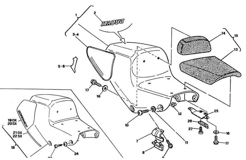

  1. As title
    Looking for the the front two brackets and rubbers and both seat cushions for the single seat unit,
    I know they are still available but trying here first incase someone has any parts kicking about they don't need.
    Part numbers.
    13,14,25,26

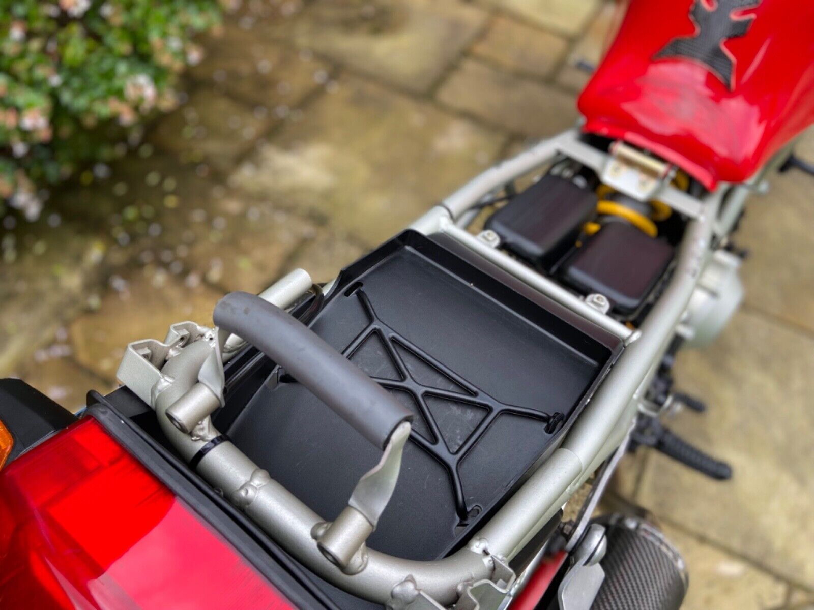

    I will order front brackets and seat cushions from Motorapido, as for rear ones there is no fixings and wondering if i really need them, I've seen a couple of ideas on line and this one on ebay has a good idea for some central support .
    It will be a while before its mounted on the bike as strip and rebuild first.

  4. Roadtrip,
    Not seen that set up, good idea.
    I bought a second hand standard seat unit and was going the try and cut that up to fix into single seat unit to help with support (when I get round to getting one).

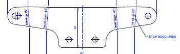

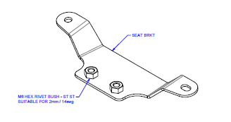

    You may want to buy and save yourself the hassle but if you want to make the brackets I have a .dxf or .pdf profile a few other members have used.

  5. Thanks Gaz
    It looks the best idea I've seen.

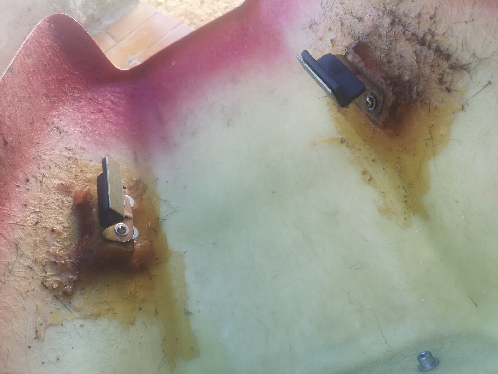

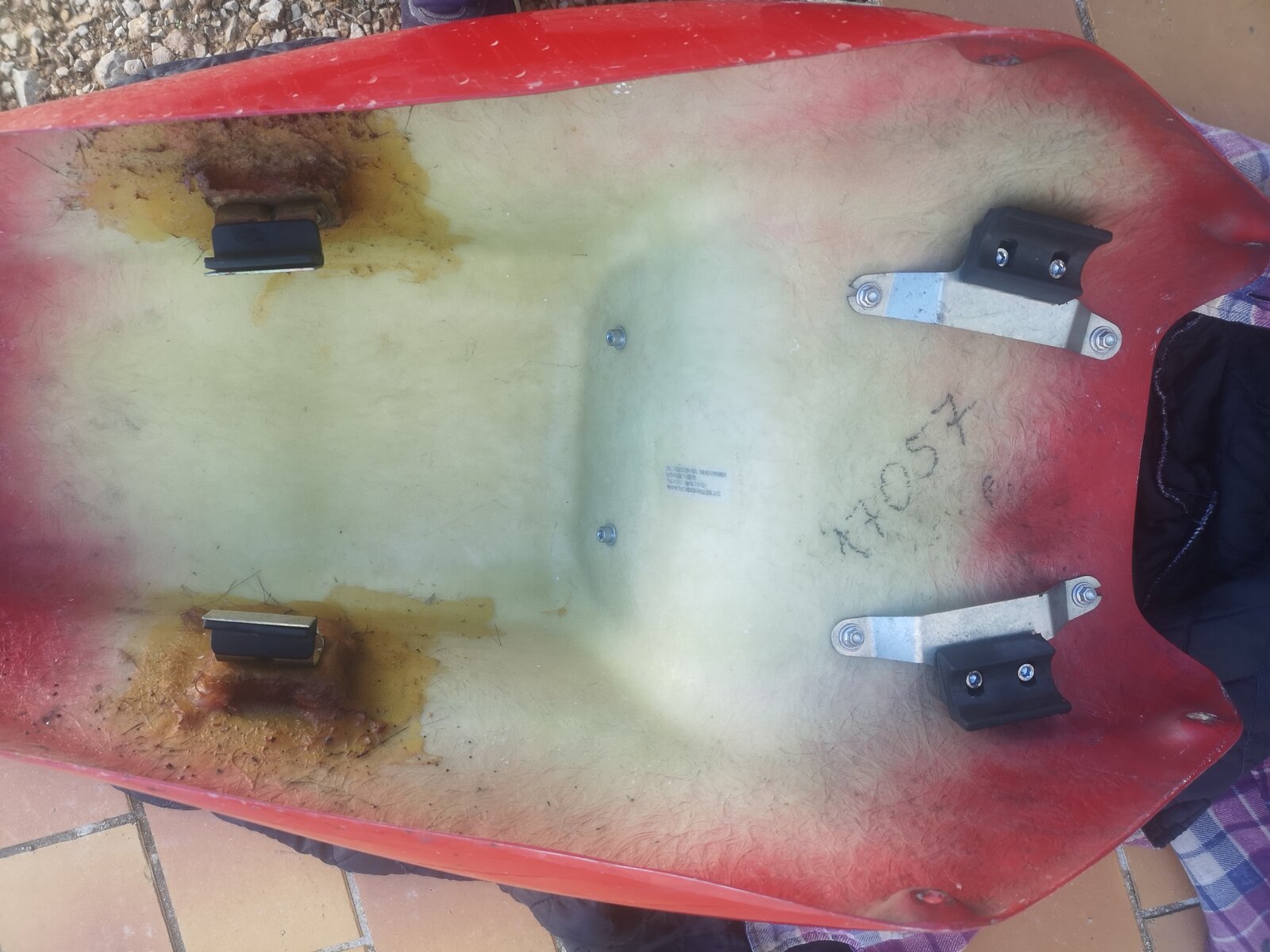

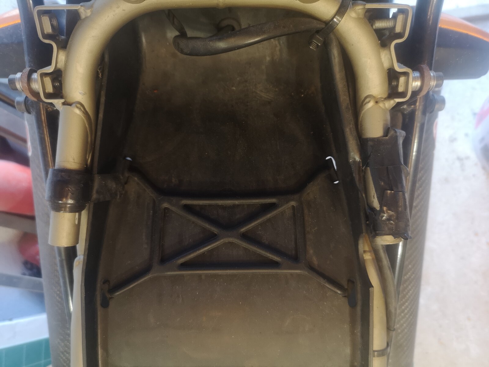

  6. I glass-fibred in 2 small wooden blocks to support the rear, using OEM brackets and rubber pieces...then some tape on the short parallel tubes to centre and locate correctly.
