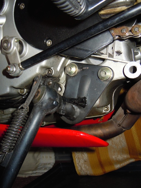

  2. It's probabely not much use/help, but this is my '94 750SS. I thought it might have been the same, but clearly it isn't. However, it does look like it might work even though it uses slightly different mounting points.
    I did machine the post off the top of the side stand mounting bolt, (the one that make it spring back up when you take the weight off the bike), other than that it is standard.

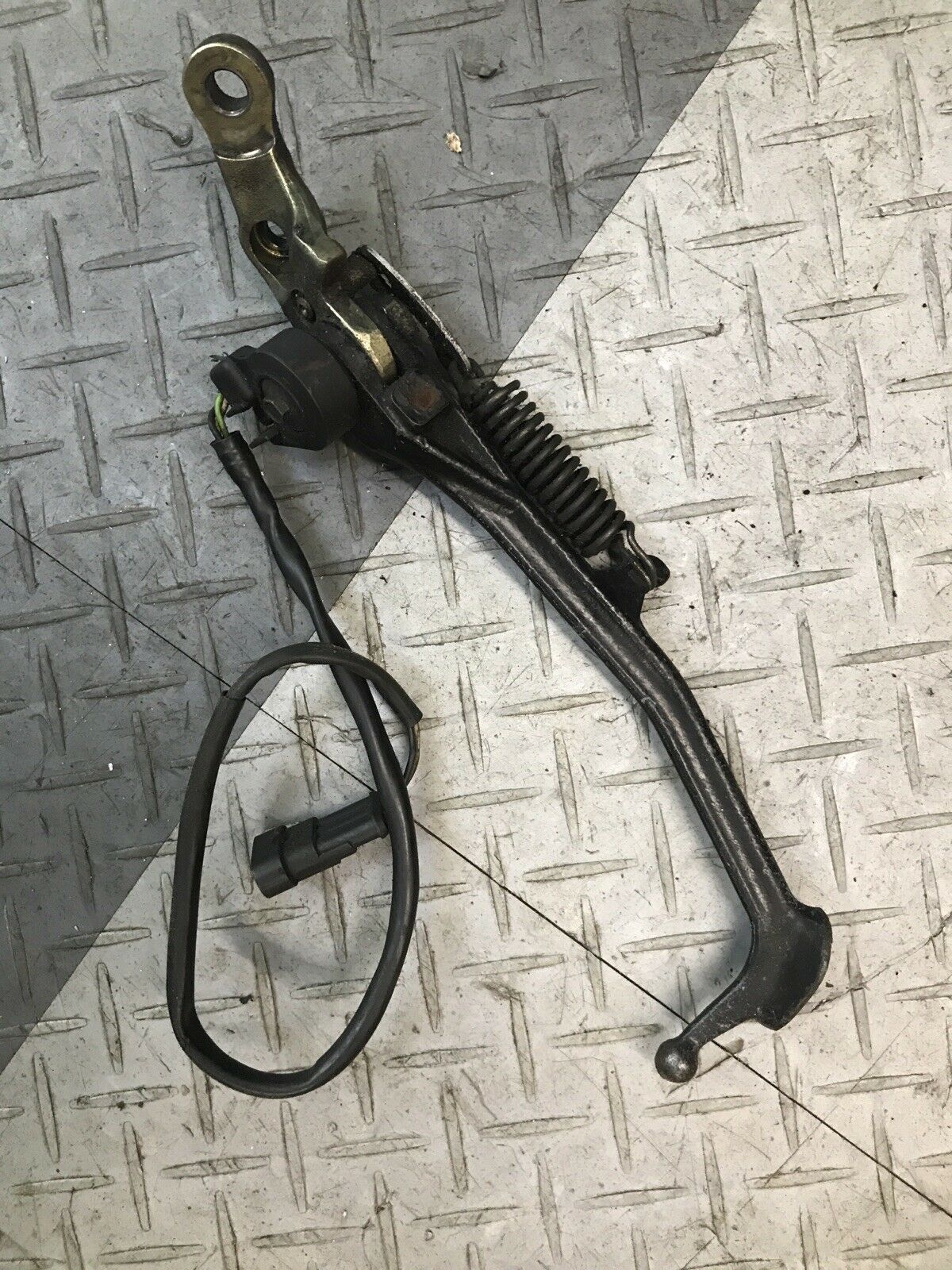

  4. I have a full sidestand assembly that came off a Carbie 900SS.
    I will attempt to get an image of it at lunchtime, but from memory it looks like the one Alan Williams has shown.
    Mine might be for sale, just need to check I can find it and see what state it's in.
    Nasher.
  5. Thanks for the pics @CAT3 and @Alan williams - I think can see what I’m missing from AW’s pic

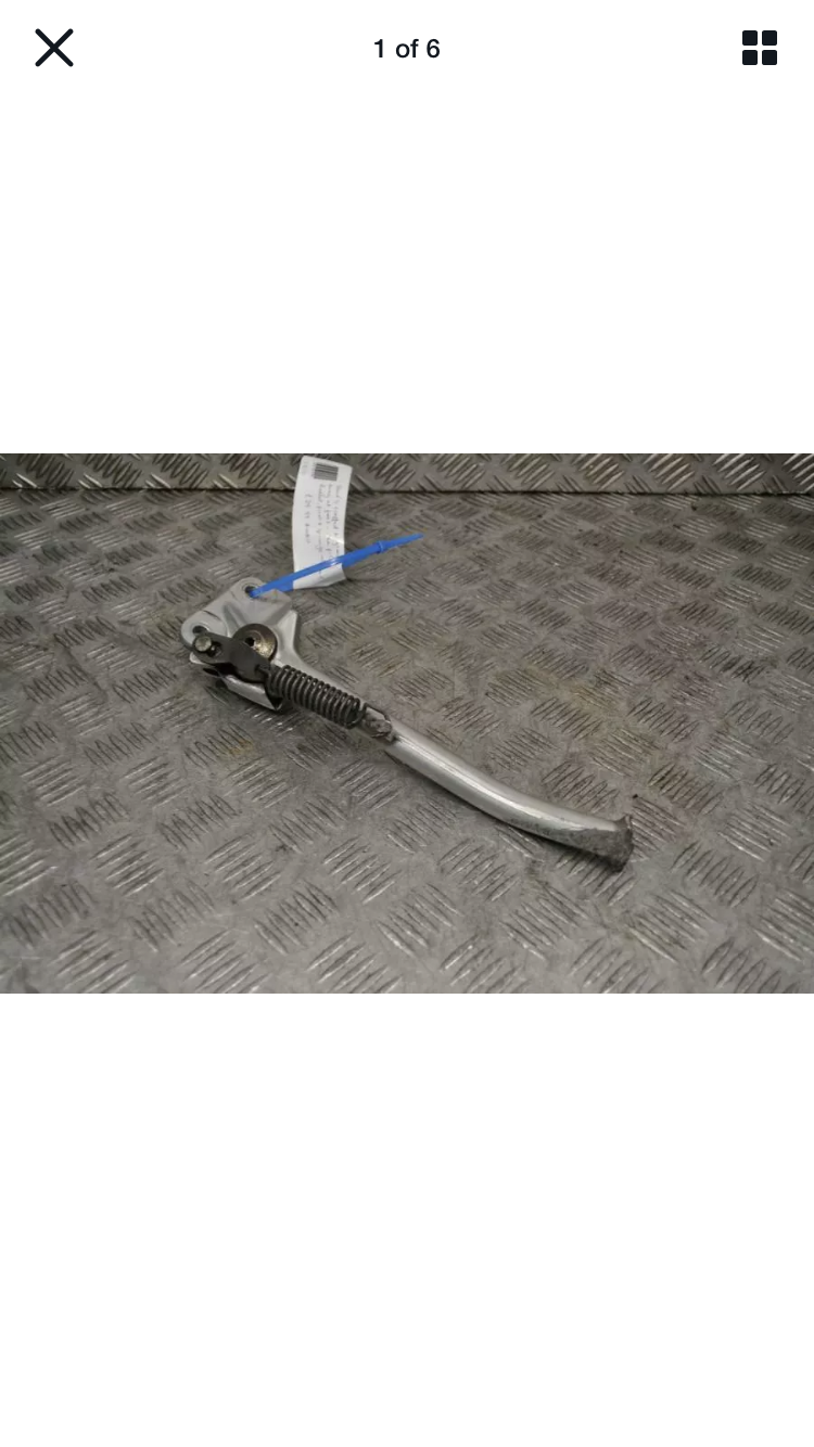

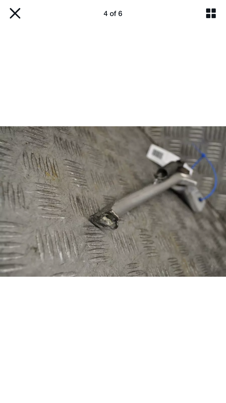

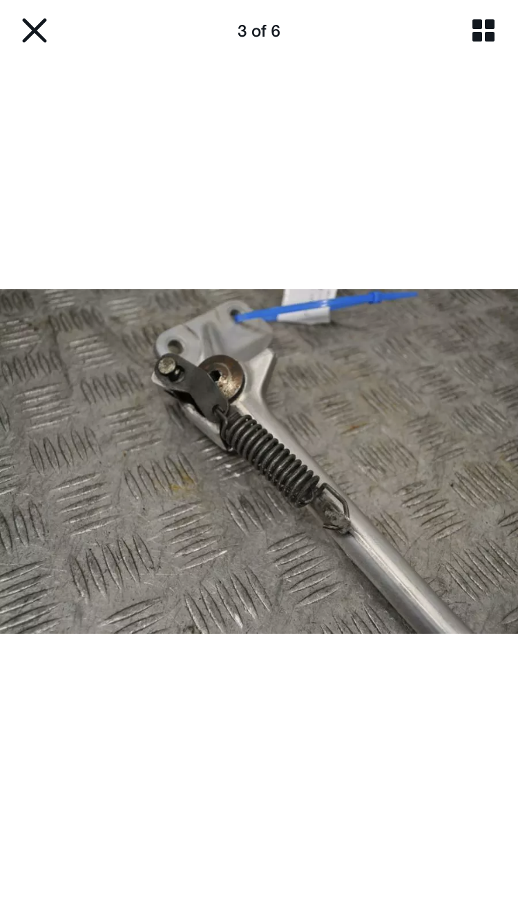

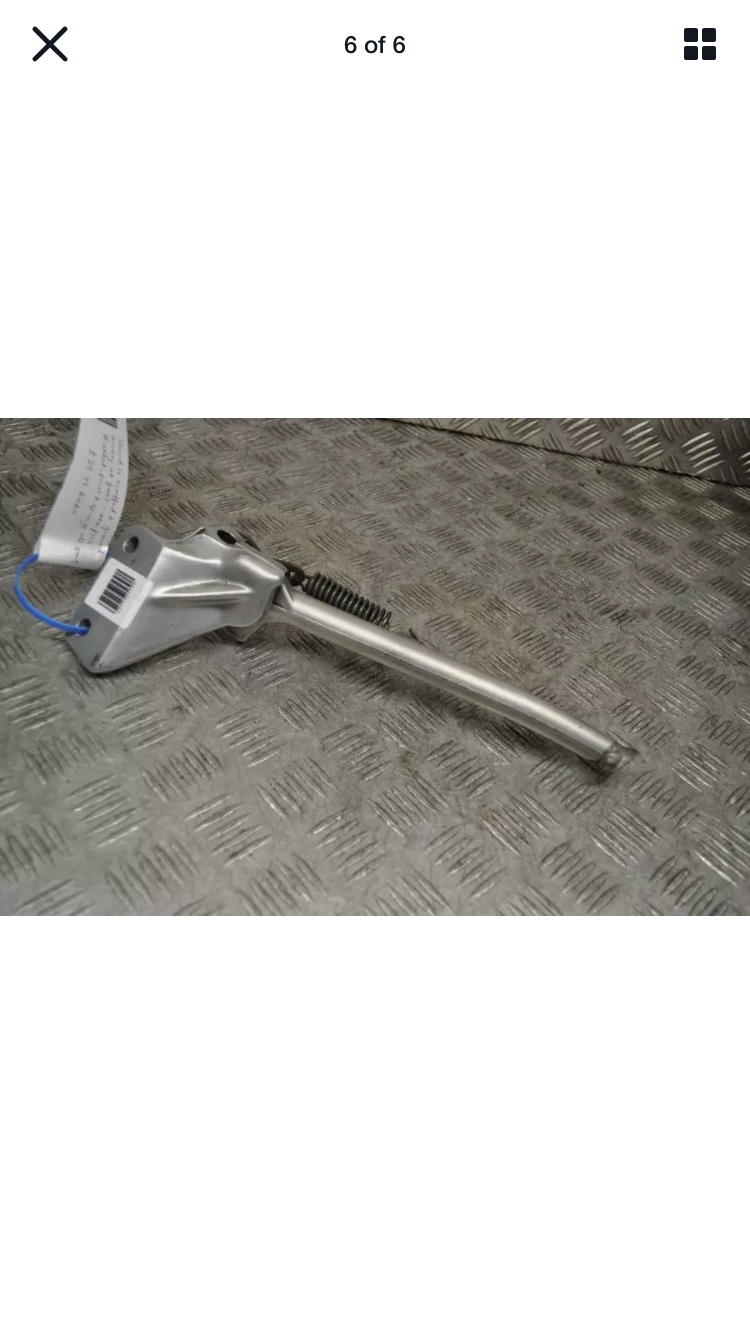

  6. There’s one on eBay but I was told it’s not the right one. However, looking at @Alan williams photos I’m not so sure now.
    Ths stand itself has been damaged but I know someone who has one. I’m more concerned with making sure I have all the correct brackets and fasteners tbh
    Thoughts?

    I’ve looked on eBay at Monster side stands and you’re right, it’s almost certainly one of them and not a Supersport item.

  11. That’s a Monster stand, bracket and spring and the bracket seems to be identical to the one which is still attached to my bike

  17. I think I’m sorted now Nasher, but thanks for trying. I’m going to buy a Monster stand off eBay (good spot @johnboy ) and see how I get on.
    Thanks also to @Alan williams and @CAT3 :upyeah:
