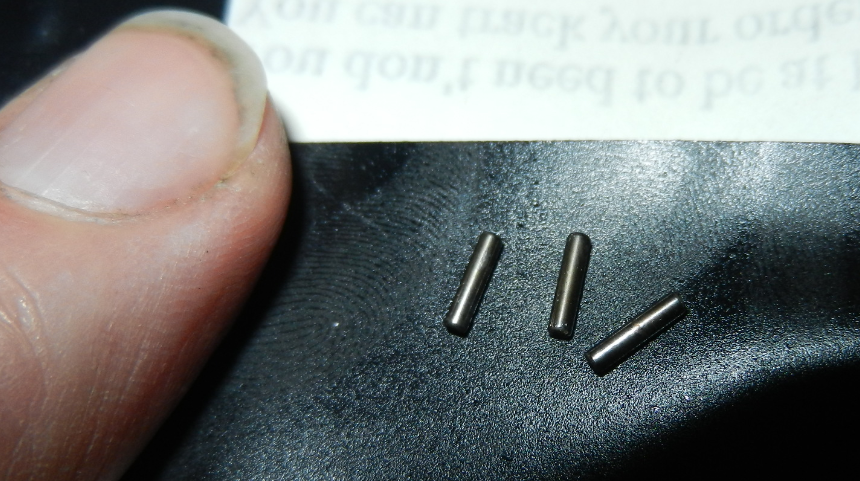

    I removed the clutch pressure plate and these fell out from somewhere - can anyone tell me what they are (and where they should be put back!), I can find no mention of them in the manual and couldn't do a search here because what the hell do I call them? Cheers Pete
  2. They look like the rollers from the pushrod needle roller bearing.
    You will see the pushrod if you have removed the pressure plate.
    The needle roller is located in the clutch hub where the rod eminates from the centre of it, behind the little seal.
    You need to remove the seal and remains of the bearing cage and chuck in the bin.
    Press in new bearing and seal.
    Grease rod.
    Reassemble clutch.

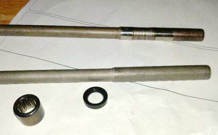

  11. I cant find the part numbers this minute but I'll look. In this photo you can see a new needle bearing and oil seal, (I remember they were quite cheap parts) as well as a replacement clutch rod (about 35 euros) because my old rod (shown at the top) was badly worn - presumably because my old needle bearing had collapsed completely and some of the needle rollers had 'escaped' from the cage. Pete

  13. No, I found rollers from the collapsed needle bearing when I removed the clutch cover. None went into the actual engine but it's best to be careful when removing the clutch pushrod, I'd advise pulling it out carefully from the clutch plate side if you're worried about pieces of the needle bearing going into the engine. I had to get a special tool (Ebay) to remove the clutch plates and basket, but removing the actual needle bearing is a bit of a pain, it's a tight fit and hard to get hold of the bloody thing! I tried heat and lots of perserverence before it suddenly came out. Good luck with the job it's a pain but not impossible. Pete

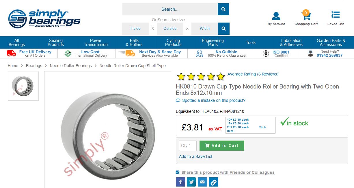

  15. Hi Pete, i found the parts: HK0810 is the needlebearing, oilseal 8x12x3

    One word of warning ... I'm sure I remember there's a lip in the shaft which is hard to see but the needle bearing sits against it so it's hard to get behind the bearing even with a blind puller. I managed to use a cut down allen key and got it into the broken cage of the bearing then heated the whole area up a bit and pulled, I think the heat helped (but don't use too much heat obviously!).

  17. In my opinion there's no need to use the Ducati original needle bearing - bearing suppliers sell them (same part number you posted above) for only a few pounds. Similar story for the oil seal, easy to find and cheap. Pete
  18. Yep, as usual, find the bearing numbers and order elsewhere, saves Ducati tax
  19. This is the needle roller bearing I bought, seems good.
