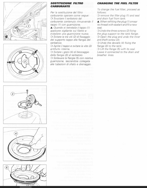

  13. As you'll have deduced there is one additional screw to remove, only accessible after the fuel cap has been opened.
    The section in the manual which discusses fuel filter replacement has a diagram which shows that... ("anti-theft" screw !).

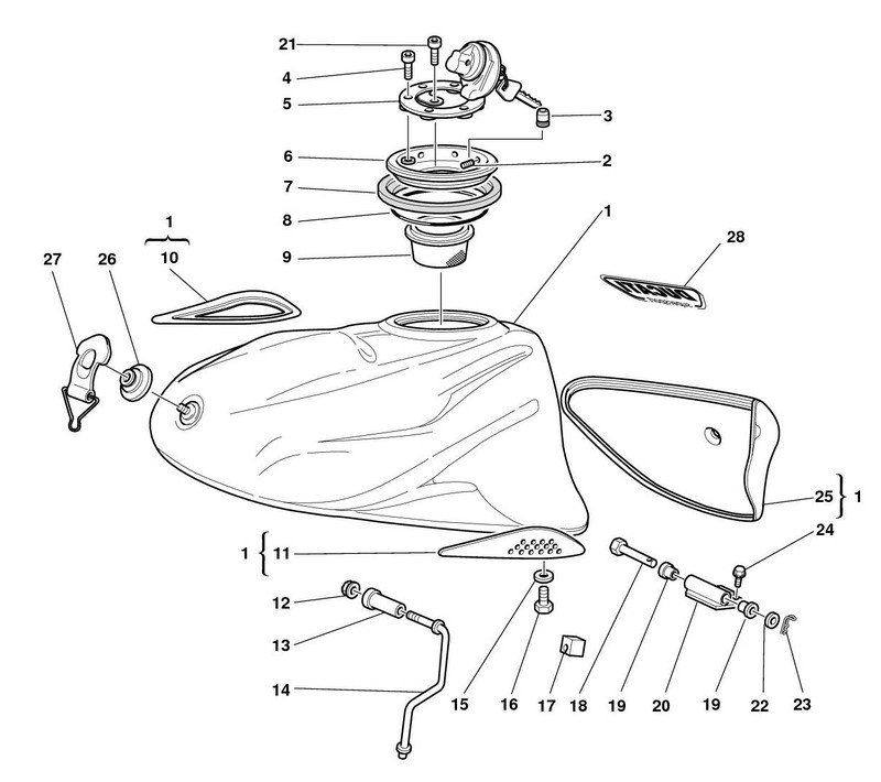

    EDIT: When reassembling the tank + gas filler cap, I'm definitely NOT going to replace that "anti-theft bolt" (#3 in the diagram above) - if it wasn't for that silly bolt, my bike would have been back on the road 2 years ago already (TBH it also took a massive effort from a Procrastination Expert to just let it sit for that amount of time too). It is parked in my garage year-round anyway.
