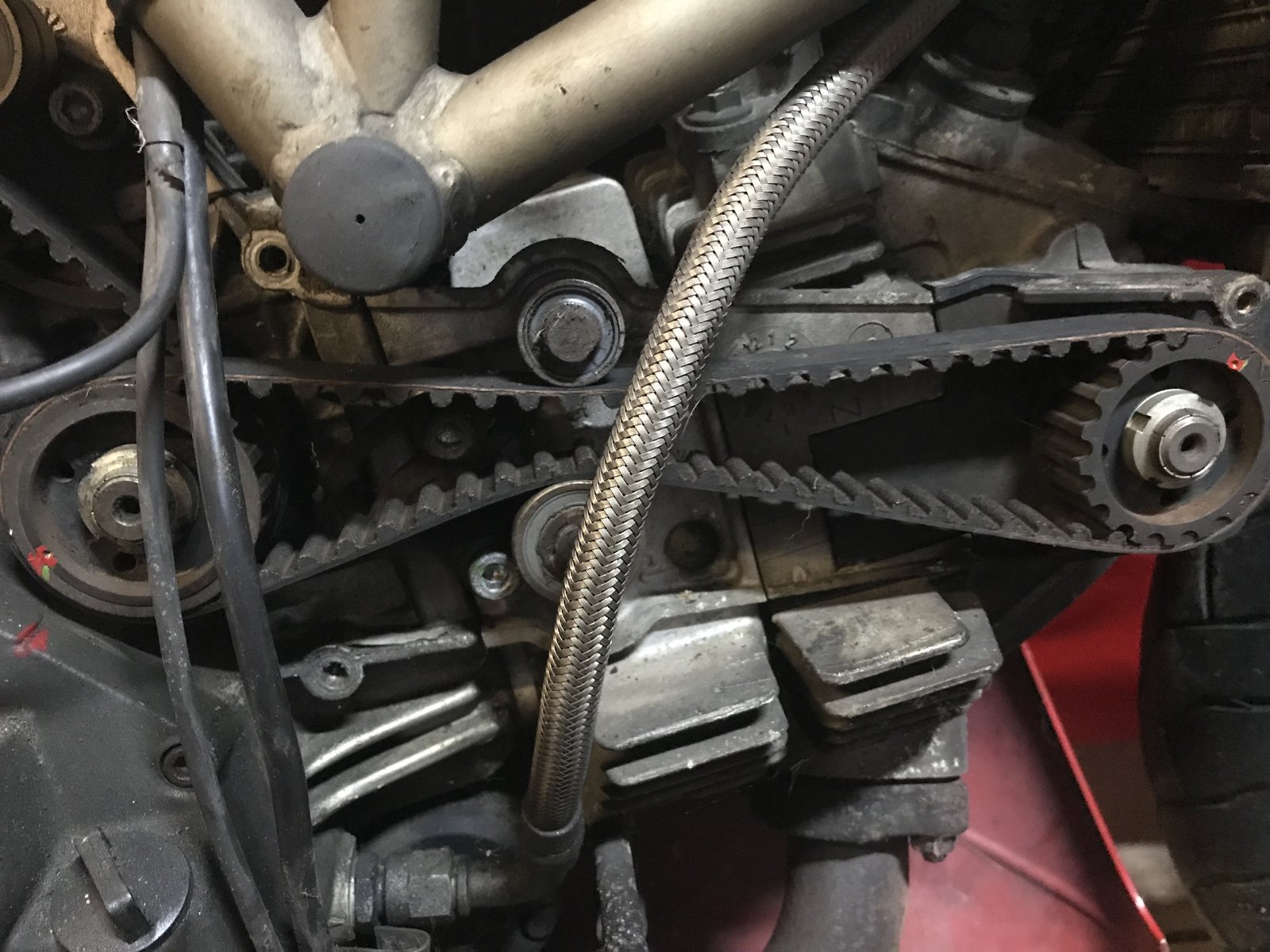

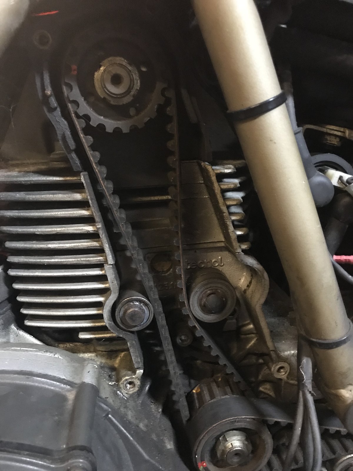

  1. Thought I’d start this as much for myself as anything. But would be good to get any helpful comments as I go.
    Going to be a slow process due to lack of time but I’m servicing my 900 for the first time ( never done a Ducati before)
    So took covers off to look at the belts
    Should there be much movement in the belts, currently I’d say at the slackest point they move about 10mm ?

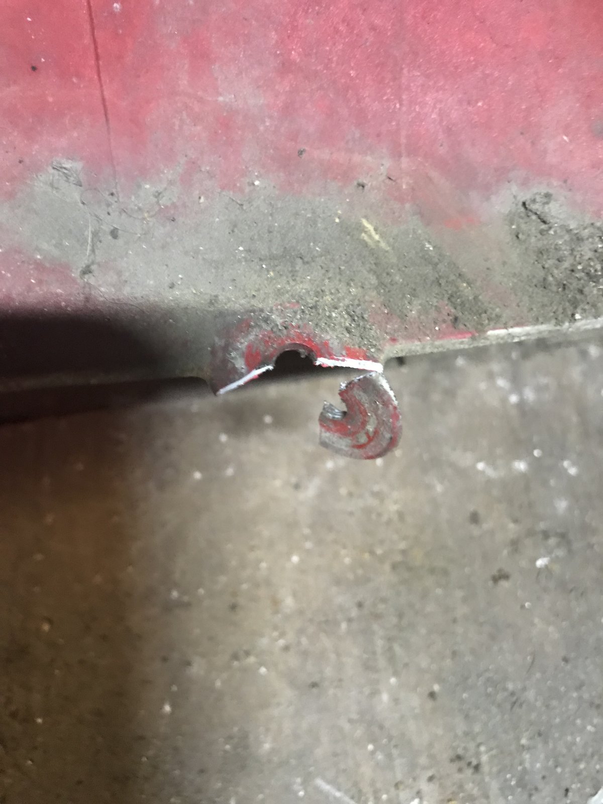

  2. Not sure if I’d did this or if it was like it before I started,
    Is it repairable ?

  3. Firstly the belts, that seems pretty slack. How old are they as they stretch over time. They are pretty easy to do, loosen, remove, put new ones on then tension using allen key method (its not as exact a science as some might have you believe) alternatively you can tension more precisely using Gates app ( measures frequency whilst you twang the belt).
    As regards the lug, itll be fixable, although its under stress that part so Im not sure what you would use to make it strong, prehaps some mesh with fibreglass. Its a weak point.
    If you need any other help just pop questions up its relatively straight forward servicing a 2 valve

  5. New-fit and in-service tension values are not the same.
    For @Exige 's 4v belts for instance, the new-fit tension is, iirc, 99Hz and the in-service tension is 90Hz.
    Just download the Gates CarbonDrive app to your smartphone and you will be able to check the tension.
    I'm sure @Exige will be able to confirm what the in-service tension should be for your 2v motor.
    It's easier to check if you have a plug-in microphone for your phone but it can be done without, it's just more fiddly to get an accurate, reliable reading.

  10. The IE is only a 2V engine, so the 5mm allen key principle is OK - I didn't have to change my belts even after three years, but I did anyway generally at two years.
    You don't need a frequency test for the belts on the 2V engines unless you are right up your own ar*e.
    Ducati simply worked on 10lb tension hence their tool which you can do the same with a simple fish weighing scale.

  14. When I did the belts on my M900 I set them with 45 degree twist (for cars use 90 degrees). Old school but will be fine for 2V.
    On my ST4 engine (4V) I initially set with 45 degree twist and checked frequency with a guitar tuner app. This was after 14 years and approx. 8,000 miles so your 3 years will be fine... :upyeah:

  16. I left my belts for 8 years or so, no prob's, I just checked the tension/condition annually, when removed they could've done another 8 years, BTW belts don't stretch, the teeth wear creating more play, or the rubber/fibre ages and deteriorates. Remember to check the adjuster and guide bearings also.
