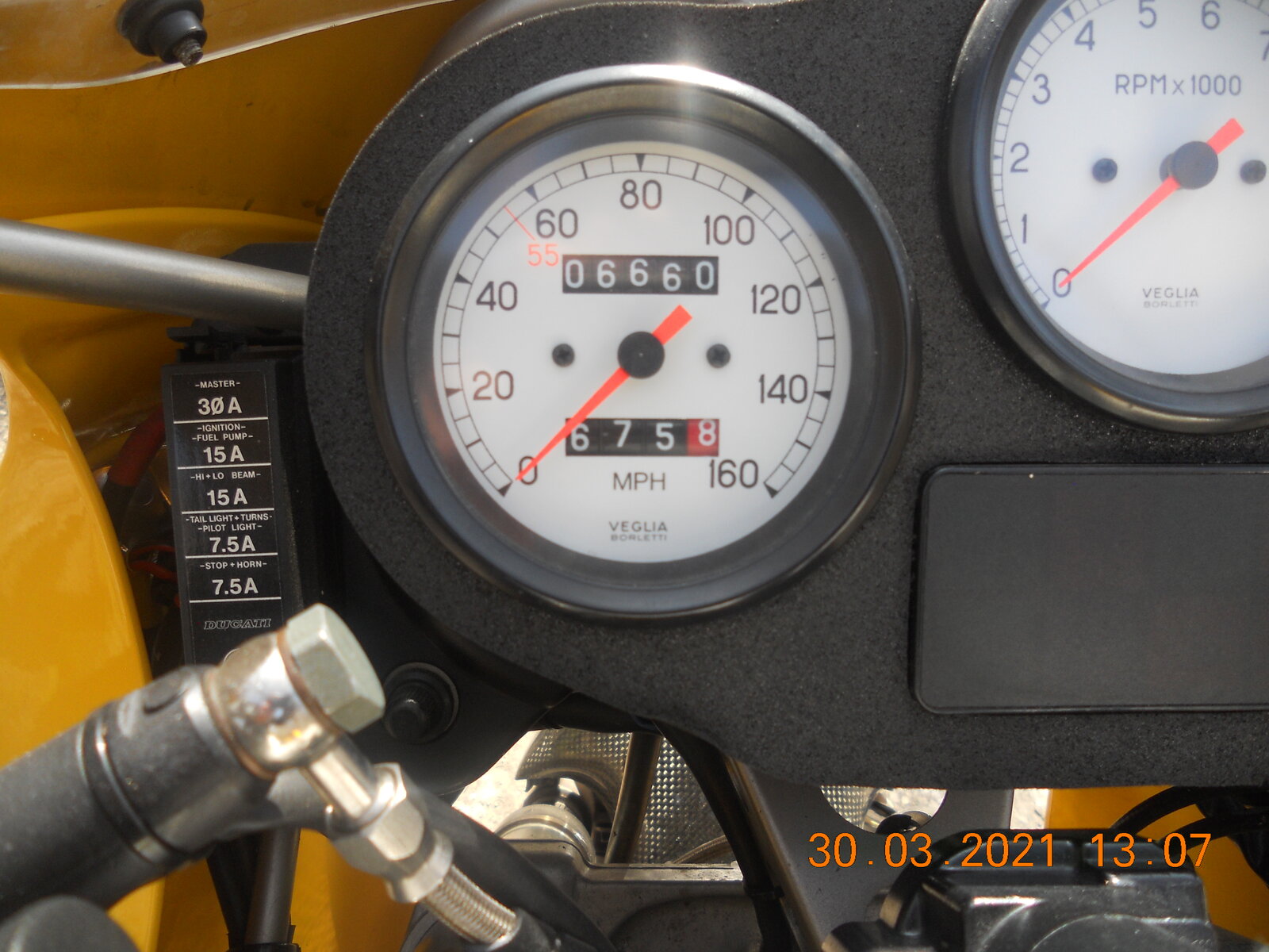

  16. When i place my hand on it...very hot indeed;), i don't have that extra temperature gauge on the 1994 model so who knows.:thinkingface:
  17. That’s strange I’m sure my previous ‘93 ss had one?
    So what does your dash look like then?
    Any photos?
    What tick over have you got when hot?
  18. The engine fluctuates between 1 / 1100 but i'll double check this number.Sorry this's the best i can do at such short notice.
