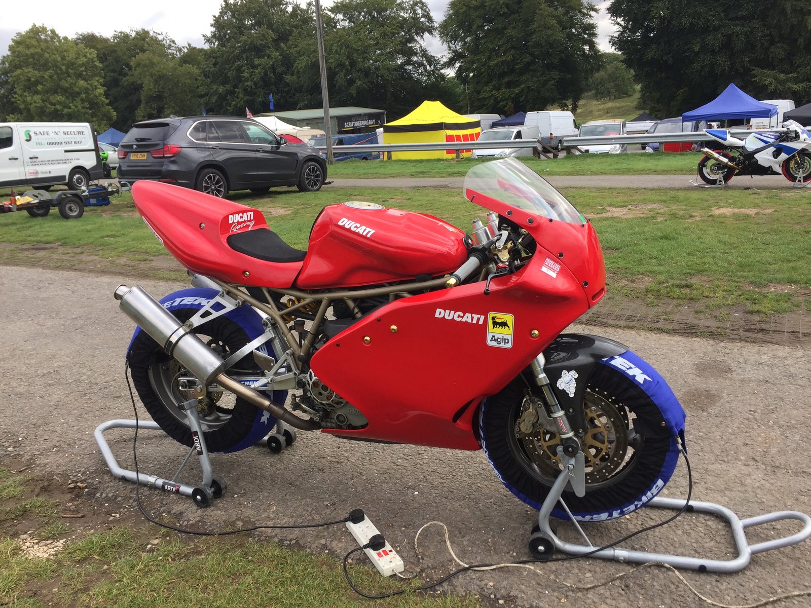

  2. Still looking! By way of a bump, this is the bike it will go on:

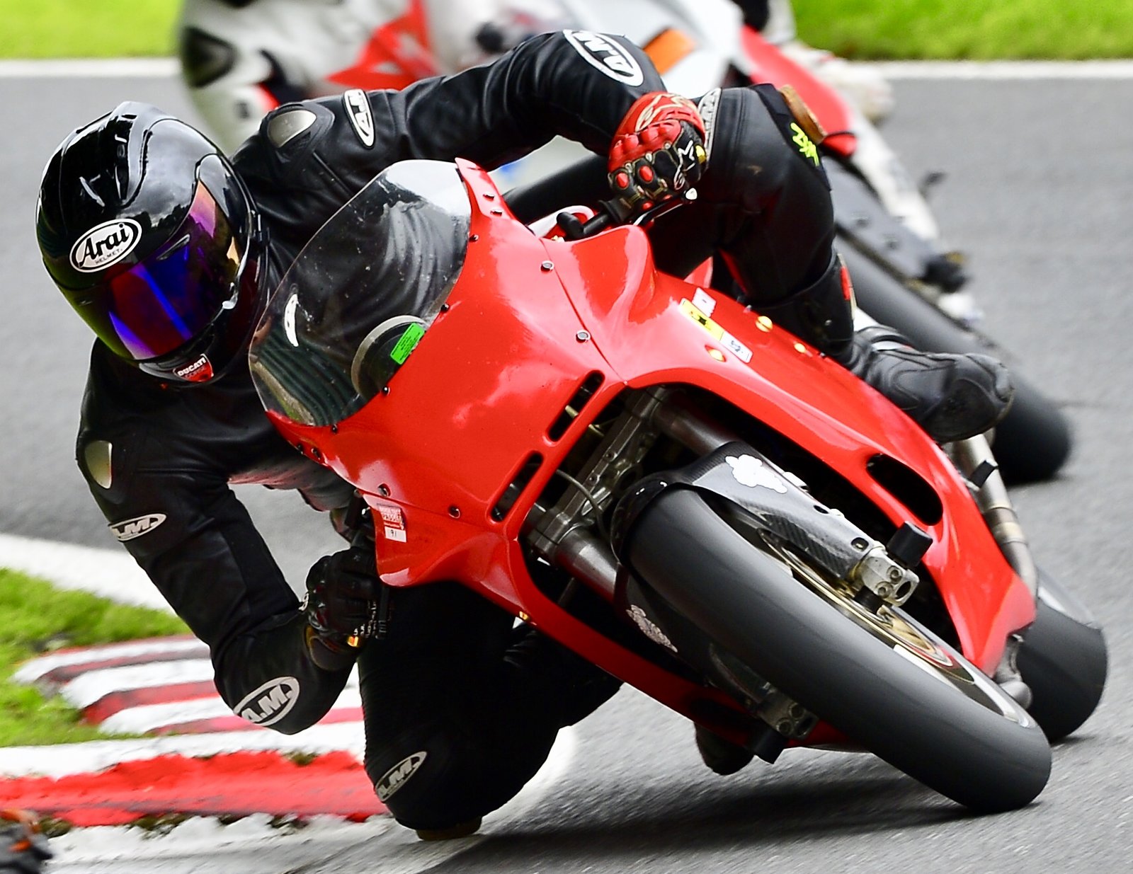

  12. Hi, this one is a 900 SSie so it already has the longer shock.
  13. cunning that you added the far more beautiful carby fairings!
  14. BA36D49B-8E2A-428D-94BC-FC1AA27D5D79.jpeg 8564F53E-8091-4157-B395-019EAFEEC71C.jpeg
    Thanks, yes, I think it turned out ok.
  15. That is one helluva action shot! :upyeah:
