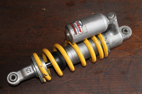

  11. I cannot remember which rear shock is on my ie al
    been a while since I have seen the bike
    I wasn't aware that there was a different bearing between the shocks
    just thought that I would mention about the bearing as it was that which was worn on mine not the top hat bushes or the bolt
    this is a picky of the shock on mine
  12. IMO that is a Showa but I can't tell if it is for a carbed or IE bike.....it looks like the shorter carbed version.
    It is rare for the top hat bushes to wear and the normal cause is bearing wear........just for info, there are O-rings under the top hat bushes that deteriorate which lets crap into the bearings.
    gaz92 found the bearings for the Showas - (there is a thread on this forum somewhere) - but although bearings are shown for the Sach Boge shocks in the Ducati Parts manual, you would be really lucky to find them.
