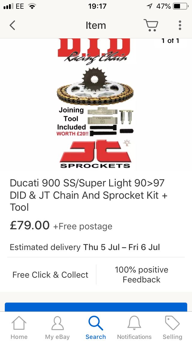

  2. Hi Martin, I’m about to buy a new chain and sprocket set, current set came with the bike and is getting a bit ropey, the advert says “standard sizes” so I’ve messaged them to find out how many teeth, I also need to check what I’ve actually got on the bike at present, it’s probably 15/37 as the gearing is on the tall side, that said I’m rarely in town so I’m happy with it as it is, I’m quite often at motorway speeds (even when not on the motorway:) ) so I don’t want to up the revs in top.
