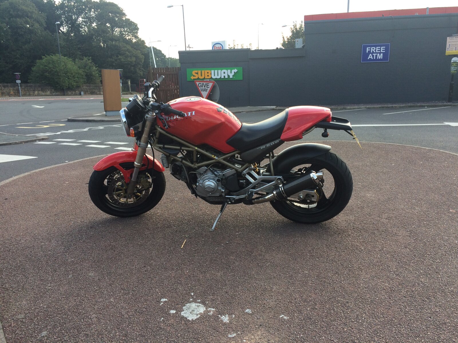

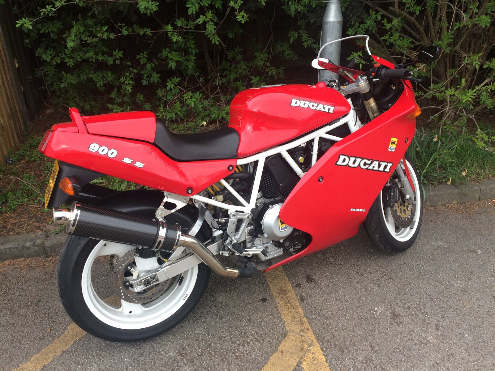

  1. D61EFA8E-7180-491A-BE8D-CDAC16C8D4D8.jpeg 5D890F44-2F34-4D9A-8446-ECB0F806B1DA.jpeg I set my 900ss float heights to 12.5mm , 150 mains, tapered needles, 42.5 pilots, mixture screws 4 turns out, K&N panel filter, Pipewerx carbon cans, all good, runs a treat with nice plug colour.
    I fitted SP Engineering carbon cans to my M900 so decided on the same carb set up, nope!, way too rich, so after much trial and error, carbs off 4 times!, I’ve finally got it right, so for reference it’s the same as the 900ss but float height is 14mm and mixture screws 2.75 turns out, I guess the difference is mainly down to the cans, hope that helps anyone who’s in the process of setting up a non standard Carby
