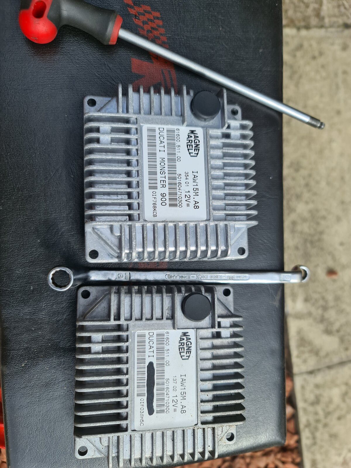

  10. 16291955553065122227389147832767.jpg 16291956047691948111353085550053.jpg
    Looks very similar
  11. That looks like a stock map ECU

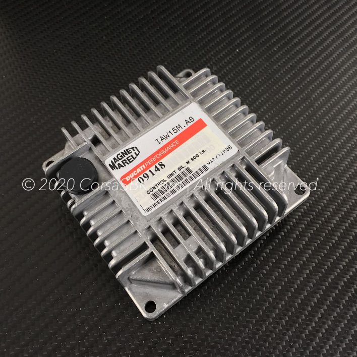

    The DP version looks similar to this
    Their site shows

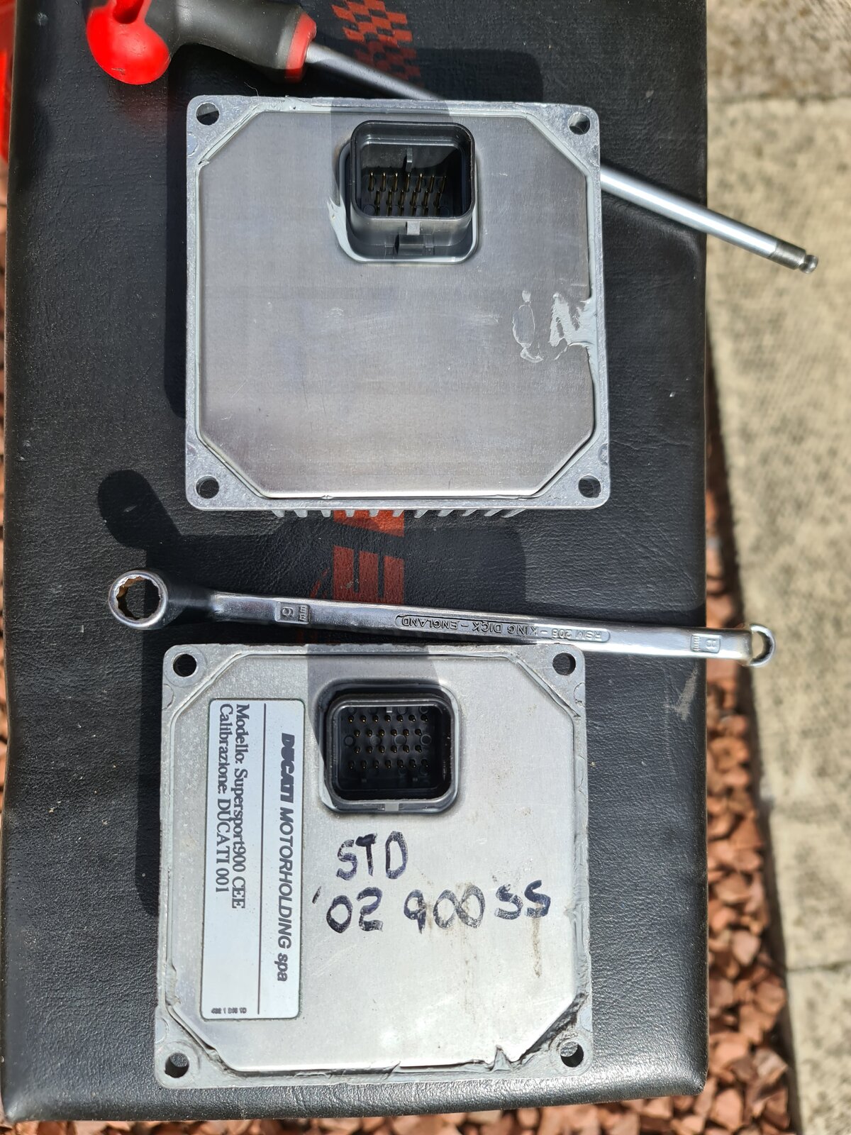

  13. It's not cranking, no fuel pump noise either. tested with original ecu and turns over ok.....
  14. My guess is that is not New/Old Stock but an ECU taken from a customer bike
  15. I hope not, WAH has had success with his so I'm positive. Emailed them to see. It does look mint and came in a box
