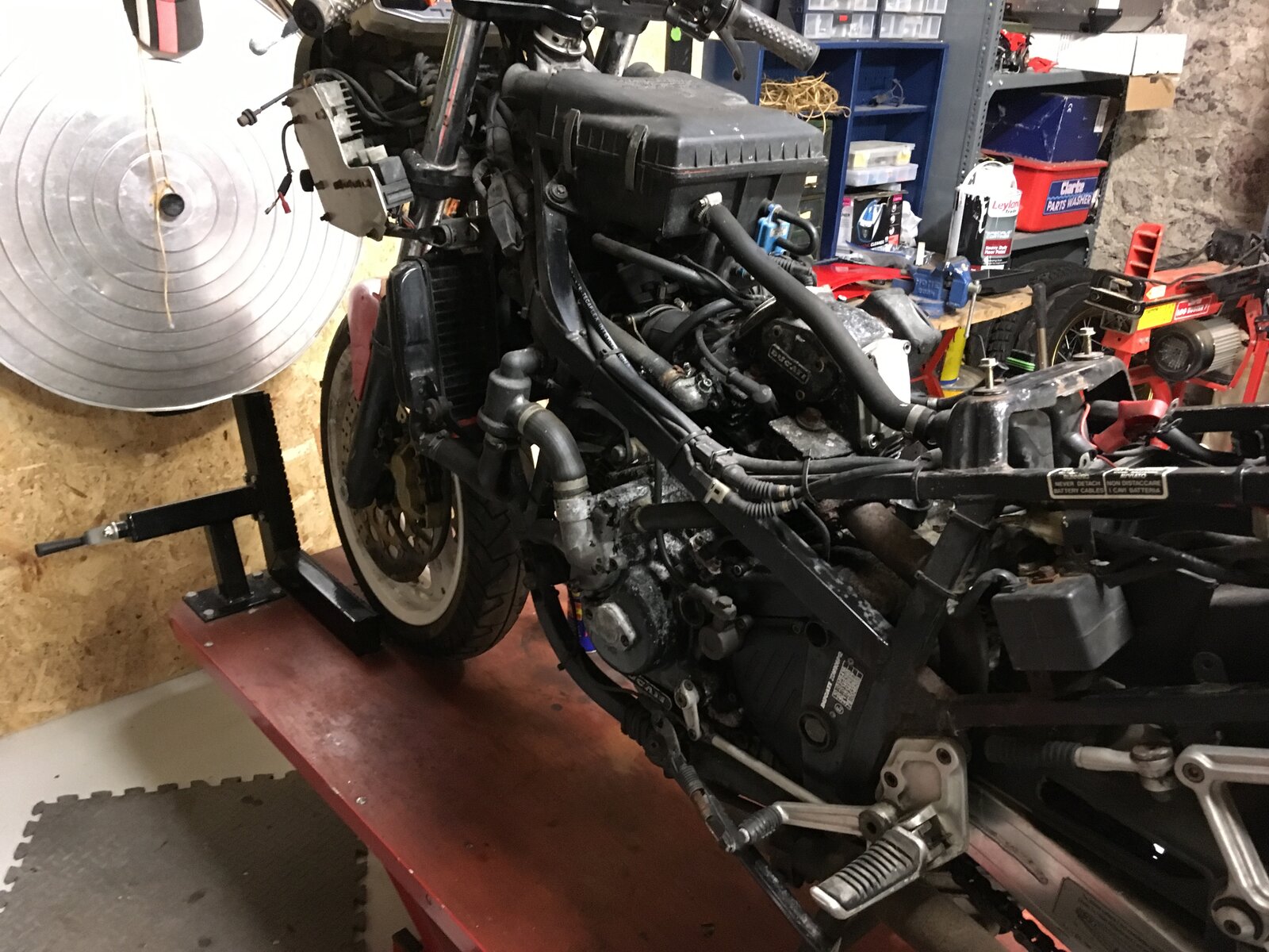

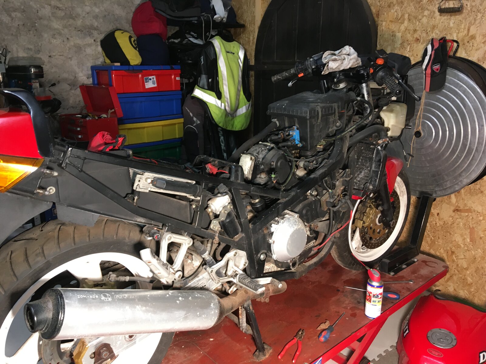

  1. Well, I guess if I'd been sitting in a damp stable since 2005 I wouldn't be looking great either! However, it's on the bench now and all the plastic came off easily thanks to the former owner having copper greased all the fasteners. According to the records it was serviced in 2004 and that looks about right as the air filter looks new. Although the ignition key is correct the tank lock barrel (any idea where I can get another?) is different so I had to take the whole fitting off to drain the tank. Inside of the tank looks ok and as there was lots of fuel its not too sludgy .. will flush it out in due course. Engine paint is peeling off and the casings need a bit of tlc but not too bad. There is a spy ball alarm fitted .. so that will be the first thing to go in the skip. Really good clean up over the next few days and then I'll be able to see exactly what I've got. Absolutely no rush with this project so this thread may be ongoing for a long time! Mike

  5. Connected a battery up today and can report the lights and horn work! SpyBall removed. I think the belts are the next job. Might be a week or two before I get to that though.
  6. Forks off and away to Philpots for grinding/re-chroming and rebuild. Much cleaning and polishing on-going. Belts on the bench, need to order a fuel filter and a new battery. Next up-date in 2020!
  7. I'm excited to see your progress.
  8. Update. Clutch is very worn and a couple of the pressure plates are a little distorted .. so they'll need replaced. Tank has a minor leak (welds) but found someone local who can weld that. Inside the tank is a mess .. crud not rust .. thinking about how to tackle it (I don't want to ruin the original paint work if possible) .. Need to order filters and soak the pump in solvent to clean out the mesh etc. Rubber seals very soft but saveable. Next job belts and compression test I think .. assisted by very capable friend who happens to be a former Ducati technician (it helps!). He is also going to test the electrics .. a real black art as far as I am concerned! Meanwhile trying to source fork slider guides so Philpotts can finish the fork rebuild. All good fun!!
  9. That's the belts on! Tested the fuel pump and it is clogged solid with goo. Filter needs replaced too. I've been looking around and can get a new pump but the filters seem hard to obtain .. so, I've found one, that looks a little different with filter from Merlin Motorsports .. it's is specified as a direct replacement though .. I wonder if anyone has used one of these? Once I can get a pump that works we'll try and fire it up .. a little concerned the injectors will be blocked too but one thing at a time. All thoughts appreciated. Thanks, Mike
