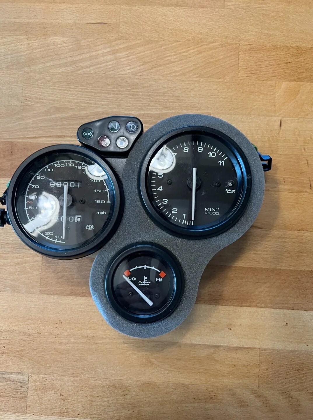

  1. I purchased these clocks recently and in all honesty, I've used the seller before and trusted them implicitly. I wasnt really paying attention to the details but saw they were selling some NOS clocks for a 916 and bought them thinking they'd go well with my project.
    It wasn't until they arrived that I had questions about their identity. Now, before I share my thoughts, without wanting to lead the conversation - what's the consensus on what bike these belong to?
    916 or not a chance?
  2. These are from an injected Supersport (1998 on)
    The tacho is the give away.
    Probably an honest mistake by the seller
  3. They don't look like mine. Right instruments and bracket etc but wrong dials.

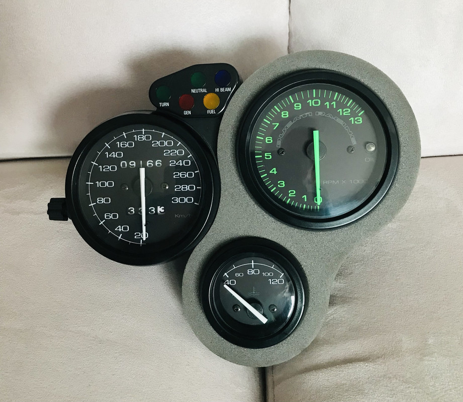

  4. These below are from a 916 (km/h - Celsius version). Many differences as you will see. I agree that those shown above look like SSie clocks.

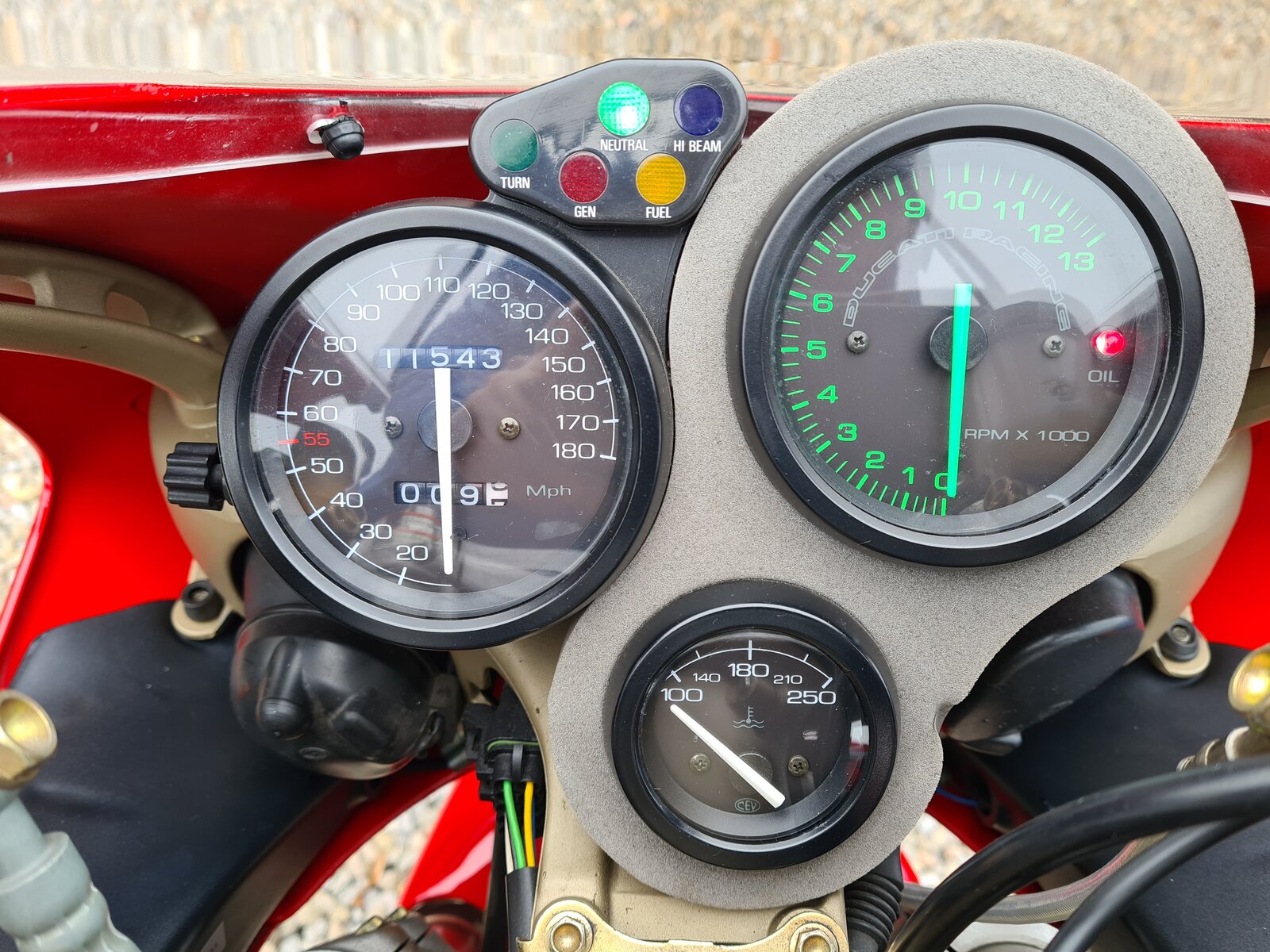

  5. Identical the the clocks on my ssie! :upyeah:
  6. Nope, these are the clocks on my 916 Bip
