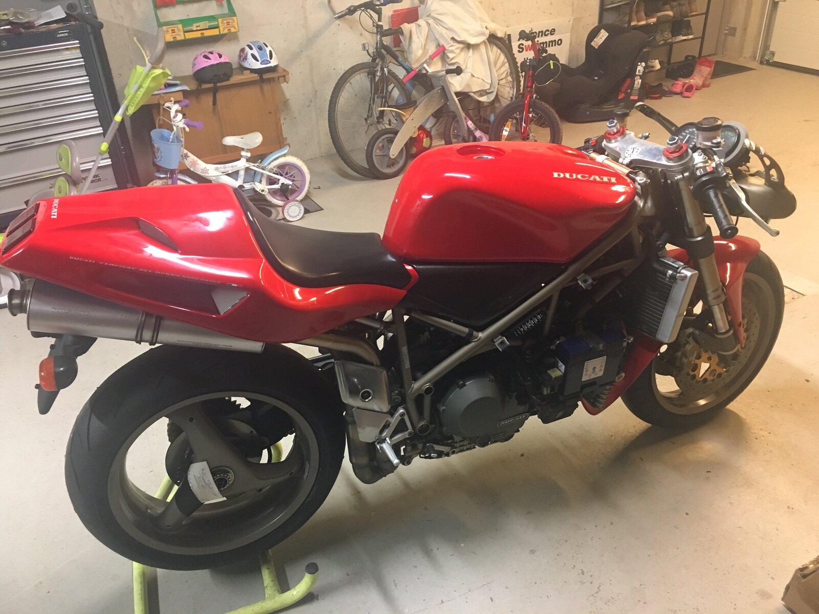

    As said in the presentation, I bought a 94’ 916 which has been stored for 13 years in a workshop, the guy who sold me the bike has started to restore it, but had no more time to end the job. Below how I get the bike :

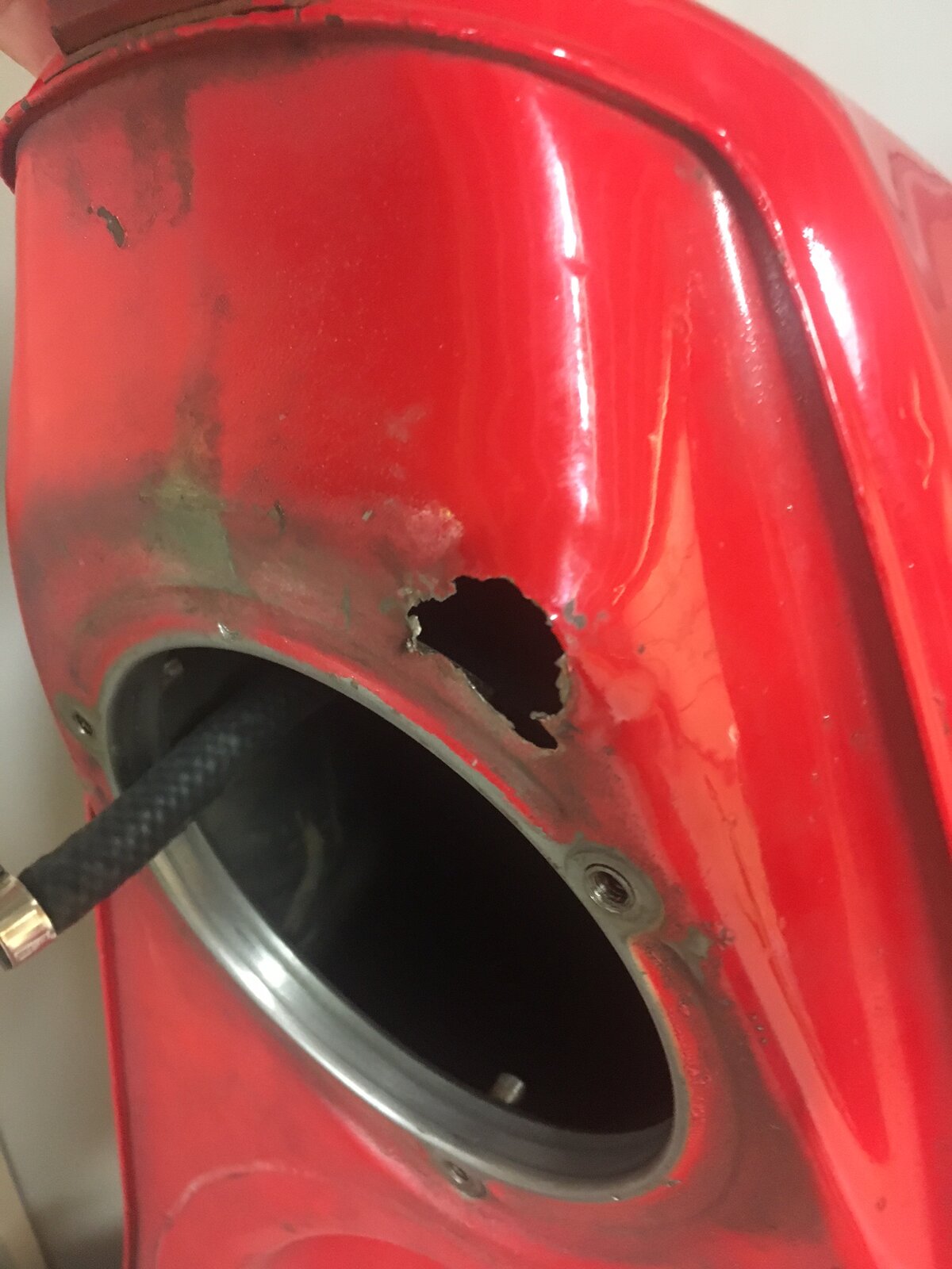

    First job : repair the hole on the tank ... around the drain plug
    I get most of the original parts, only the OEM front fairing is missing... The 916 has already been serviced : oil drain, new tires, brake pads, chain kit, etc ...
    Gilles

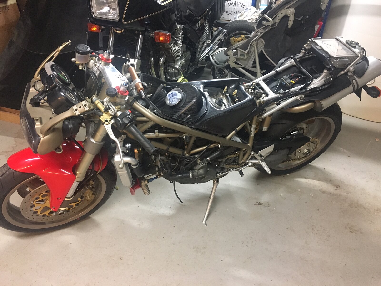

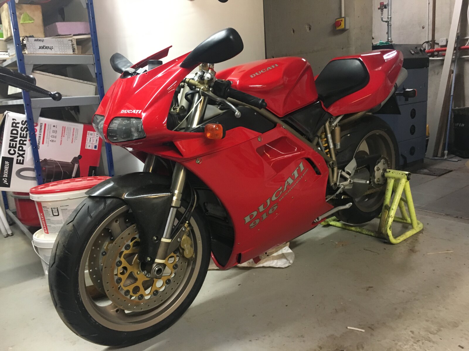

    Some news, I’ve found some parts :
    - MS front mudgard, OEM front fairing which must be repainted
    - Old tank, this one is painted inside in the contrary of mine!
    After re-installing the fuelpump, new air filters and some sealings, I’ve started the engine which run fine! :D
    The carbon airbox I have was made by Carbotech Karl Wagner (Austria), does anybody this manufacturer, it is something original?
    Other question, fairing side panels, have no heatshields, is it normal? Should I add something?
    Thank you
    Gilles
