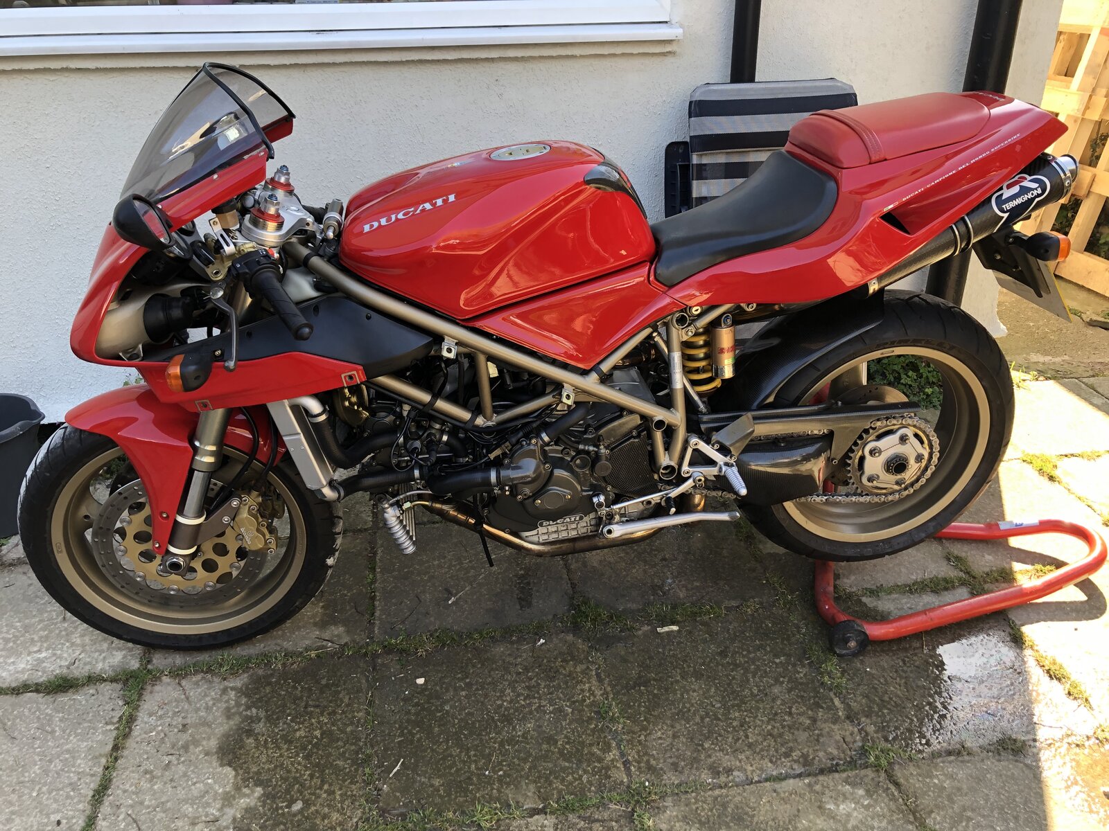

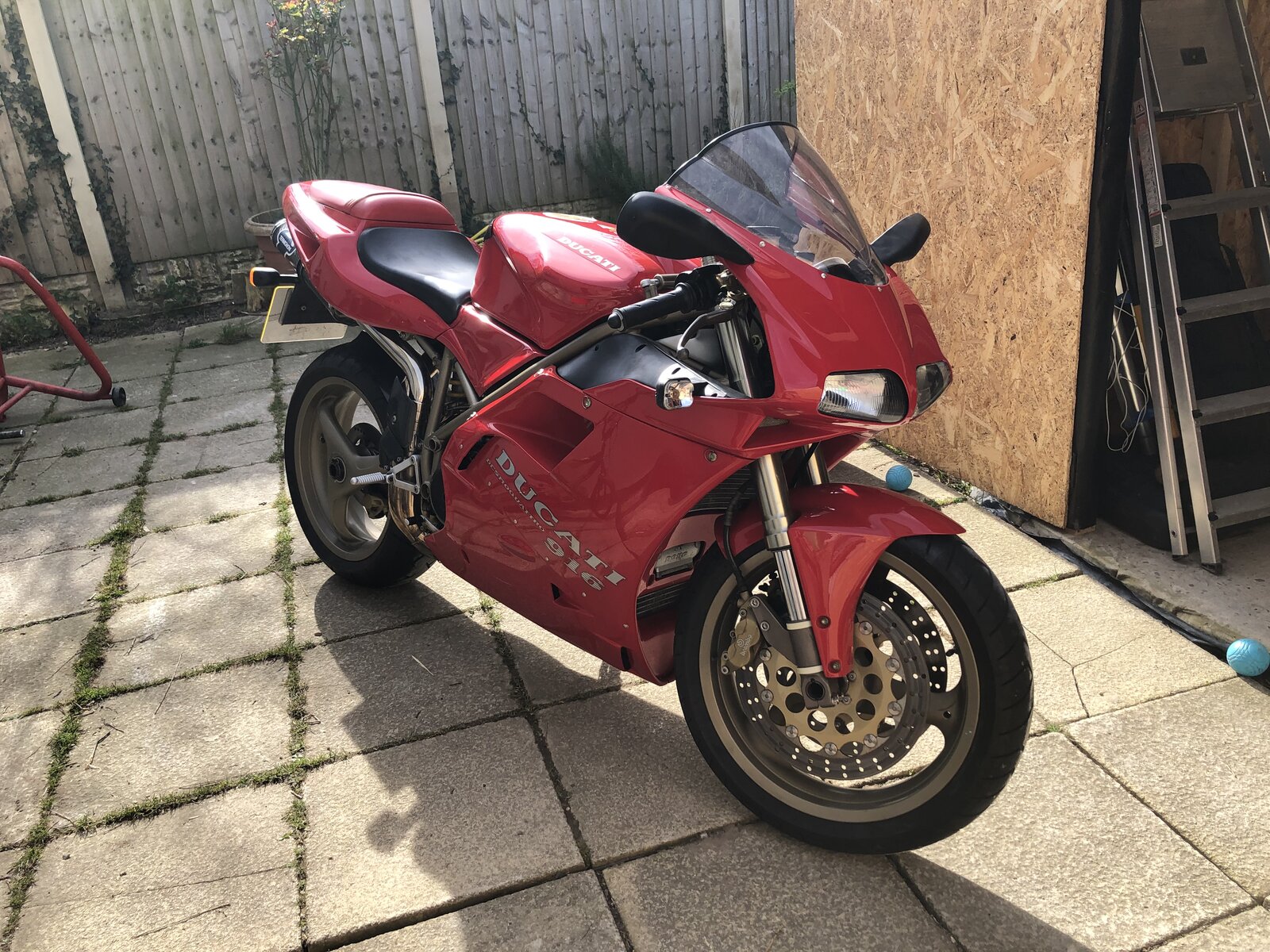

  1. So I bought this 916 earlier this month after being knocked off my bmw r1200gs in January with the proceeds of the insurance payout. As it’s going to be a fair weather toy the plan is to restore it to original and enjoy it on high days and holidays.
    She has been called Dafney by the kids (as all bikes automobiles should be named)
    she is in ‘ok’ condition with some work needed to the paintwork and the left side engine casing has some bubbling from where (I believe it is called) the slave cylinder? Has leaked in the past.
    The paintwork has had an initial fettling but there is much more to come (I detail cars in my spare time as a hobby)

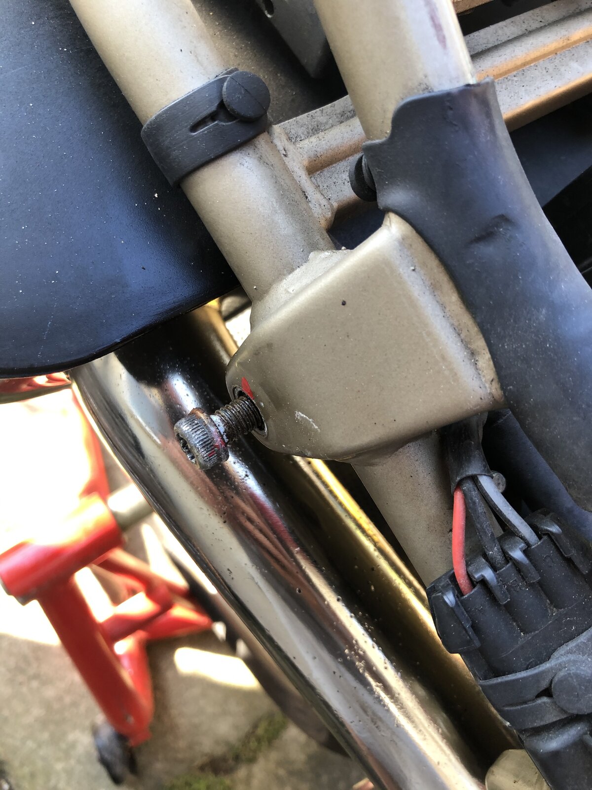

    I am trying to put the pillion pegs back on but one of the bolts is stuck s9lid (the others came out after a bit of persuasion) so any advice is great fully appreciated.
    anyway here are some pictures.

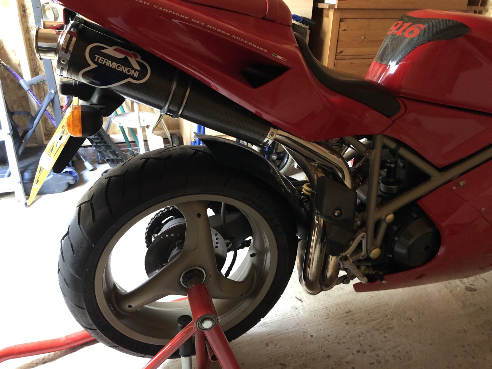

    also what exhaust is this? I know it’s a Termignoni.
    thanks
    Jon

  2. Welcome Dafney. :) :upyeah:
  3. Exhaust looks like 50mm as against the 45mm standard.

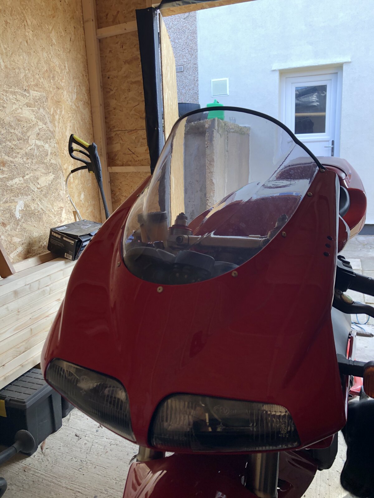

  4. exhaust has the straight through link pipe too, nice :upyeah:
    screen and number board have to go though.o_O
  5. That's in good condition IMO for it's age:upyeah:
    Is it an optical illusion or is the crankcase breather pipe non-standard - appears to be capped off with something:thinkingface:

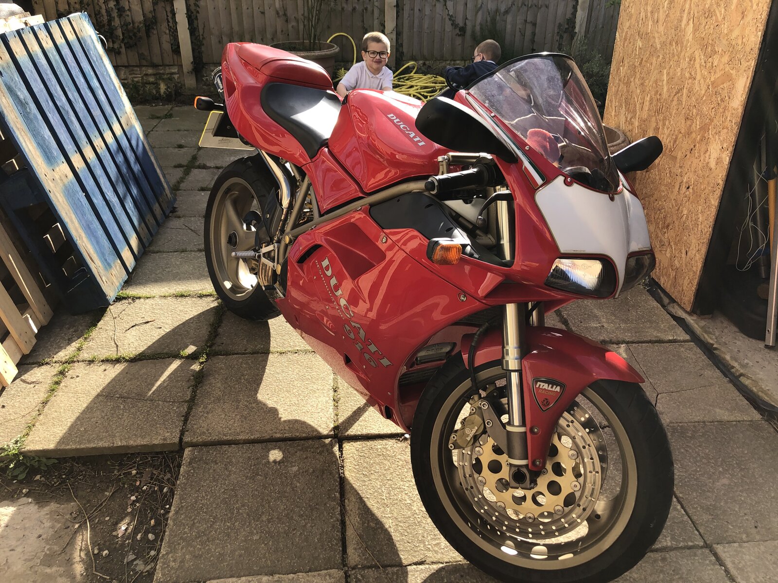

  6. The number board has gone (the pictures haven’t come out in order). She is currently stood in garage with no clothes on!
    here is a picture after the number board was removed
    any tips on removing the one roque bolt as it is stuck tight I have tried copious amounts of gt86.
  7. Mole grips after heat.
  8. First off.....Apply heat, don't use an allen key on it, the head looks way past salvaging. You could use mole grips but if they end up chewing the head to pieces, you will end up with less to purchase on. Another option I have seen before, is to take a nut that's slightly bigger than the head of the bolt, across it's flats and tack weld that onto the bolt head, adding the weld within the centre of the nut obviously, then use a socket and wrench to remove the offending bolt. If you cant get access to a welder, you could grind two flats onto the sides of the bolt head and use a good quality spanner to get the bolt started. Lastly, if all else fails you could cut the head off and drill the bolt out, but that should really be your last resort

    Re the stuck bolt....it looks like you have unscrewed it so far and then it seized up?
  16. Yeh got the other three out with difficulty this one has come so far out and stopped it was difficult to move before hand but is impossible now will have to buy a small blow torch and try again.
  17. Wind it back in and out a few more times,don't place a blow torch on it.
  18. Agree. There will be corroded threads on the inside. Screw it back in, try to clean them up a bit and get some lube on.
