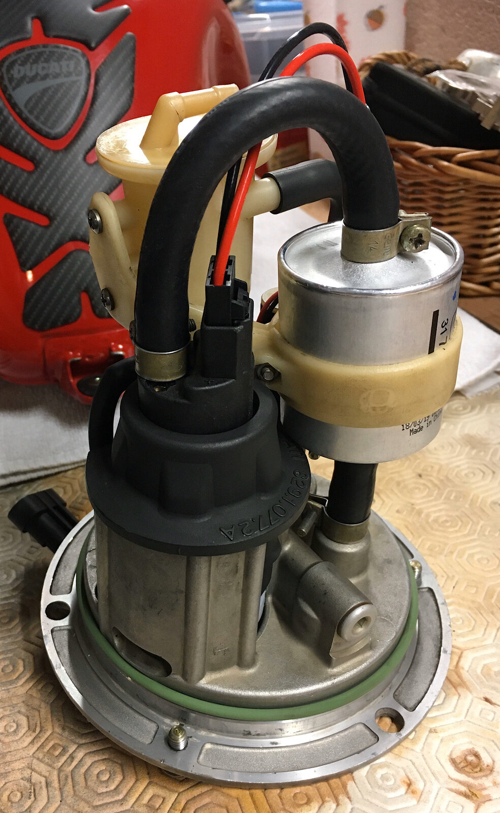

  10. May be you could take the tank off, drain it, remove the fuel pump assembly and check things on the bench. If it was just worked on, it may well be that a fuel line was not put back tight enough and popped under pressure when you first used the bike.
    It may seem obvious, but you need immersible fuel lines in there. Not just random fuel lines.
    Edit: if you go that route, you may need a new fuel plate o-ring (the large green one). They tend to expand and the used one won’t go back in easily.

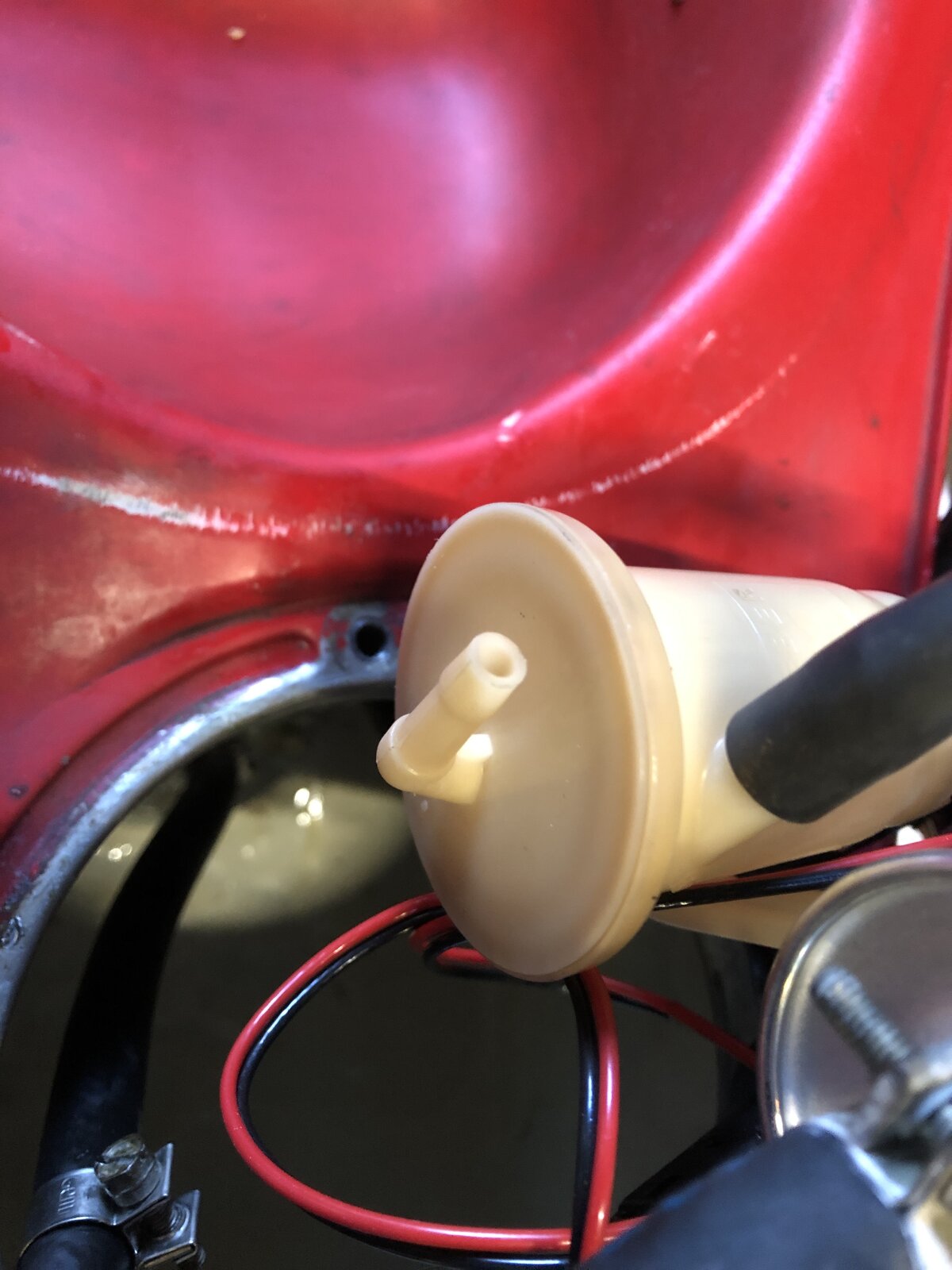

  12. No splits I can see!
    would this little nozzle be the culprit of the jet?

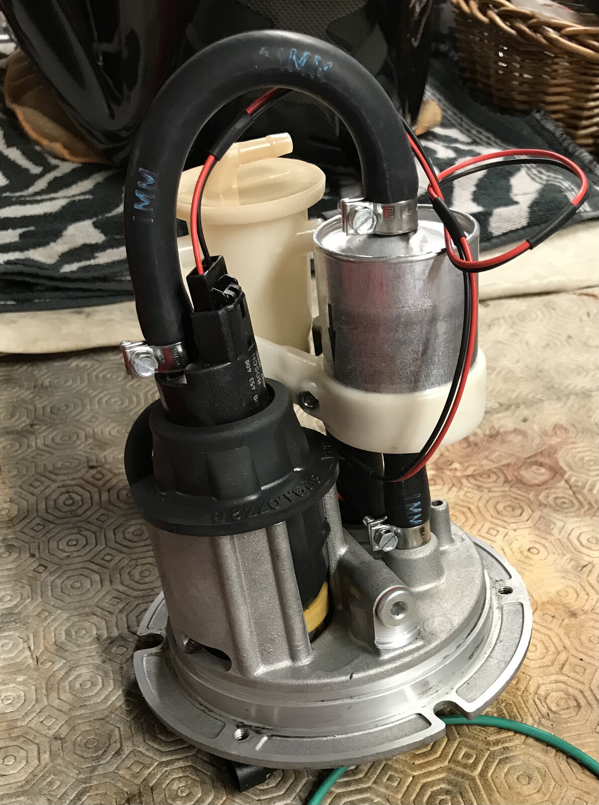

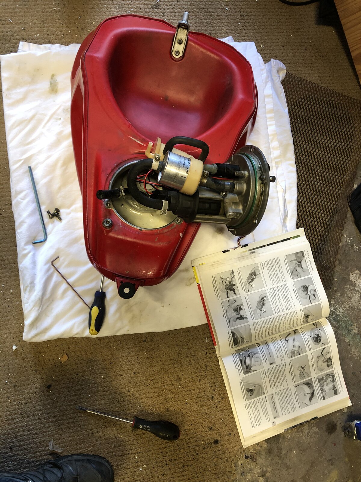

  14. Nope, I don’t think it is. Here are pics of my systems:
    916
    998

    Either one of the two hoses or the air separator nozzle thing. But that just shoots petrol out at 90° to the pump housing. If it’s really as bad as the OP says, I reckon it has to be a split line.
  17. ah, that's maybe it - i've never seen the air separator thing "squirt"? - so not that then? yes, can remember the fault with the hoses as affects italian cars also going back to around 1982.
  18. It could be if the OP meant it was shooting petrol inside the tank and not upwards...
