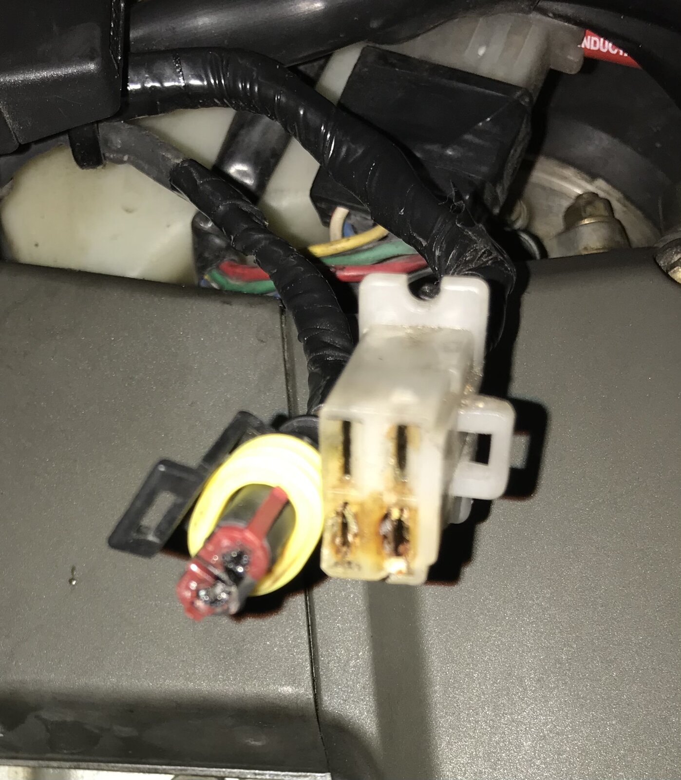

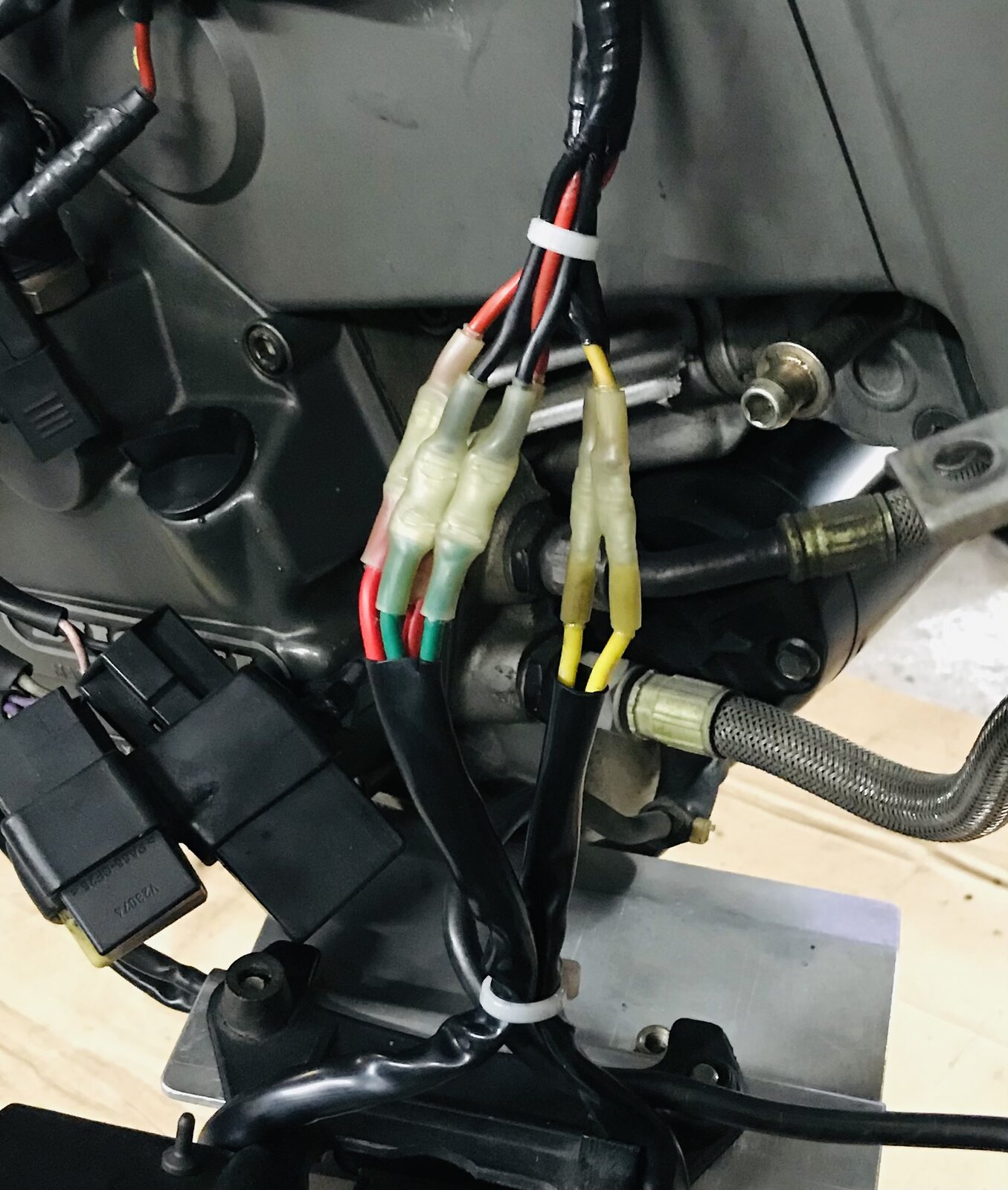

  4. When you replace your battery & Reg/rect, which you shall be, look for the mosfet one. Solder the two yellow leads from stator to RR. Dont use connectors. See guillaumes pics above. Keep the 916 on a trickle charger always. My single phase 916 eats batteries and RRs but none since I started keeping it on tender full time. It’s just one of those things with a 916. :)

  5. Also if you can, replace the two yellow wires from stator with thicker core.

  9. As posted many times on here, it's a real priority to check your alternator and regulator loom runs and connectors for overheating and melting before you use the bike again. If it is the regulator failing and/or high resistance in connectors/leads then you've been lucky, particularly at this time of year in the U.K.

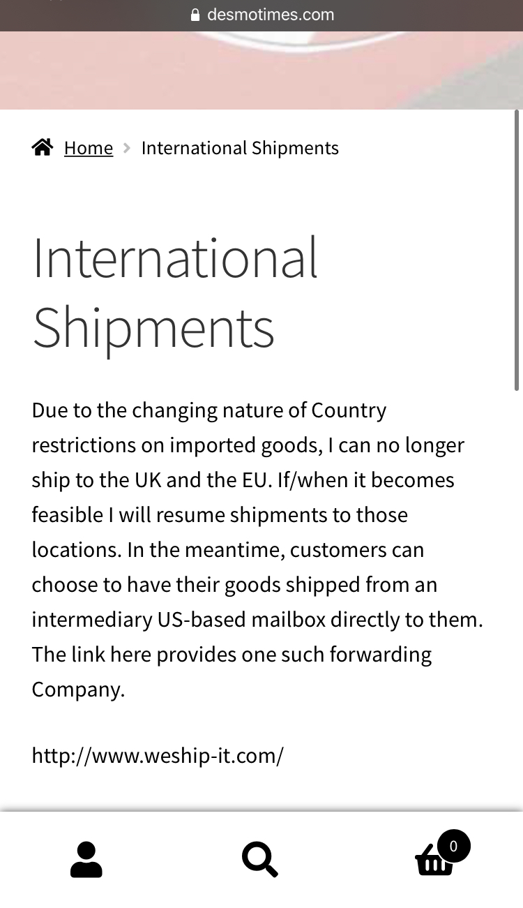

  12. no shipment to UK EU
    https://desmotimes.com/shipping-faq/

  14. The figure I arrived at was based on the FedEx charges as used by the US mailbox company on a 1lb package. Part of the reason he no longer ships to the EU & UK is the VAT processing. Its all on him to process and send to the respective revenue authorities and he feels that the governments are ripping us off enough and he wont support that.

  18. Folks, the yellow wires are AC and in particular the three wire 520 watt system provides a three phase AC supply up to 90 or so volts, the current in those wires is no where near 30 and 40 amps as suggested as that ignores AC and 3 phase supply theory (although the current on the DC side of the regulator could be that high). If you replace the stator wires, use appropriately rated ones with correct heat and oil resistive insulation. The reason why the yellow wires are the size they are (on both Shindenghen and alternative systems like Electrex) is because they are of adequate capacity for the designed AC load. The wires break down and burn when that load is exceeded during a fault condition. That fault condition is usually down to the resistance presented by dirty or corroding connectors or a related load imbalance on the AC wires.
