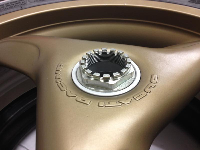

    On the rear the tapered spacer now protrudes from the wheel by approx 5mm. The castlellated nut still aligns with the holes in the axle so i presume all is well. The standard 3 spoke is counterbored slightly so the spacer sits flush. Can anyone confirm if I can use the 916 spacer with the 5 spoke rear?

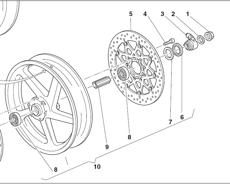

    2. I want to replace the bearings but how do I remove the speedo drive without damaging it?

  2. Remover the powder coat, and and give the coaters a bit of advice to not do it again (if you know them). The bearing spacer will push across around 4-5mm to allow access to the rear of the bearing. The spacer can be a pain to move if the bearing are pushed in hard against the spacer. Not usre on your rear wheel, looks ok though.

  4. If i remember correctly (not used a speedo drive for a few years now) it is just sat behind the seal. Pop seal out, drive washer pops out too.
  5. Ahh, ok looks like the powder coaters coated the seal too, it looks and sounds like part of the rim but could well be the seal covered in pc. I presume that seal comes with bearings?
  6. the seal is just an oil seal, the bearing sits behind it with its own seal - as in a as seal bearing seal,

  8. The rear wheel spacer is fine, I also have around 4-5mm protruding with my Marchesini 10-spoke wheel but, as you say it will sit flush in the original s-spoke.
    Speedo drive just pulls out, IIRC there is a seal which sits on top and so needs to be removed to get the drive out.

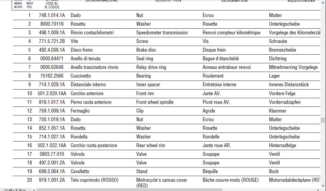

  11. This might be a bit late but if not it may help. As I remember there is a wire type seal that holds in the front speedo ring. I have replaced one of these once and it's an easy enough job.
