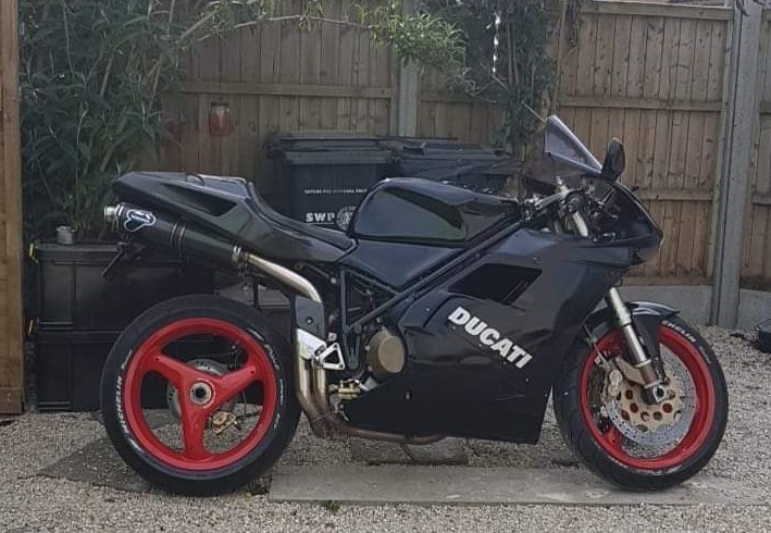

    My 1997 916 on it last run ( Fb) bogged at 7k, like a rev limit, bonced around a lot to.
    Work done todate
    coils, fuel pump and filter, cleaned tbag. New battery, Wiring sorted, charges all ok.
    Then sent to Ducati
    Fuel presure checked all ok at low and at 7k revs
    Coils, fuel lines, injectores checked
    test chip inserted - OK, no difference
    ECu swapped, no difference
    Crank sensor inspected and wiring checked.
    300 quid bill :( No fix
    What next ?

  3. Maybe :) gonna chnage TPS, Crank, Air sensors, plug leads and plugs. See where we go :)
  4. Air sensor and TPS would have been checked at Ducati, presumably they ran diagnostics on it?
    I would change the crank sensor with a known good one before changing TPS, plugs leads etc, is it missing on both at 7K or one only?
  5. All seems fine there- fuel pressure test on the dyno :)
