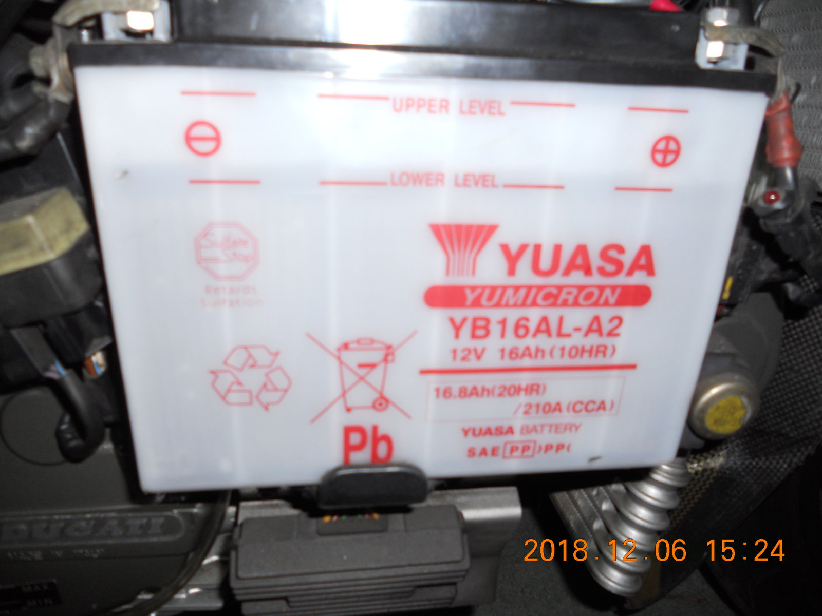

  6. On the SPS and yes i need to top up the acid by the looks of things.:eek: DSCN5218[1].JPG
