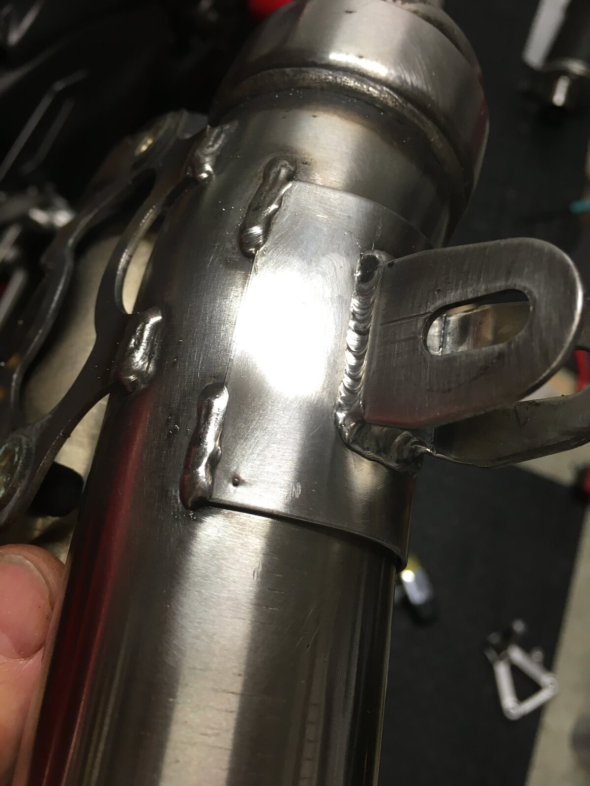

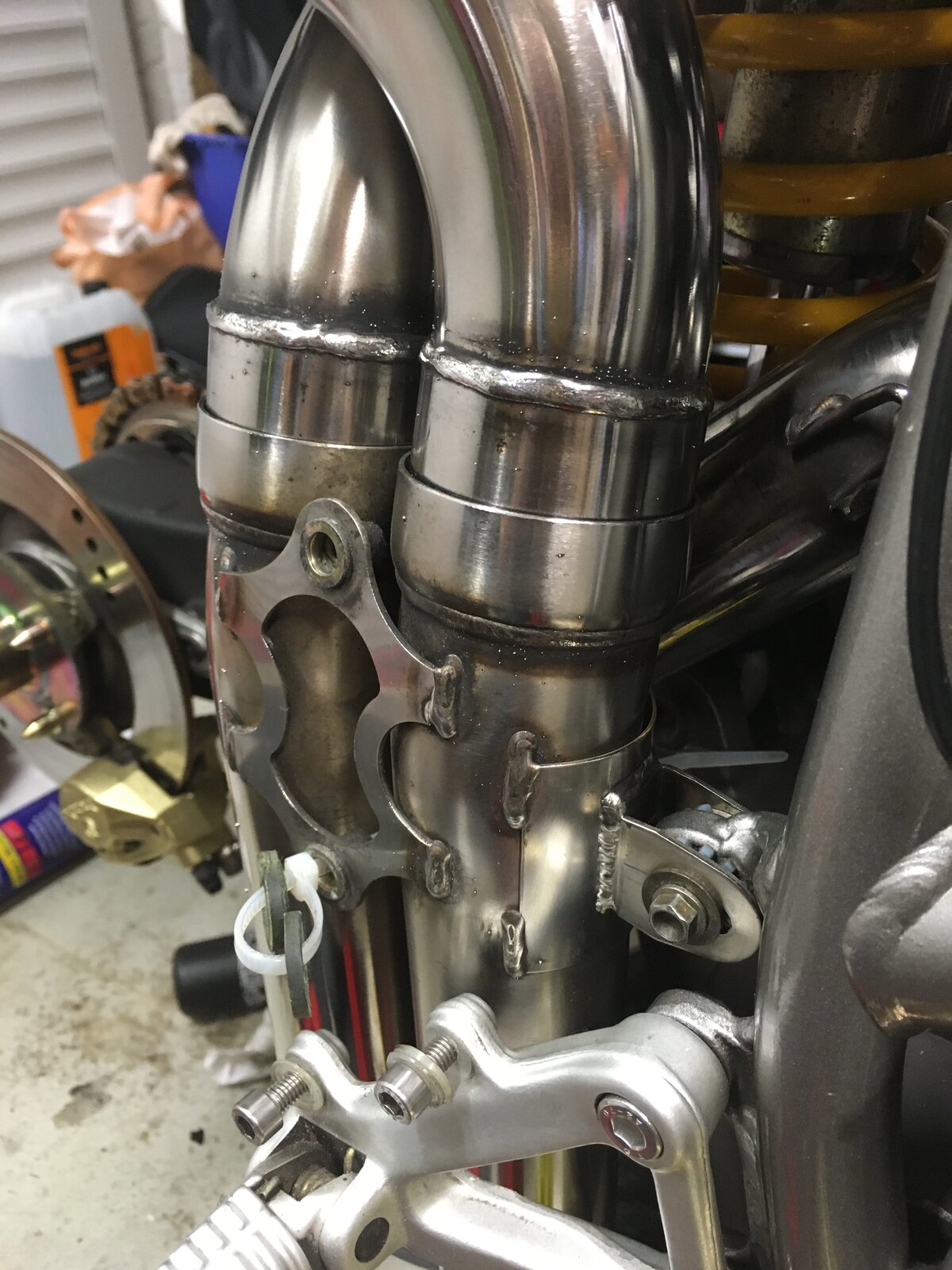

  12. The Mounting Brackets on the vertical twin link section are prone to cracking, I have had to have 2 welded in the past, so it might be an idea to slacken the bolts off on that section in case they are not perfectly aligned, fit the tail cans into their correct position, then see if the brackets on the link section need sorting out.

  14. Hi & welcome. You will easily sort this when you get the bike home. Good advice re mid section brackets. I had to have the upper one on my bike welded last month.

    And yes, I too have a broken upper bracket on the mid-pipe...
  16. F8C48A1F-DEEA-4919-BCC7-A5DA490F4625.jpeg A494C722-C4DD-4476-9ECB-89329459CDD7.jpeg Here’s mine welded up. TIG weld as stainless.
  17. That’s as it left the factory as far as I know.
