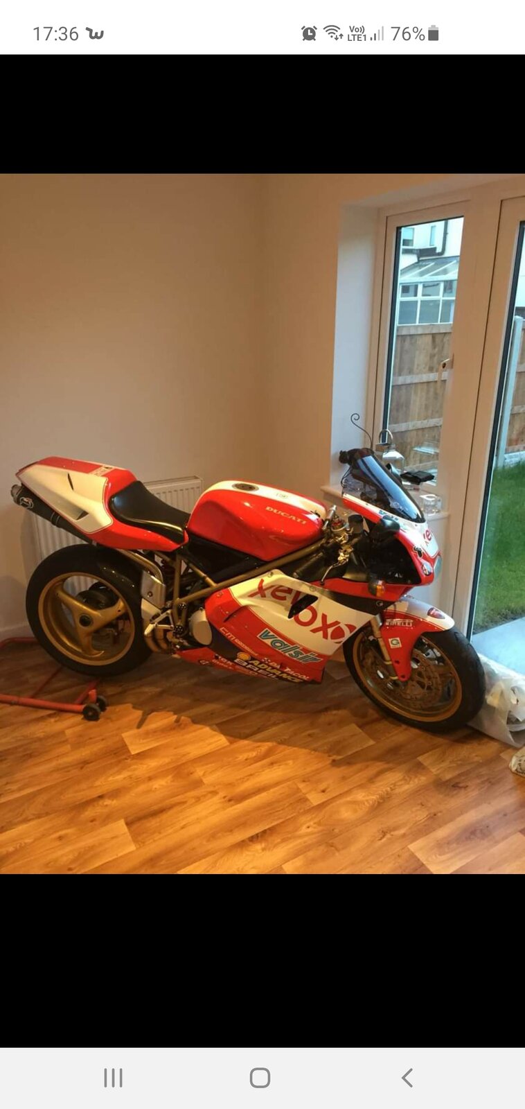

  1. Hi, I've been looking for a nice 916 for a while, ideally wanting a good condition original 94.
    prices are crazy but I've found one- i think.
    they claim its a 1994 but I haven't seen proof of this. Its got custom decals/paint..its not got the original screen.
    The wheels have been sprayed adifferent t colour so will need to be refurbished.
    it has had a service about 9 months ago and been inspected by a ducati specialist. but I've not seen the report. ( claims the bike is very clean and never been dropped)
    termi cans.
    15k miles
    I can see other 94 bikes, in the £8-12k range, but they seem to be alot more original.
    so, what would you put an approx value on it?
    how much could it cost to put it back to original?
    what questions could I ask the owner?
    Thanks for the help.
  2. Pictures would help?
  3. My gut reaction is to walk away. Ducati Italy will confirm age from the VIN and engine number but that won’t guarantee the panels are original. The date stamp on the plastic will give you reassurance that the panels are from the period but nothing more. Owners do sometimes customise their bikes with a different paint job and decals but I have to ask why they did it because a common answer is that the bike had been dropped. The final sentence in your first post sums it up, I you want an original bike you are going to have to pay for it. A non original bike will just end up a money pit putting right. It’s an old adage but if it looks too good to be true, it most probably isn’t. I’m sure not the advice you were hoping for but caveat emptor. Andy

  8. It has a biposta rear subframe so more likely it is not the Strada it purports to be and the wheels look later than ‘94. To the purist or collector and if you are looking to retain value during your ownership, IMO, absolutely yes. Andy
  9. OK so making this back into an original 94 is gunna be hard to impossible,
    so I know how much a good paint job and original decals would cost, and how much wheel powder coating is, this would get it to looking like an original. what value would you put on the bike pictured. if I can get it cheap enough then I'm happy its not a complete original 94. and will still look good in the house.
    thanks
  10. Just looked on eBay and had to wipe my eyes I was crying with laughter at the number of dreamers :joy: Purely my opinion mind, a non totally original, early 916 with good history is going to be worth £5k maybe £6k, not the £8k and £9k people think their late 916’s are worth. For the one in your picture which I now notice has no tail tidy or rear indicators and if it is registered as a biposta, it will need pillion foot pegs and hangers for the MoT, £2.5k. Andy
