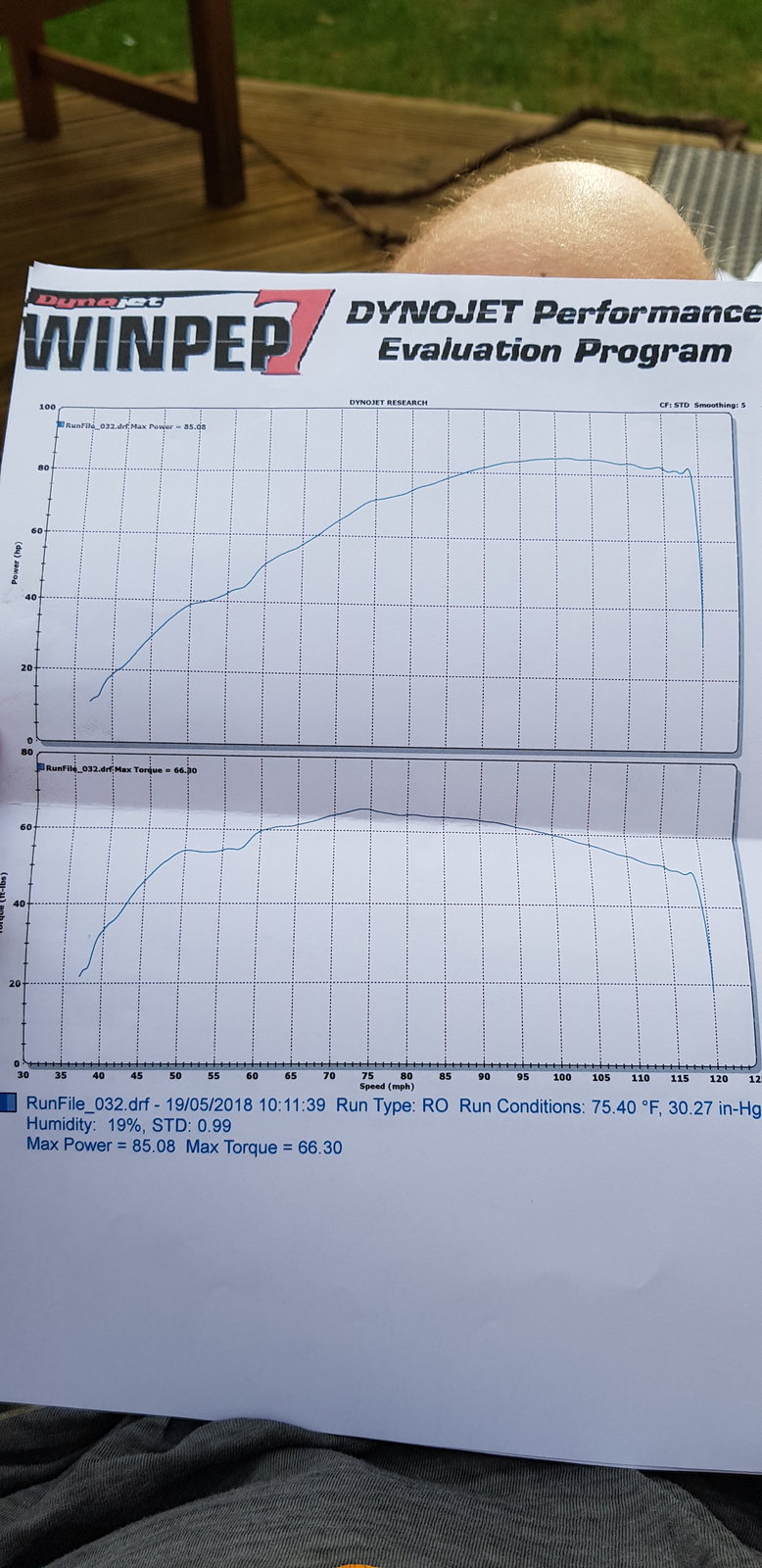

  8. This is my Dyno printout, I have 41mm flatslides, 904 hi comps, Ignitech, full Sil system, lightened flywheel. This is at the back wheel so consider about a 10 percent drop in the drivetrain. I havent called my insurance company to tell them exactly what the horsepower is sincw I got this done. I am with Bikesure
