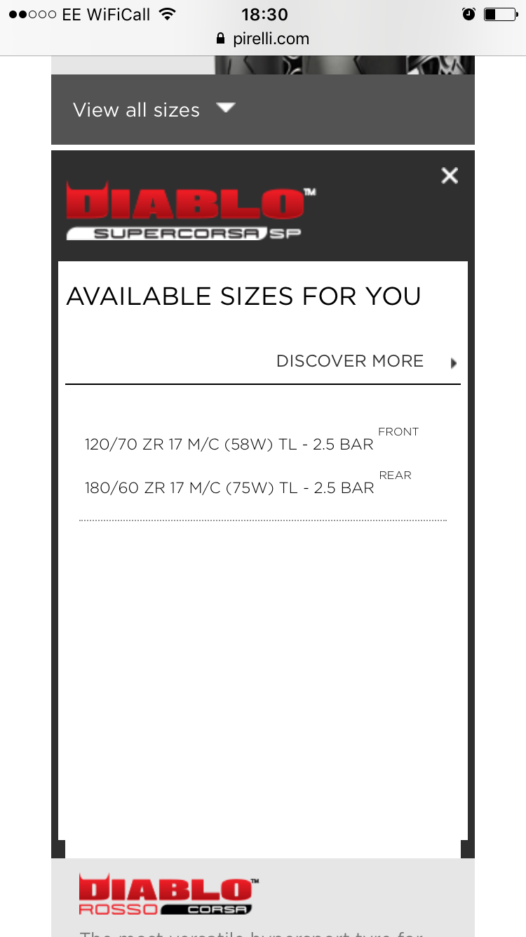

    If you select your bike on the Pirelli website it gives you this info. 2.5 bar is 36 psi. I've always run this and never had a problem. 33f 30r for track days.

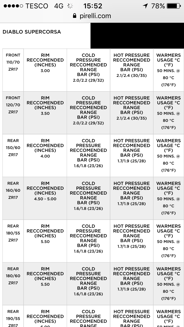

    One I went on says 2.3 in the front
